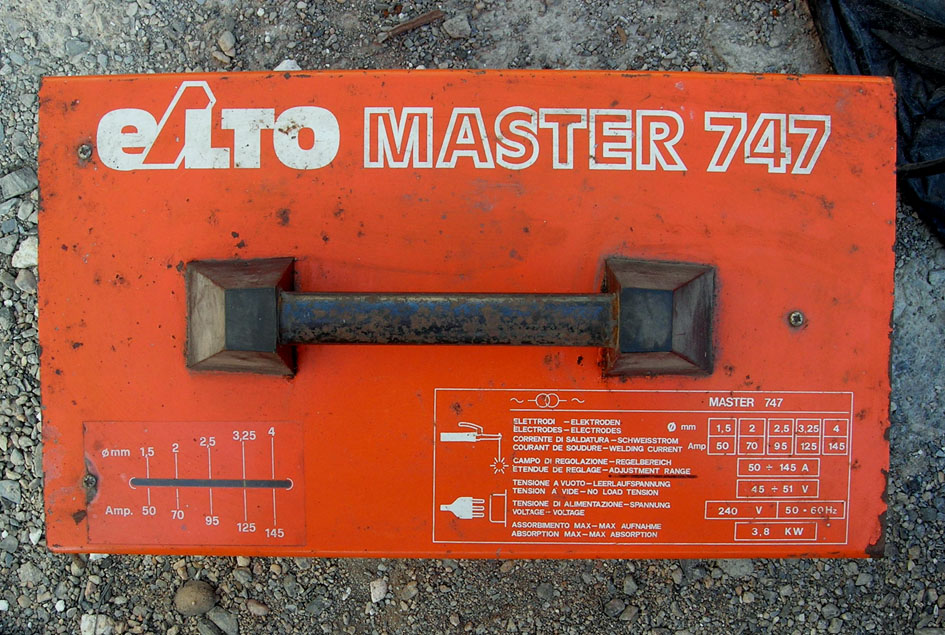

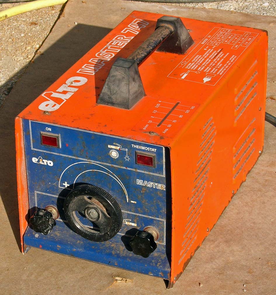

I have recently acquired the above arc welder but can find absolutely no reference to it on the net (and very little about Elto). Can anyone give me any information about it please?

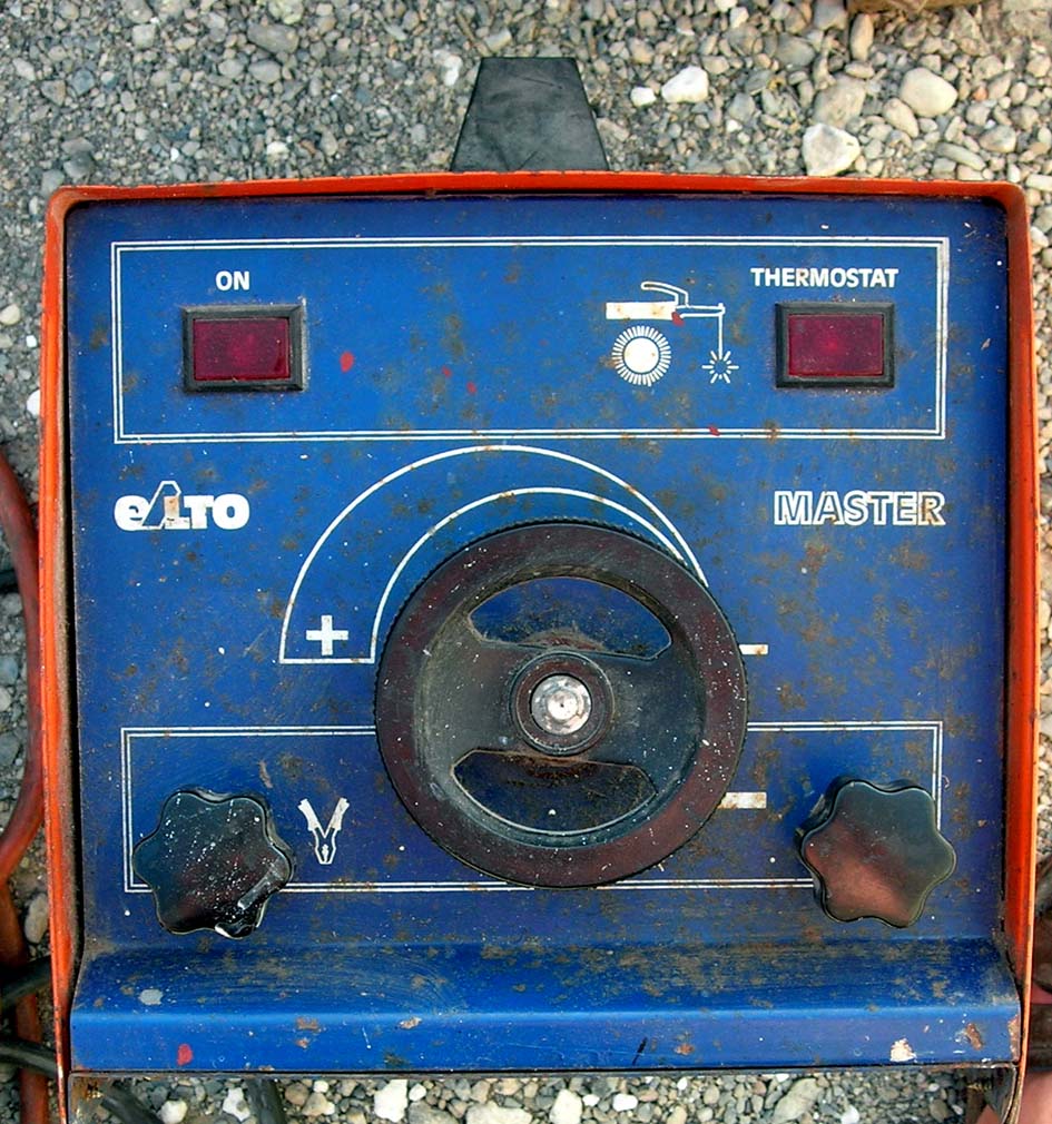

It's a typical "Buzz Box", ie AC stick welder. Left hand terminal is the "earth" (connect to workpiece) and the right hand terminal to the electrode holder. The knob sets the welding current (clockwise to reduce), the output current and suggested rod diameter is displayed on the scale on the top of the machine.
The LH lamp indicates that power is switched on, the RH when the unit cuts out due to high transformer temperature. If this happens, switch off and have a cup of tea while it cools down.

To me, the amp markings on it seem quite high for the suggested rod size. For example, 95A shown as 2.5mm would be low 3.2mm for me. I would run 2.5mm rods at 70-80A.
