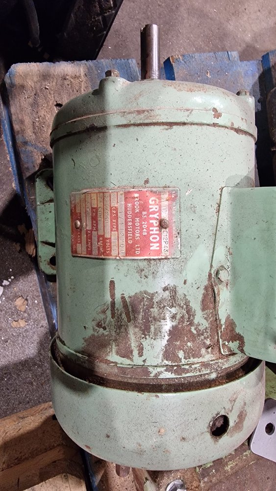

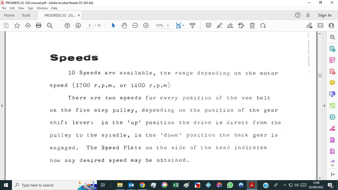

Do you know the RPM and HP or wattage?I've just checked the manual. Hoover or Brooks motors were offered.
Mine has the wrong motor.Four pole (1400ish rpm) and 3/4 hp. Should say on the speed plate
Motor fitted varied, but the one fitted are generally found to be either a 0.5 h.p. 1425 r.p.m. 3-phase or a 3/4 h.p. 1-phase - though the odd one with a 2-speed 3-phase motor has been found.
Thanks for that.From Lathes.co.uk
I think I may swap the motors over. I have a Progress 1 which is original 3 phase. I will keep the 2GS and sell the other one with a 240V motor on it.I'd definitely go for 3 phase and a VFD if you can.
