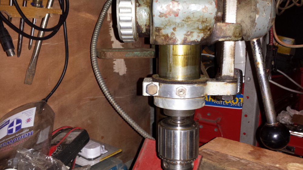

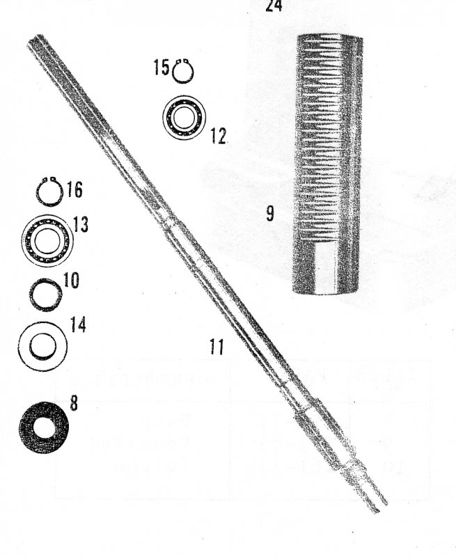

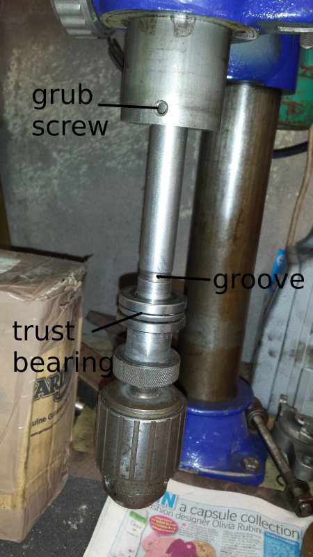

Please, I have a similar No. 1 Elliott (090566 618), but I cannot get my head around it at all :-(
Electrically it is fine. But when I drill a hole, the bit gets stuck in the work. The column moves back up OK, but it leaves the chuck and shaft behind.
I understand that the chuck and its shaft has to rotate within the column, but I do not understant how the column drags the shaft upwards. On my machine the trust bearing seems happy to sit just inside the colum. Is it held there by the grub screw? That doesn't seem quite right.
What is the function of the grove? I bought the drill on Ebay a few years ago, but I am only getting round to sorting it out now. I can't help but feel that there is something missing.
Any advice?
