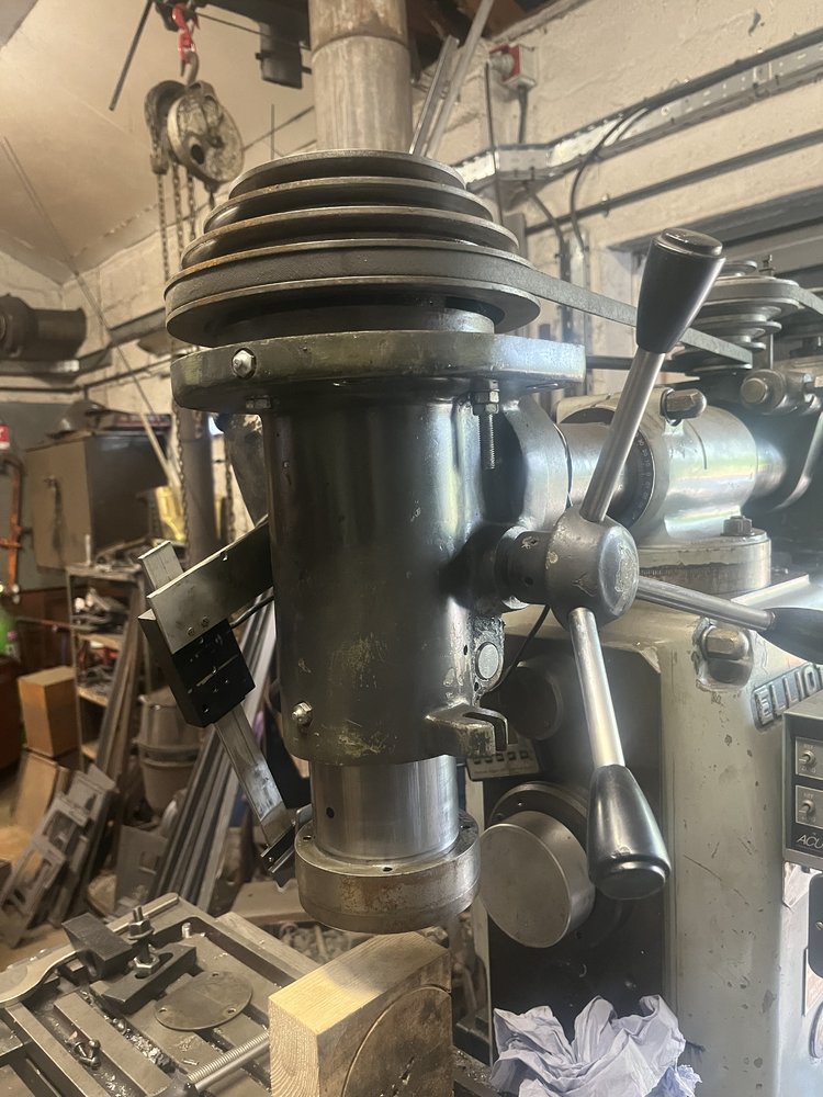

I was drilling brass and it snagged and I subsequently lost drive (pulley continued to rotate but spindle stopped)
I don’t have a manual but having read post here I expected to be able to release the clock spring and dropped the quill out. That didn’t work.
I had to remove 3 bolts on the head and withdraw the pulley with part of the casting from above

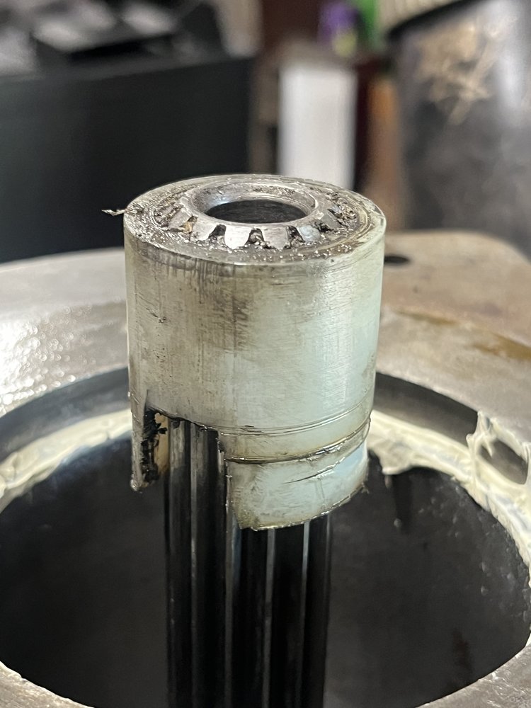

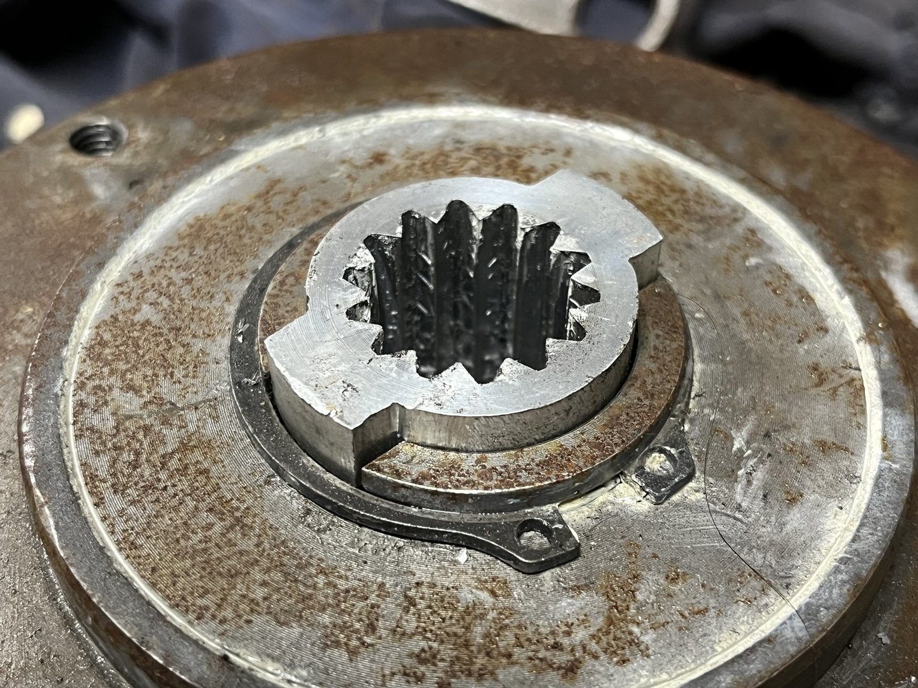

The revealed not the parallel shaft with long key in I’ve seen on other machines but a splined shaft
On the top of this is a plastic sleeve that has (had) two keys set into it held captive on the pulley.
It looks like when the drill snagged the keys mangled the plastic sleeve so must be acting as a shear pin type arrangement
Anyone seen this before? What can I do as a replacement?
it’s a pretty annoying feature as I wasn’t taking a big cut so can I just engineer a way of getting rid of this feature? Surely if there’s a big smash up the belt will just slip? I really don’t want to be changing this plastic things everytime I drill a big hole
