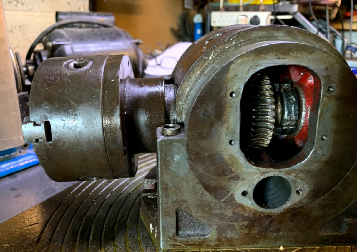

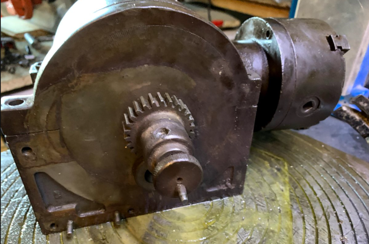

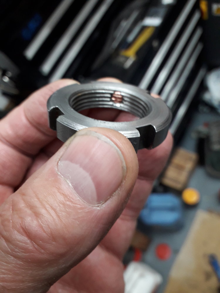

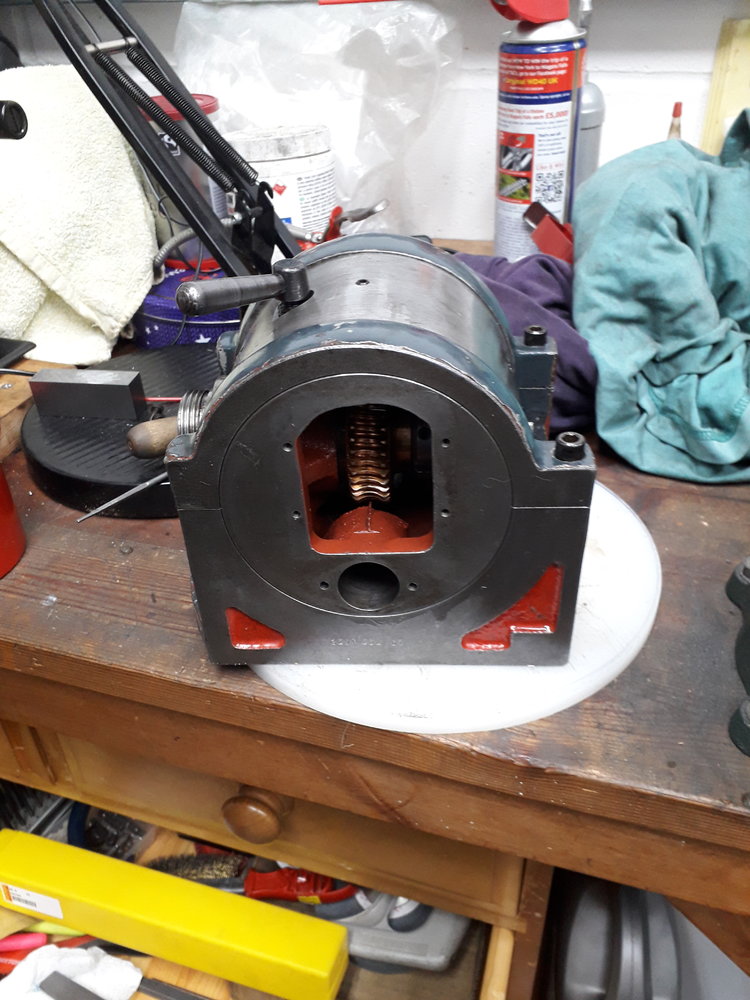

Has anyone else disassembled one of these? With the gubbins removed the vice is impossible to turn by hand, but I don't know whether this is normal (perhaps it's designed to be stiff to ensure it doesn't shift easily
When I reinsert the drive shaft it does turn, somewhat stiffly. I've never had a dividing head before so don't know what is normal behaviour or not.
As an added bonus question, any advice on getting to the bearings?
