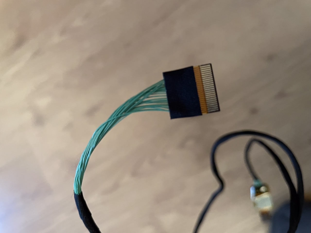

We have a laser shaft aligning system at work, which is obsolete and no longer supported by the manufacturer. It works fine, or at least it did... someone accidentally destroyed the pins in the receiver cable plug when packing it away.
We're ordering a new unit (£10k!) but still want the old one repaired if possible.
Pruftechnik are not interested.
We tried a local spot who said they could do it, but they came back with

The hard part is the ribbon cable, as you can see the traces are shaped to the socket head.
Does anyone know anywhere who would be able to repair this? Basically replace this entire assembly from scratch and also the cable end plug. It doesn't look super complicated, once you have a suitable ribbon cable, and IMO you could probably squeeze in an old IDE style cable or something in there which would work just as well. It doesn't have to be OEM, it just has to work.
Cost isn't a problem really, as long as the work is good.

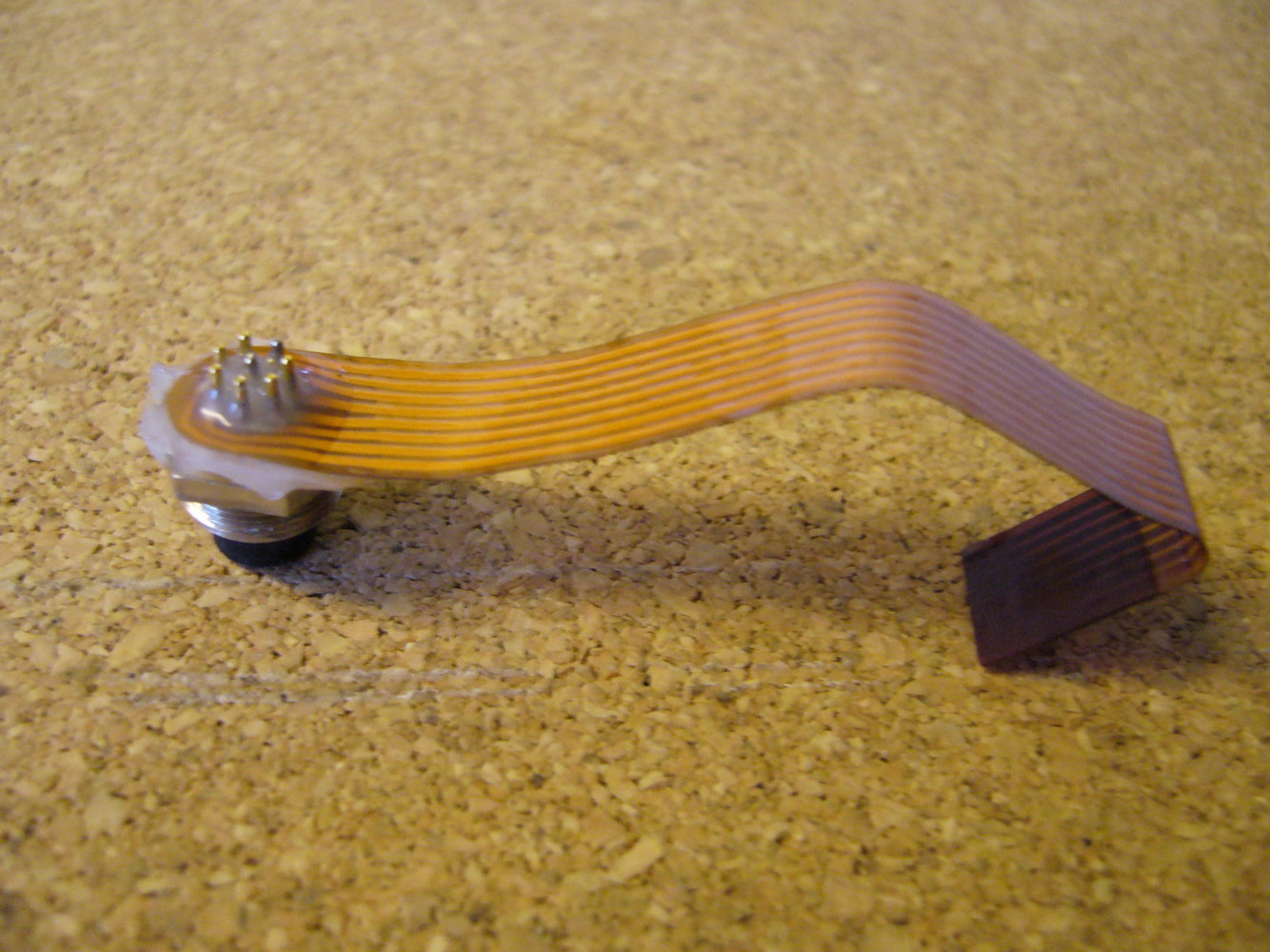

I am sorry to say we have had little luck with the Level unit, pic attached of the socket which as you can see has been well engineered by the Germans to ensure no one was going to repair it.
As you can see in the picture it is not a socket with wires soldered to it but an assembly with a flat flexible cable. To make matters worse, silicone rubber was poured onto it after fixing into the head. Unless the manufacturers, Pruftechnik A.G., offer to sell this assembly, which is highly unlikely, we have no chance of repairing this.
it might physically be too tight to fit anything else in, but if not, I think a stranded ribbon cable might be the way to go.
