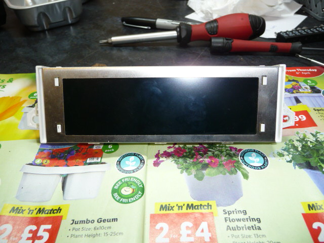

The lcd display on my van failed & I bought a replacement from Aliexpress, installed it in the van & I had a fully functioning display again for 10 minutes, then pixels started disappearing before the screen went blank apart from the backlight. After a few more minutes the unit died completely.
Got a full refund from Aliexpress so I opened up the new (broken) unit.

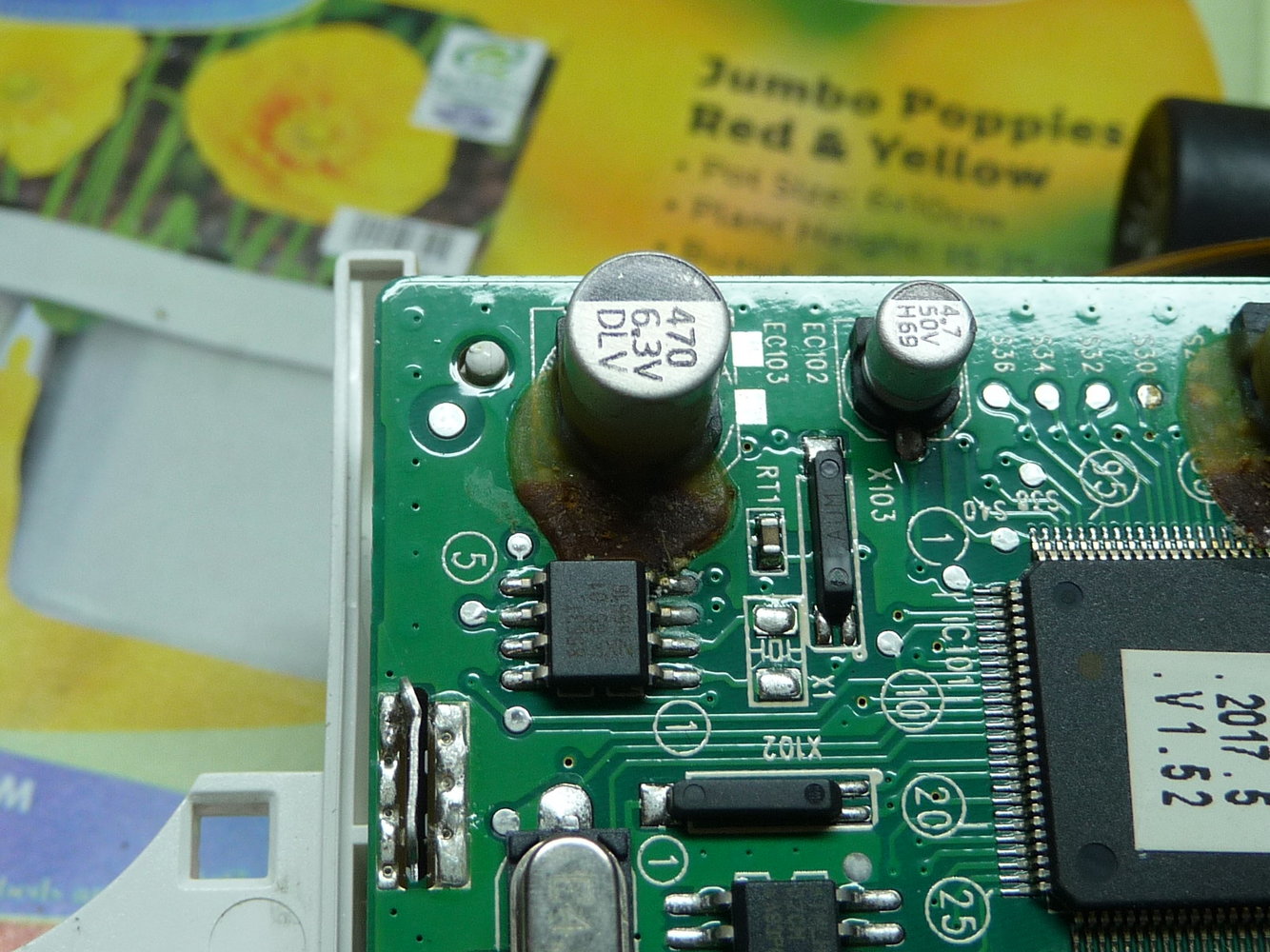

All looked ok apart from 4 surface mount capacitors, 2x220uf & 2x470uf. They have some sort of glue around them & some of it looks burnt. Could this be a sign of failed capacitors? Would this cause the type of failure the screen suffered?

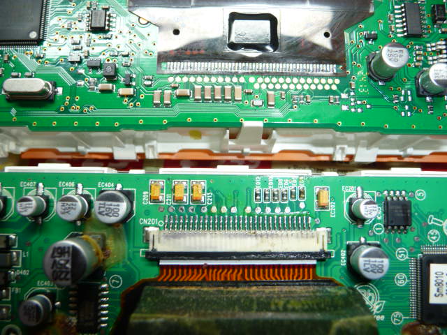

What I was really hoping to do was to fit the lcd of the new unit into the vans original unit.
But there's a problem, the original screen's ribbon cable (top) was joined directly to the pcb & has 50 connections.
The new screens cable (bottom) plugs into a socket that's soldered to the pcb but it only has 30 connections!
Is there any way that these screens can be swapped?
If not I might have a go at repairing the new screen, I have some suitable capacitors that I can swap for the dodgy looking ones.
