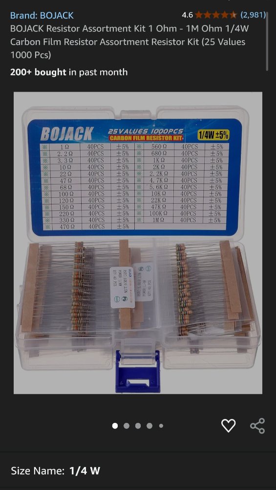

You can go overboard, pre-buying kits of components, that you will only ever use 1% of, but having some basic selection of resistors, caps and a few common semis is needed so you can continue diagnosing when you need a component. Sometimes you can combine parts you have in stock just to "test a theory" even if you don't have the exact part. When buying kits don't forget that SMD devices come in different physical sizes so choose the size you work on the most, otherwise it's going to get spendy.

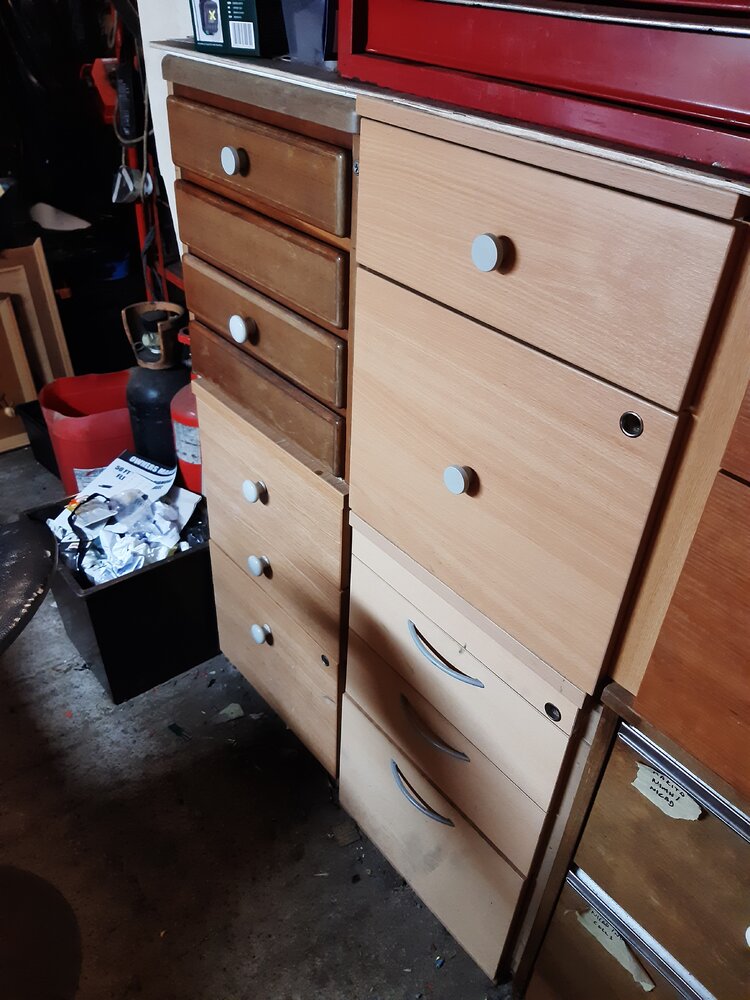

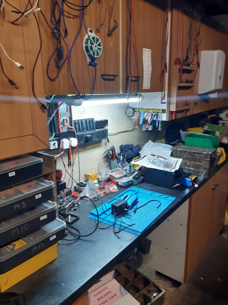

Note on component storage:
Like all workshop storage you'll be re-organising it as your collection ofjunkcherished components grows, but I'm not a fan of those small drawers for component stock unless you have lots of space (or not much stock). I feel they are space wasters for small components if you go 1 value per draw or sub drawer and the same with big components like connectors, so the sweet spot for those drawers are for small nuts/bolts and maybe medium weight power transistors imo. I use pink static dissipative bags for each component value, then store those bags upright in (shoe)boxes a bit like like a card index - super quick retrieval and the box goes back on the shelf out of the way when done. I do this for short strips of SMDs and through hole components except overly chunky power transistors and larger electrolytic caps. Reels I store on the P&P machine!
