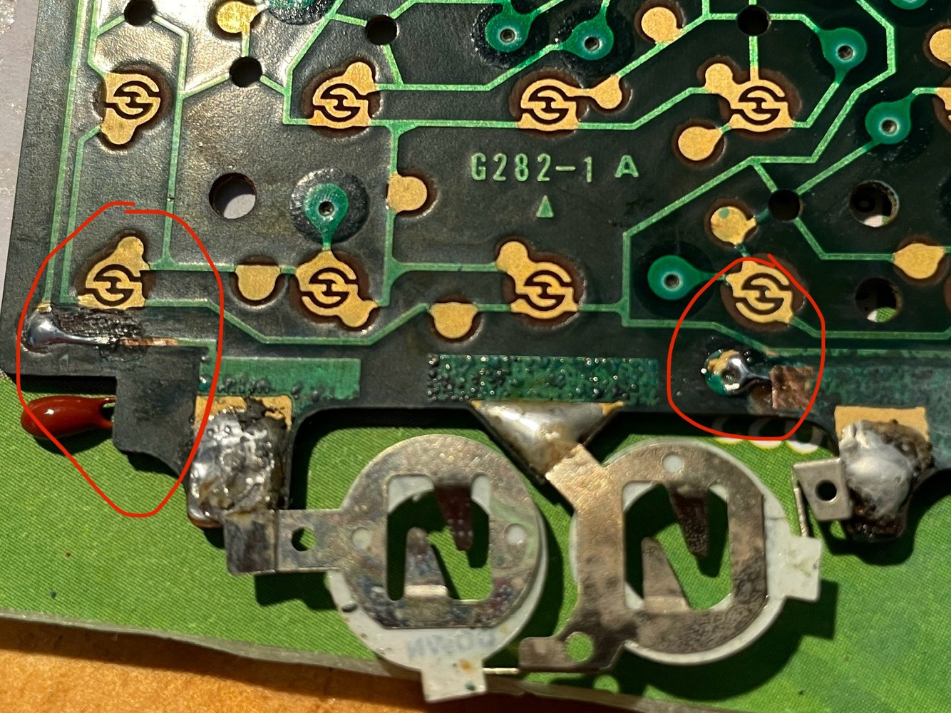

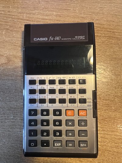

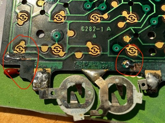

I have an old calculator, it’s been in a drawer for donkeys years and the two button cells have leaked all over the bottom of the PCB doing some damage.
Cleaned it up with iso alcohol and put in new batteries but it still didn’t work.
Traced a couple of hairline splits on the tracks on the PCB that I blobbed with solder to repair.

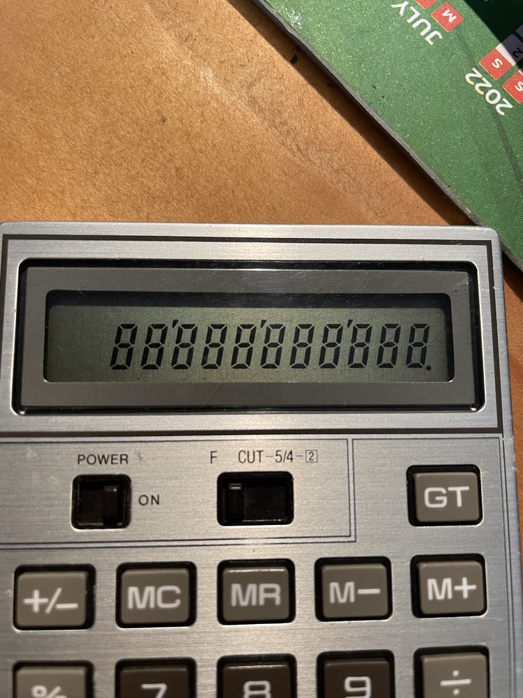

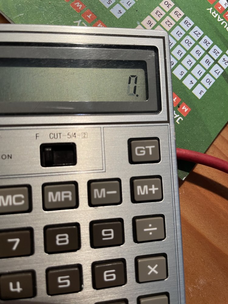

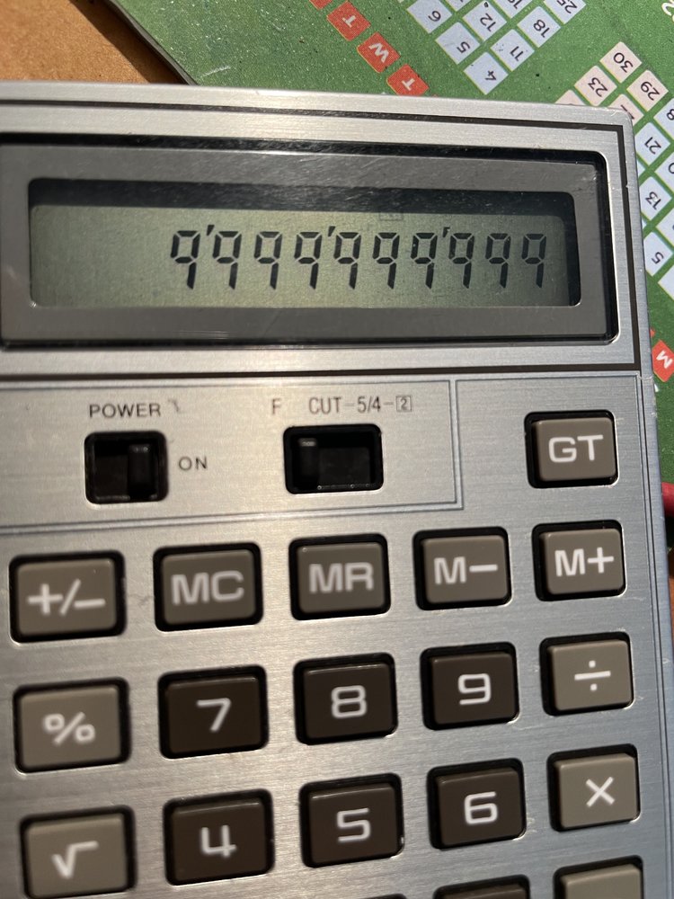

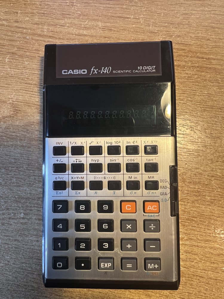

It now works but the display is not correct
This should be a zero
And these should be all the number 8
Being common to the whole display is it likely to be another bad/broken track or is the LCD toast?

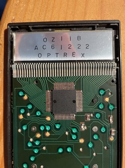

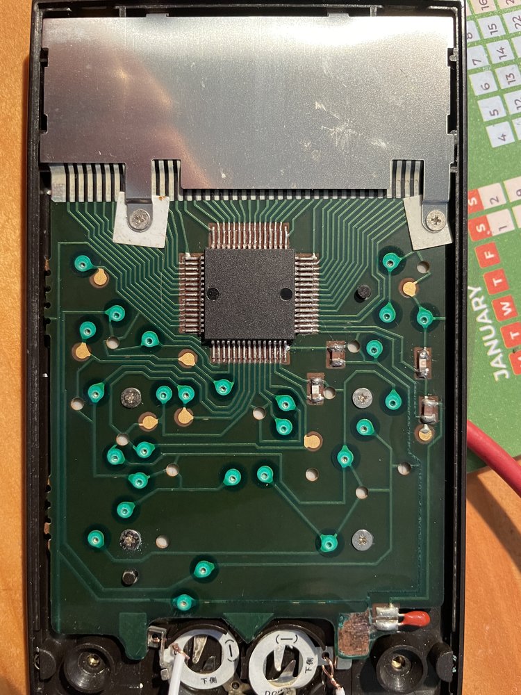

PCB for interest.
No purpose to repair other than my own interest.
