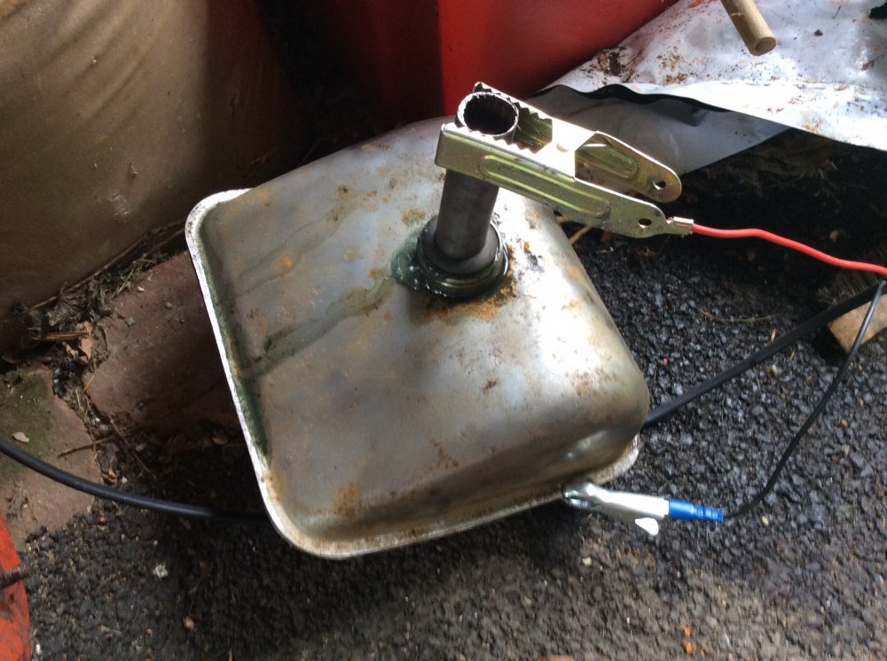

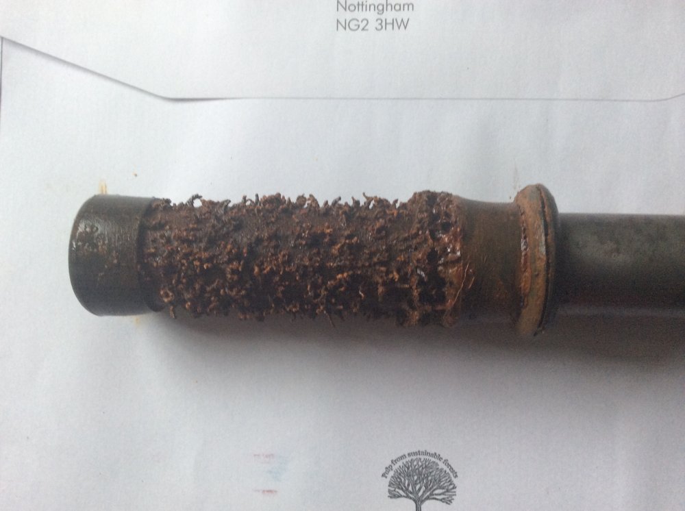

I had a play with electrolytic rust removal in the weekend, and found it interesting. I had an old toolpost from a lathe, and also the associated washers and bolts that go with it to de-rust.
The method itself works fine, but my issue with the method I used was that i was fiddly to set up (basically, I ended up using a copper pipe hanging over a bucket, and then I suspended the bits from this using bits of wire, so that I could do all 5 bits at once (toolpost, washer, 3 bolts).
For smaller items, it would be much easier if the bits could just be "chucked in" into some metal basket (i'm thinking "chip fryer" style). Does anyone have any thoughts on why this would not be a good idea? I'm just looking for ways to get around the fiddlyness of setting bits up - for something like bolts, washers etc it's a considerable faff, so if they could all be chucked down into a tray of some sort, that'd be much easier. The tray would be attached to the battery charger.
Would a basket work as a faraday cage?
