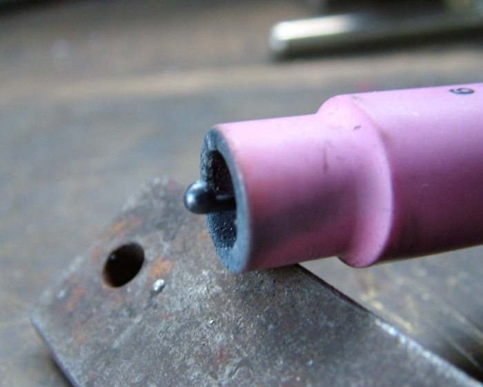

For the past few weeks I have been welding up a structure in box section steel (50mm x 3mm thick) using a 1.6mm thoriated electrode on d.c. at about 80 amps. I noted that the electrode did not change or wear away except when my hand shook and I grounded it so a re-grind was necessary.
I have now tried to weld a length of 16mm by 3mm thick aluminium L section using 1.6mm zirconiated electrode on a.c. and 4043 filler. I started on a test piece and found that I needed about 90 amps to get a reasonable liquid pool but, more seriously, the electrode formed a large ball on the end and in quite a short time burnt back so that it was almost inside the shroud. I was using 50/50 duty cycle on the a.c. I tried pulsing but as I had never used this before I set at 120/70 amps with about a 30% pulse at about 12 Hz but this made no difference to the wear rate on the electrode. All the welds were across the section giving a maximum length of run of about 12mm and most were not much more than a generous tack so the torch was only active for short periods
This web site gives the range for 1.6mm electrodes as 70 -160 amps on a.c. so I should be within the safe range. I know that a.c. will put a greater heat load on the electrode than d.c. but my question is should Zirconiated electrodes burn back at this rate or am I doing something silly? Do the current charts assume water cooling at the upper end of the ranges?
Other information that may be useful. I have a R-Tech TIG201 welder, the argon flow was 8 l/minute and I was using a number 6 shroud on a WP26 torch.
The picture shows the electrode after a very short use - not exactly as described above as this had a somewhat larger ball almost entirely inside the shroud.
Thanks for any help you can give.
Chris
