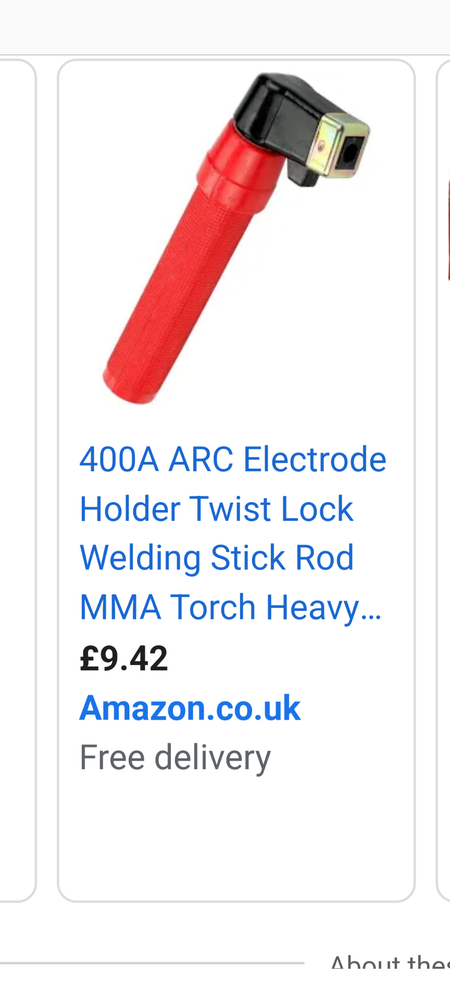

That’s what I use - very comfortable to hold
I've had one of those holders for 40 years or more , if you hold them correctly with the lead over your shoulder the angle of the electrode is perfectly positioned for angle and cant of the electrode . Take care to hold the head and screw the sleeve up do it the other way round and you'll eventually end up twisting the end of the cable off.As a DIY welder,is this ok for a 140 amp arc welder,and are these holders any good
It's my preferred type too, they're very fast, very secure, and low profile for getting into awkward spaces.This style of holder has been recommended by several members on here, in the past.
