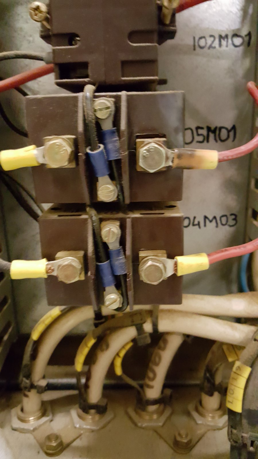

Nip it up with a pair of pliers ad a wrap of tape, jobs a good un!

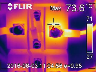

I would say on the report it's xyz connection in this control panel/ dist board but don't get to specific about it. As long as its reported that it's over heating, a fire risk, and where it is you should be ok.
It could be a CT coil for monitoring something.
The hot-spot seems to be in the terminal itself,
