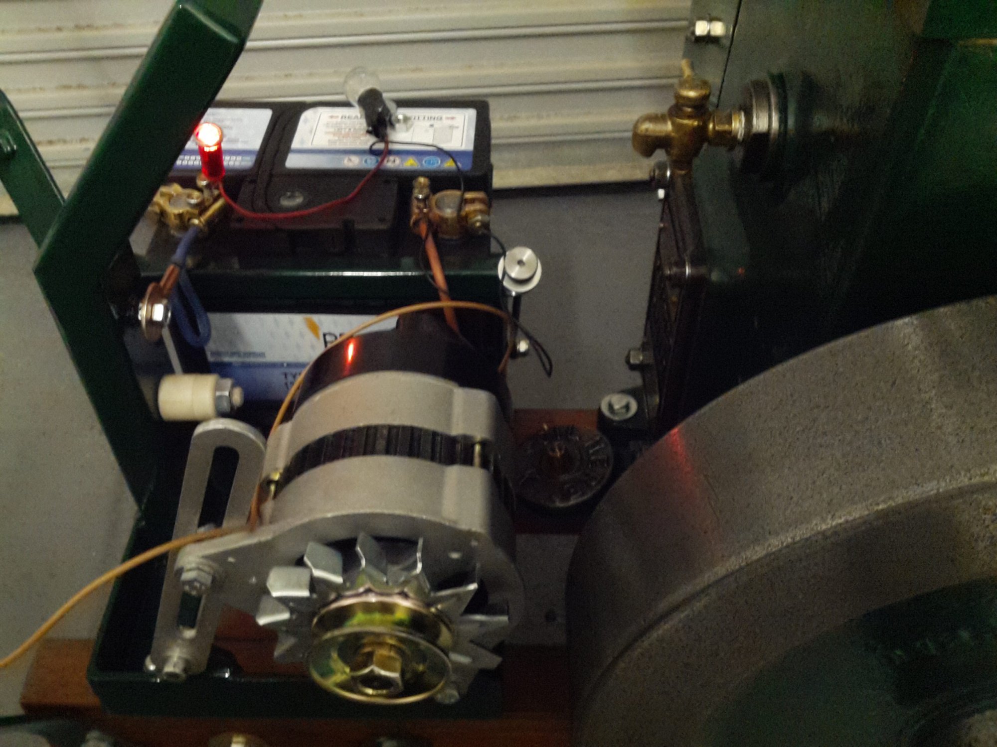

I am trying to wire up an alternator to charge a battery. The ignition warning light I have does not draw enough current to activate the coil in the alternator so I thought put a higher wattage bulb in the circuit (20w this does activate the alternator) but I really want the nice warning light that I have already drilled a hole for in my control panal. When I connect them only one bulb will light and it doesn't work the alternator
Hope you can see from this pic. I would have thought both bulbs would light up.
I have also tried a 10w resistor that was supposed to work but it doesn't.
Were am I going wrong?
