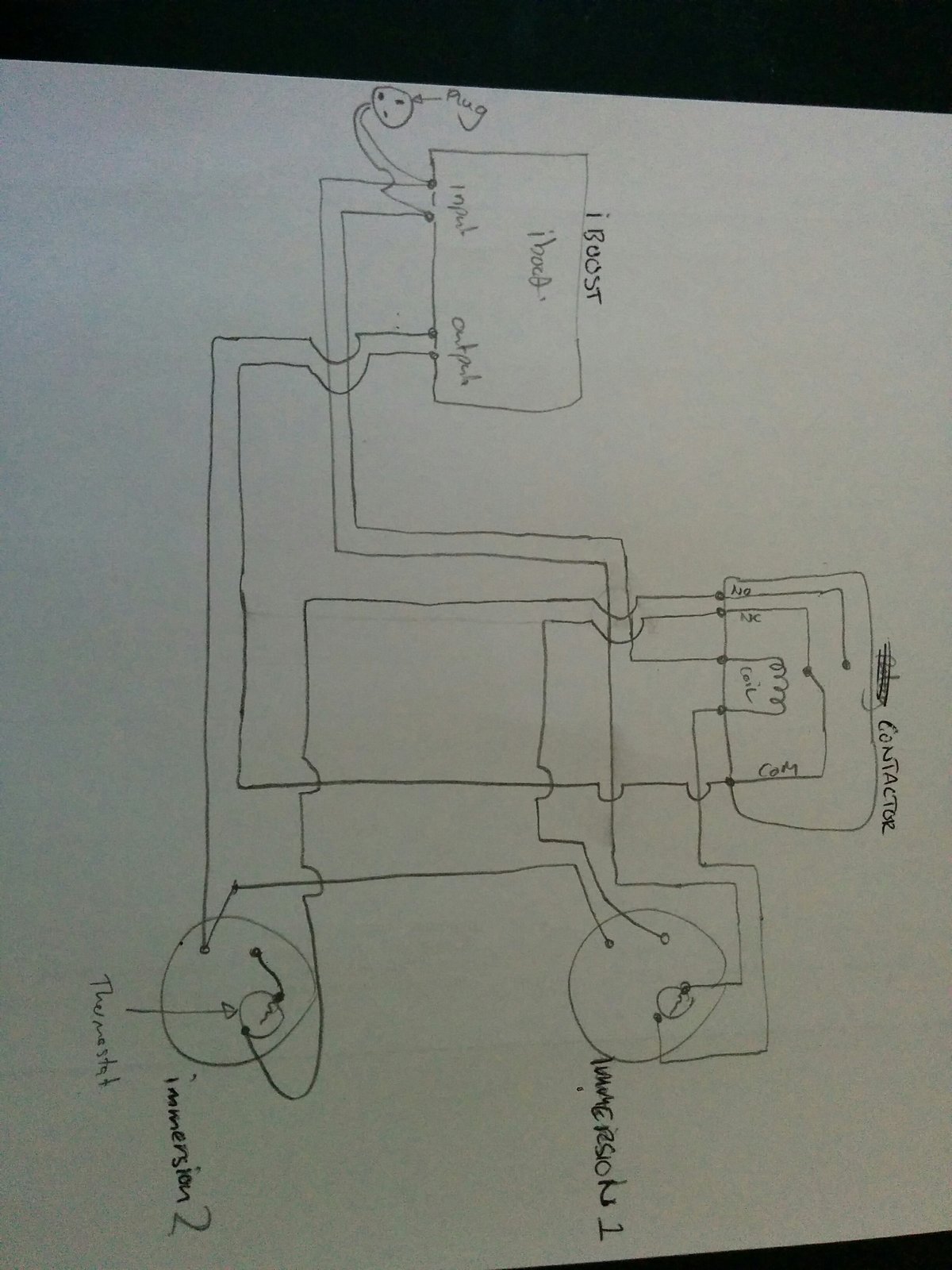

I have a solar iboost diverter. It's great, it fires electric into the hot water cylinder instead of pumping it into the grid when consumption is low and generation is high. In this weather, it amply does all hw needs.
However, as days get cloudy, it won't. It can't heat the large hw tank effectively.
There is an option to buy a "solar iboost+" which does exactly the same thing but fires heat into a primary source before switching to a second one. HW tanks with a "boost" tank on top are ideal for this. I have one.
However, a new one of these is lots of cash and I *think* I can achieve the same with use of a NO/NC contactor.
My preliminary wiring diagram looks like this;
I'm fairly confident it should achieve what I want to do and I've ordered a suitable 16a contactor and enclosure to put it together.
However, I thought I'd just let anyone interested cast an eye on case I've made any serious electrical faux pas in my scheme. Maybe an issue if the first thermostat fails? But shouldn't be any different to if it were connected normally.
Assume everything will be suitably earthed, sheilded, properly connected etc, more about the principal of the idea...
Many thanks!
