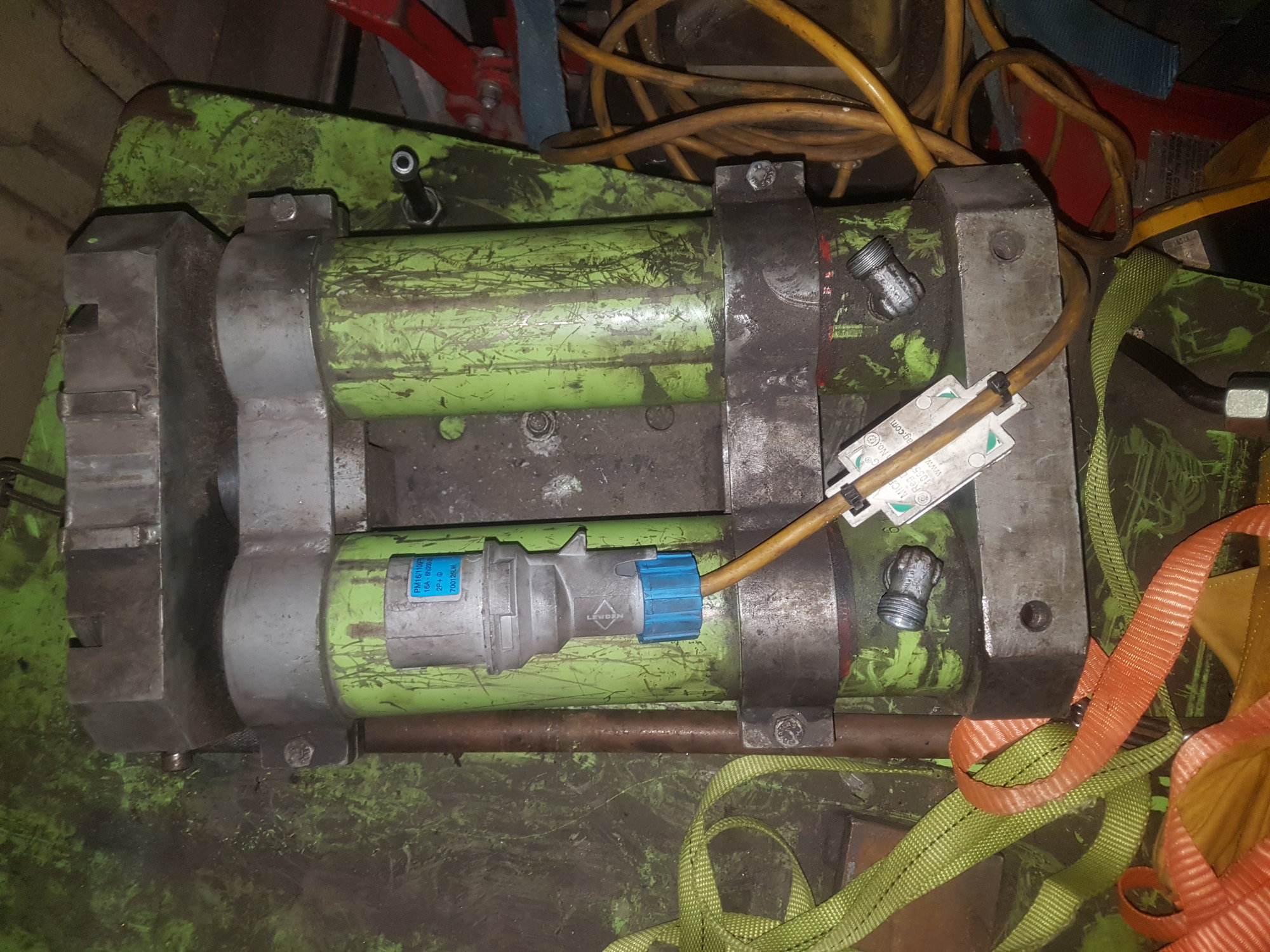

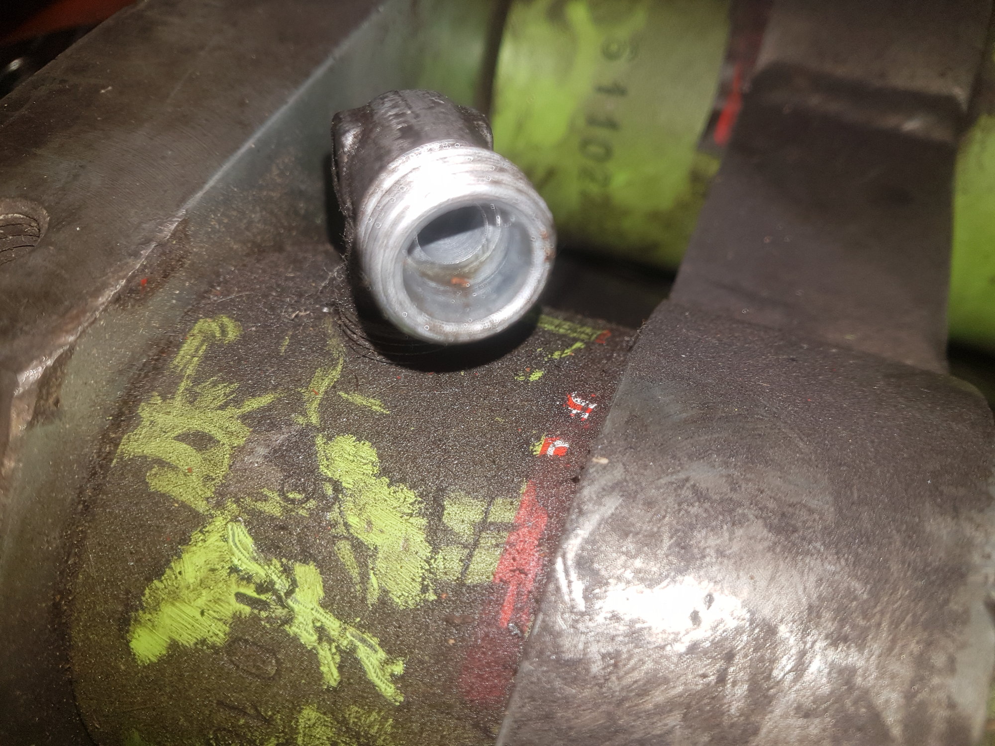

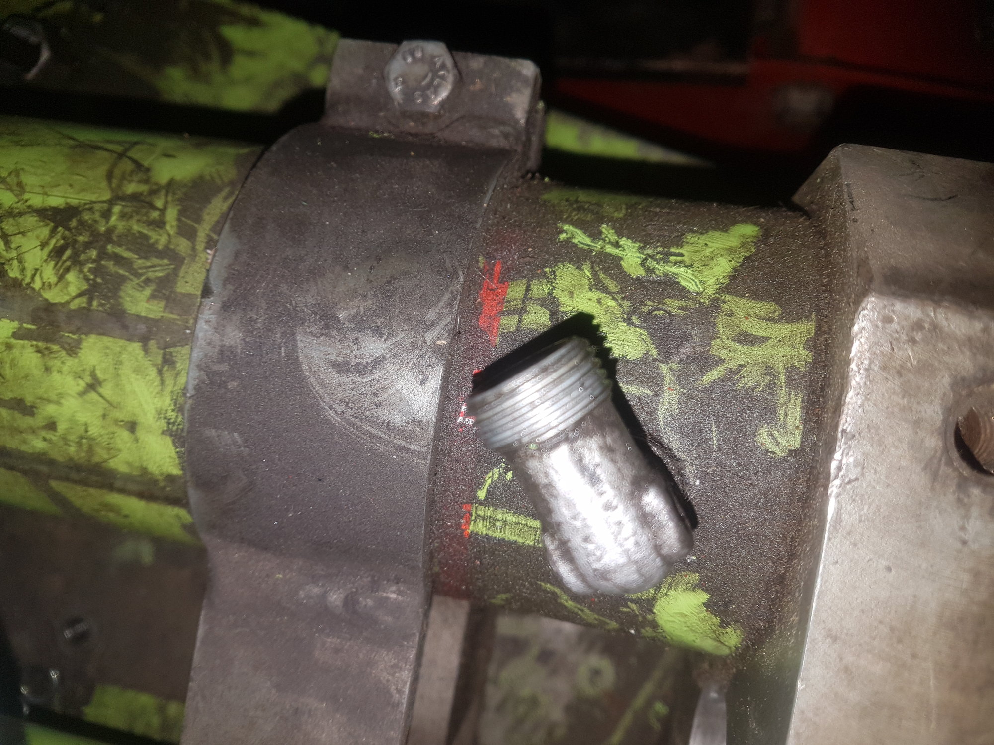

Yes if you don't damage the pipe.if i cut them off like normal olives on copper pipe can i simply replace it with a new one after?

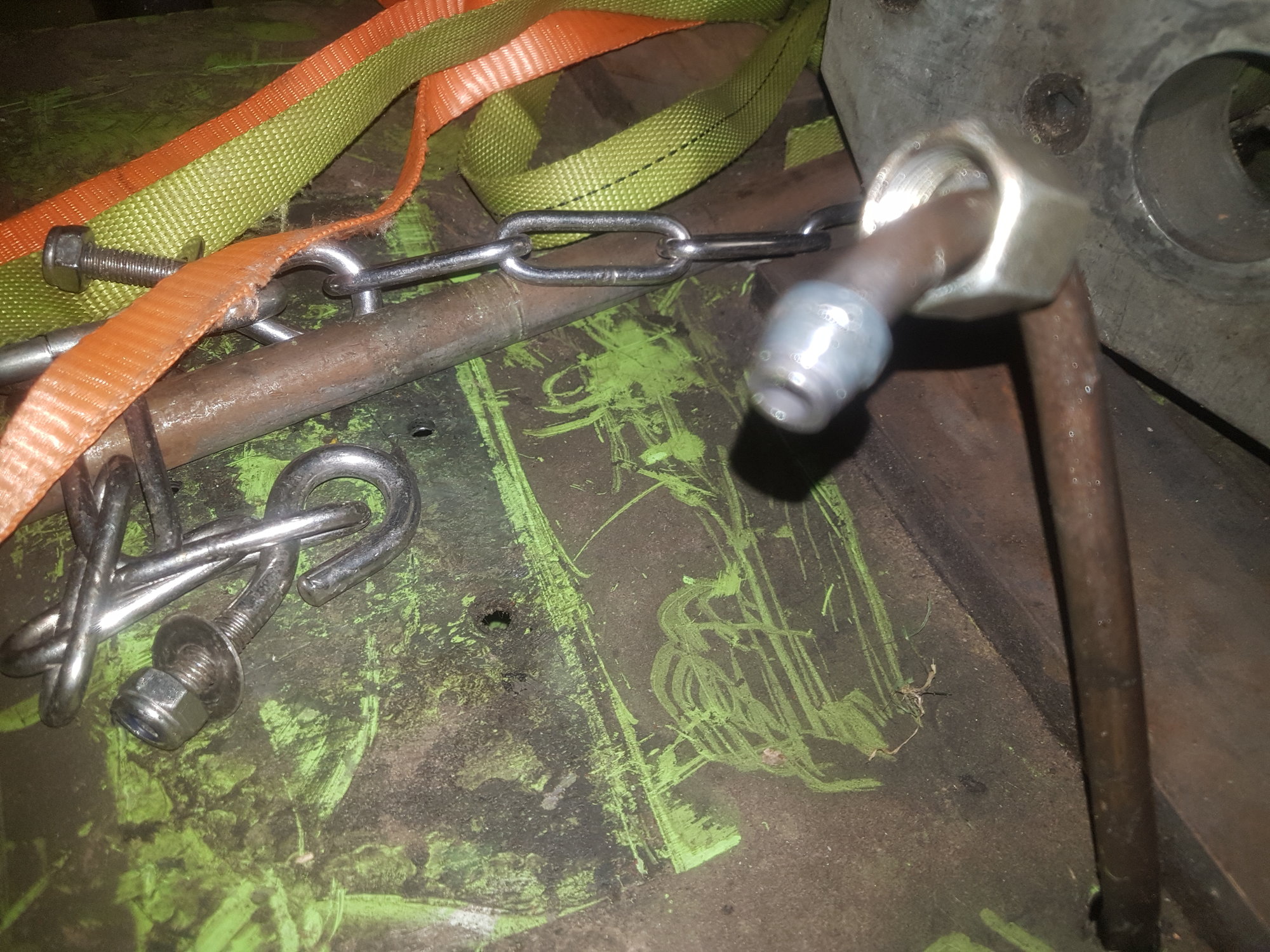

A joiner if you like, maybe do away with the ridged pipe and have some hoses made up?whats a running unions for? not sure how I want the pipe work configured yet I just want to test the pump, controls and rams but they pass through the metal table as they are now

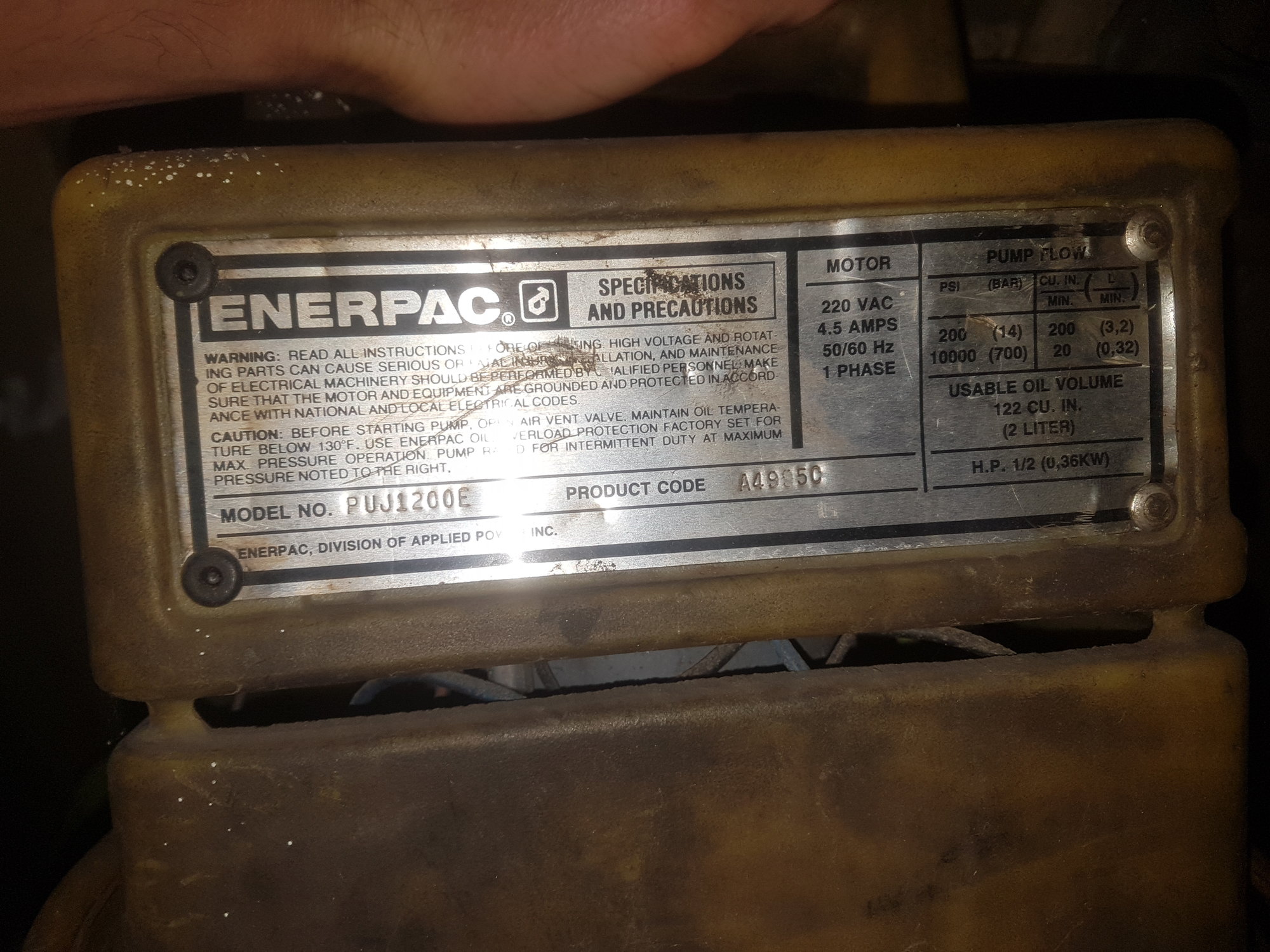

Enerpac Type pumps will run at 10,000psi, (700bar) any hoses need to have a working pressure to suit this. Standard 2wire hose will be around 3000psi. Multi wire hose may reach a working pressure of 6000psi. Make sure you use the correct hose. Google hydraulic injection fluid injury to see why
It does state 700 bar on the data plateThanks for.the warning I know it can kill
