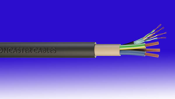

Thats a double insulated mains cable inside a separate sheath and of a flexible type which they mention as requiring no spacing (might depend on length, check the small print etc. ).
SWA is mentioned as being a shielded cable so also makes its installation requirements different.
