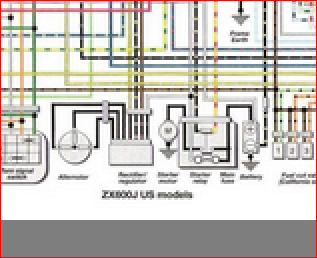

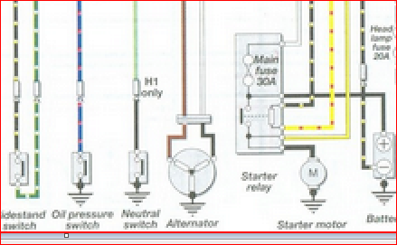

I know diddly about Motorbikes but have this ZXR750H1 generator on the bench as a possible replacement for the duff 6V genny on an ancient Austin Seven. I want to get 12V into the car for ease of use. The Genny has 2 wires as the only obvious output, so, does that suggest it is internally regulated and will put out circa 13V all by itself? Not sure how these things go in terms of needing a separate regulator like the CBR600 one I fitted to a VW aero engine.

....your a braver man than me, SHMBO would have my privates on the block.
so you are in luck. ( brown and white wires are shown, I can email a photo of diagram(Haynes) if this helps.
