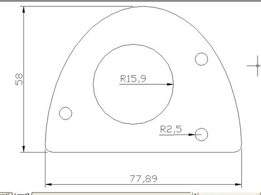

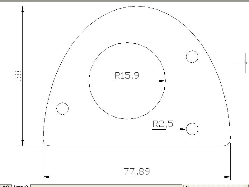

Anyone with a lathe and 4 jaw could knock them out surely.
I was hoping to find someone who makes them all ready.
That way I only have to adapt it a little.

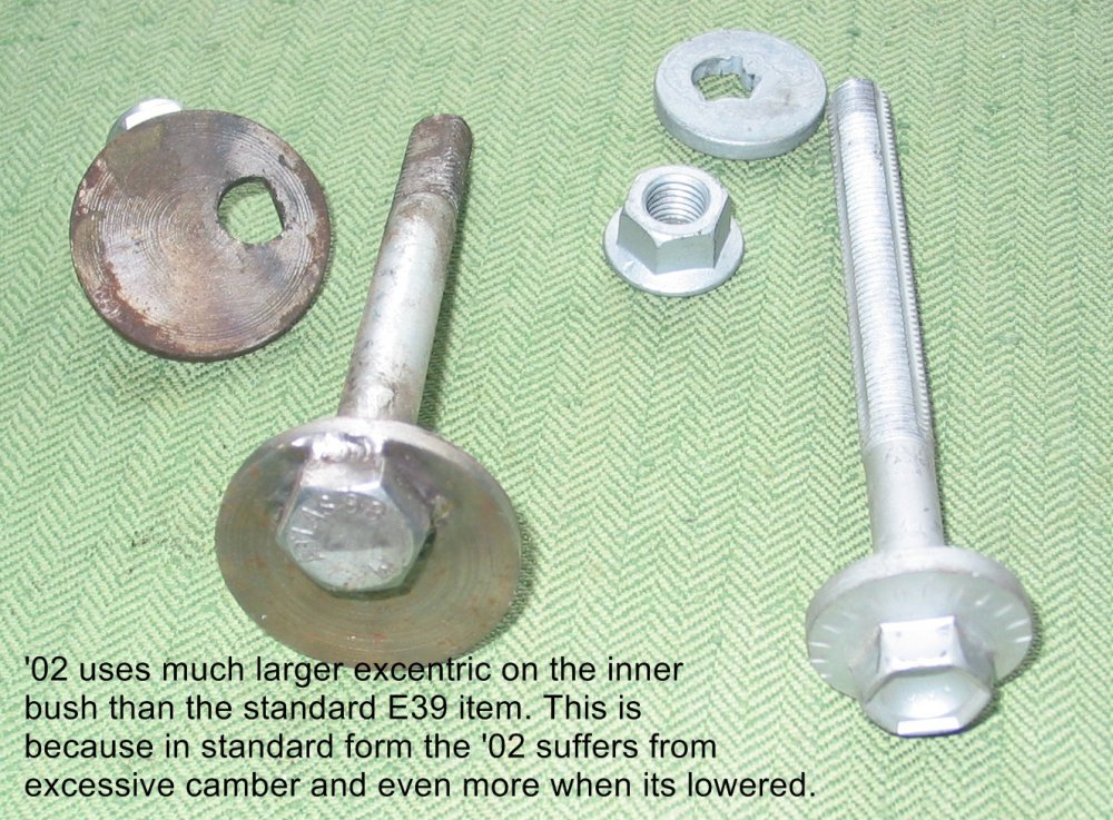

It's a run of the mill eccentric bolt washer camber adjuster as used on a lot of autmotive suspension
and only sold at the main stealers prices in the parts deptThat's the problem they aren't run of the mill they are made specifically for the paticular application.
