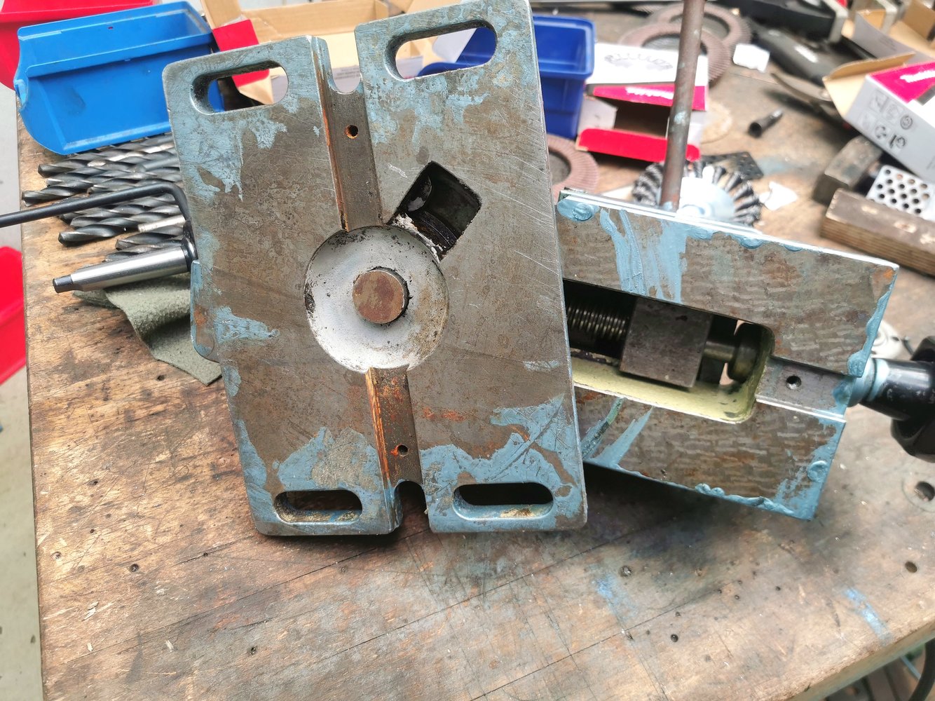

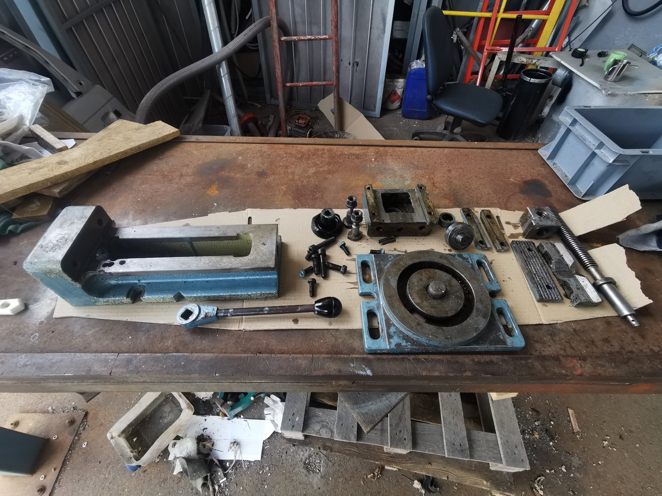

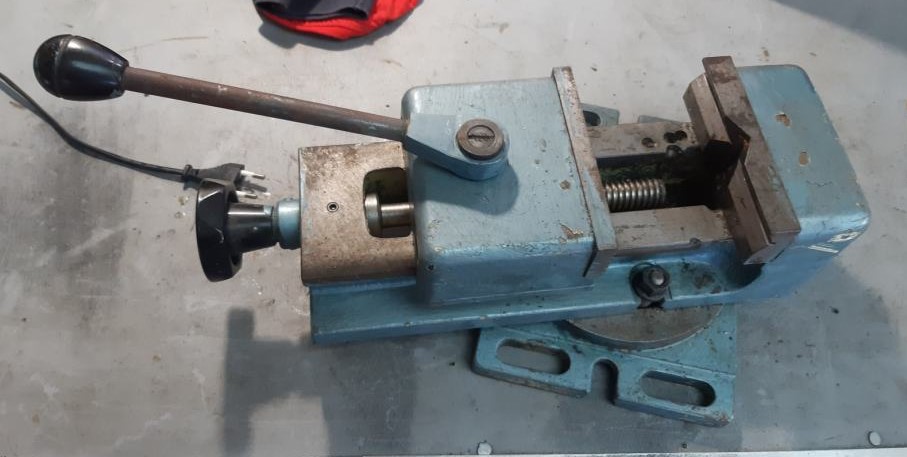

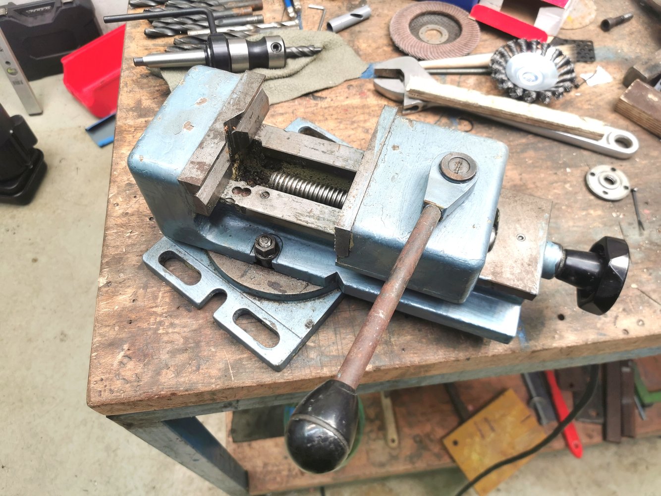

small project: today's purchase, opening and jaw dimensions 125mm*125mm*h40mm.

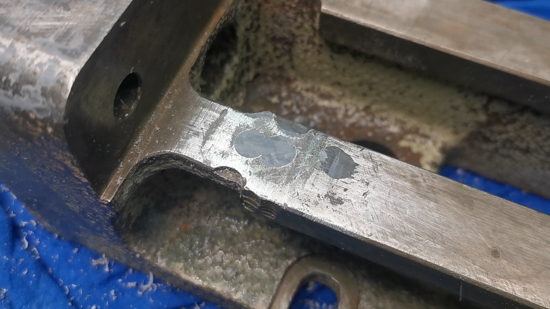

All parallel guides were scraped at the factory and are in excellent condition.

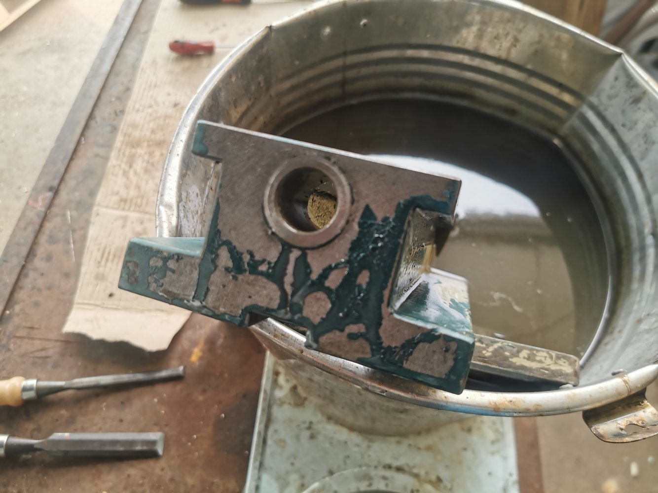

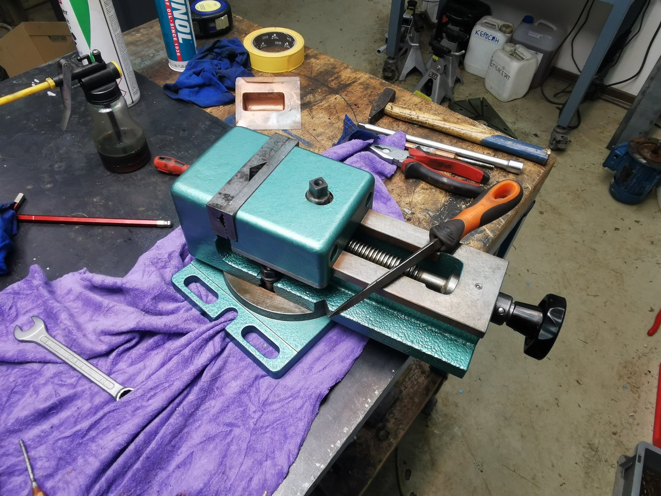

cleaning:

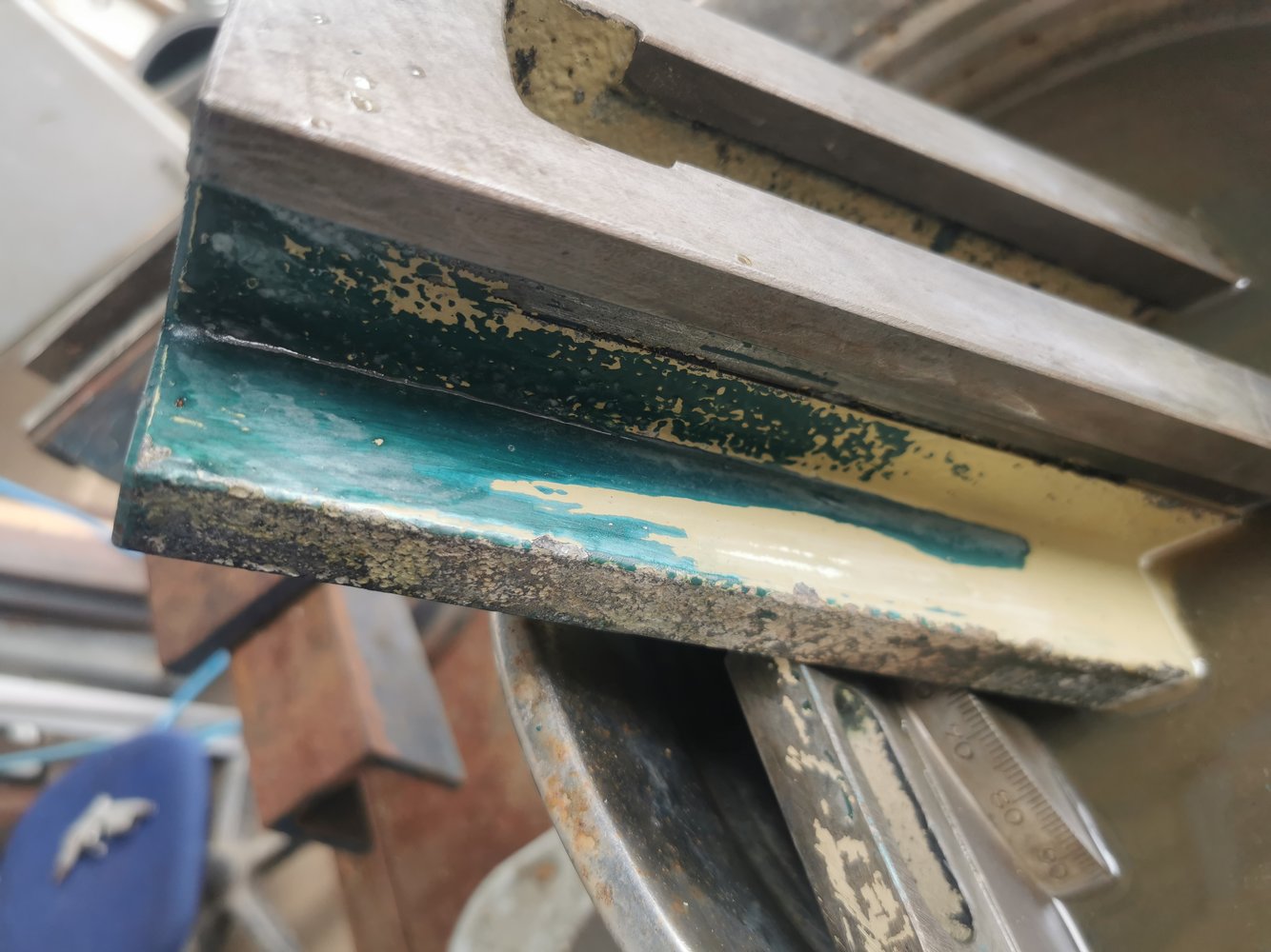

Approximately 2 hours exposure at +80C in aqueous solution ~10% NaOH.
I wanted to boiled , but I got tired of waiting for the temperature to rise. The alkali removed the paint almost completely and the old, literally petrified oil. The cleanup process is self-executing, no hassle.
I think this is either in-house production or an unknown factory from Yugoslavia. All parts are marked with assembly number 74.
