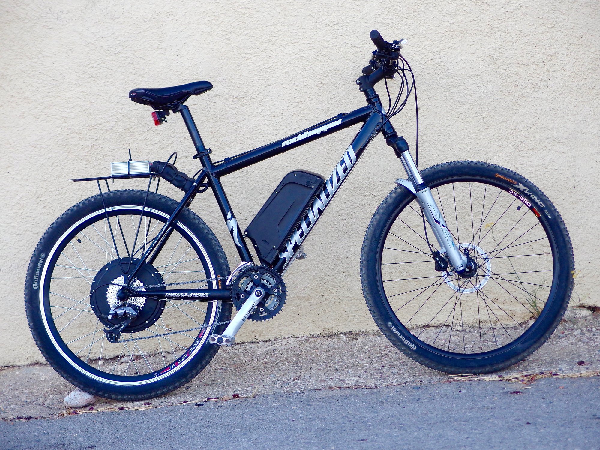

Yeah I did a conversion on a Rockhopper a bit ago ...the bike cost me 80 quid and I bought it unseen ...conversion kit came from China and was something like 350 Euros the transport cost bumped it up a fair bit I think 80 Euros ...but it great I can buzz about the hills around here ..Conversion kits with hub motors do make the bike heavy so if you run out of battery it's hard work getting home.ha ha...if you are going off road a rearhub motor is better ...on the road front hubs are fine ... You can also get a bottom bracket motor conversion ..they are much lighter, have less friction so can be used without power...but tend to be more expensive .. I think if I do another I might go for a bottom bracket motor ...one day maybe ...View attachment 239735
That kit on Ebay does not have a battery ...and is not actually legal in the UK without licence , insurance and registration ....
