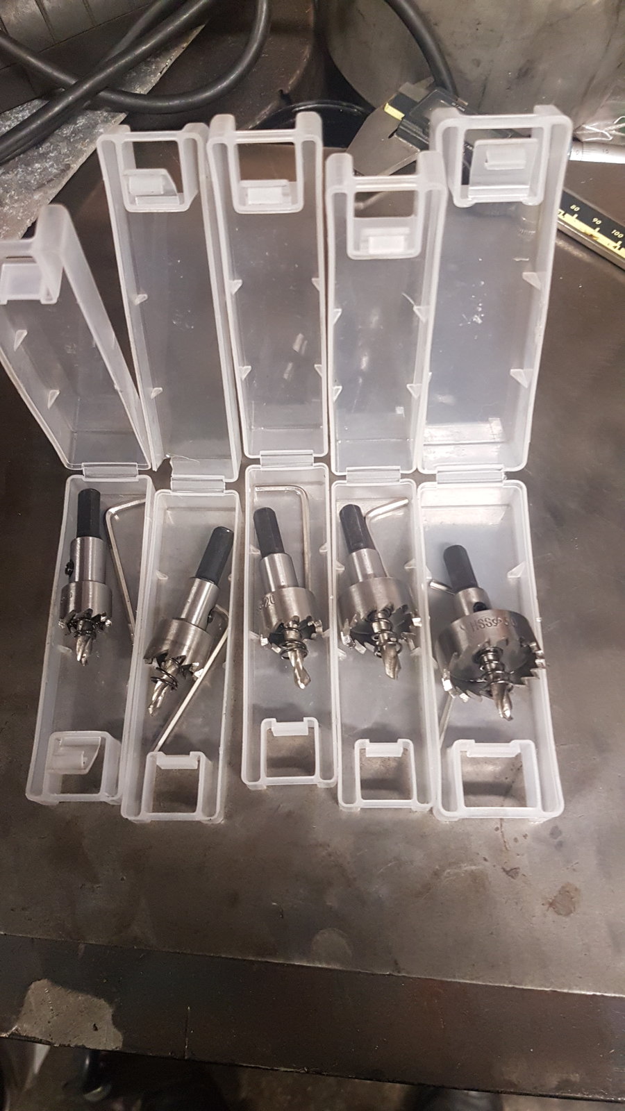

Saw this set on ebay one night and decided to order it just to see what it was like.
https://m.ebay.ie/itm/5PCS-HSS-Dril...ter-16-30mm-/252785215865?txnId=2224177118015
It arrived today after 4 weeks.

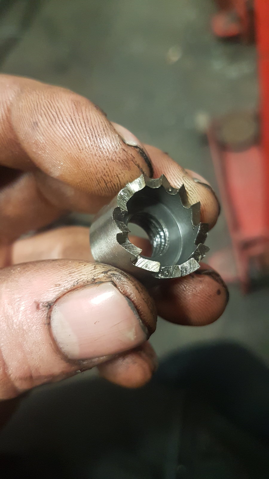

The quality of the machining is actually excellent. The fit is spot on.
Gave them a try out on some 2mm mild steel and they flew through it. I was running them at 280rpm and dabbing on atf with a brush. Gave them a try on some 2mm stainless then. They ccut lovely in stainless with really long swarf off them.
Drilled a 16mm and 30mm hole and measured with my verniers.
I'm really surprised how good they are considering the price. Just have to see how long they last before going dull.
