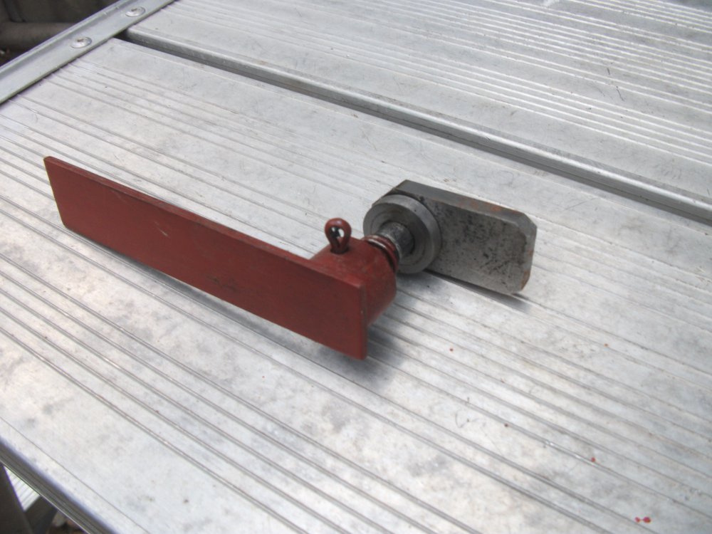

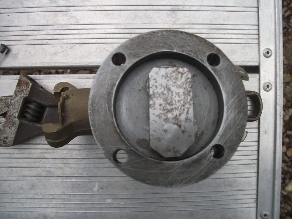

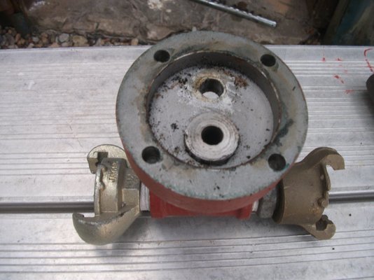

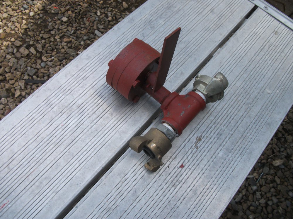

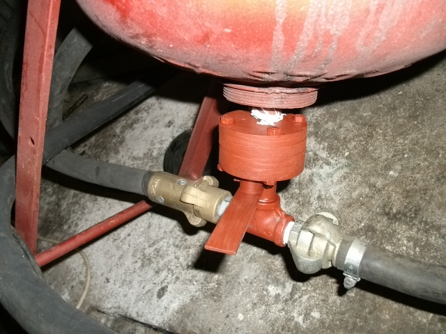

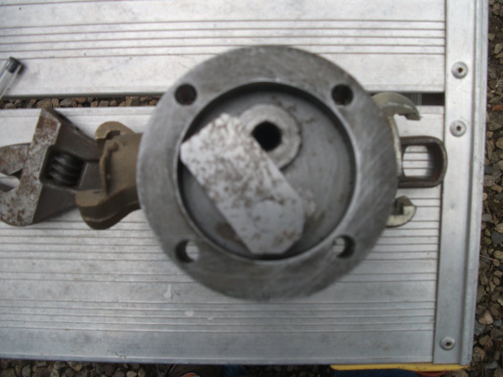

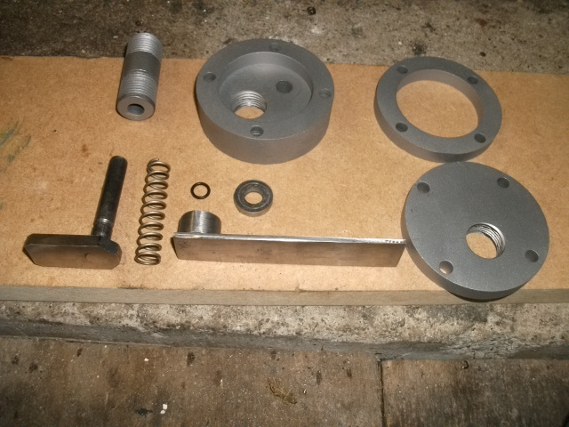

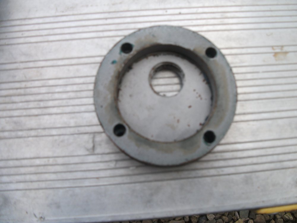

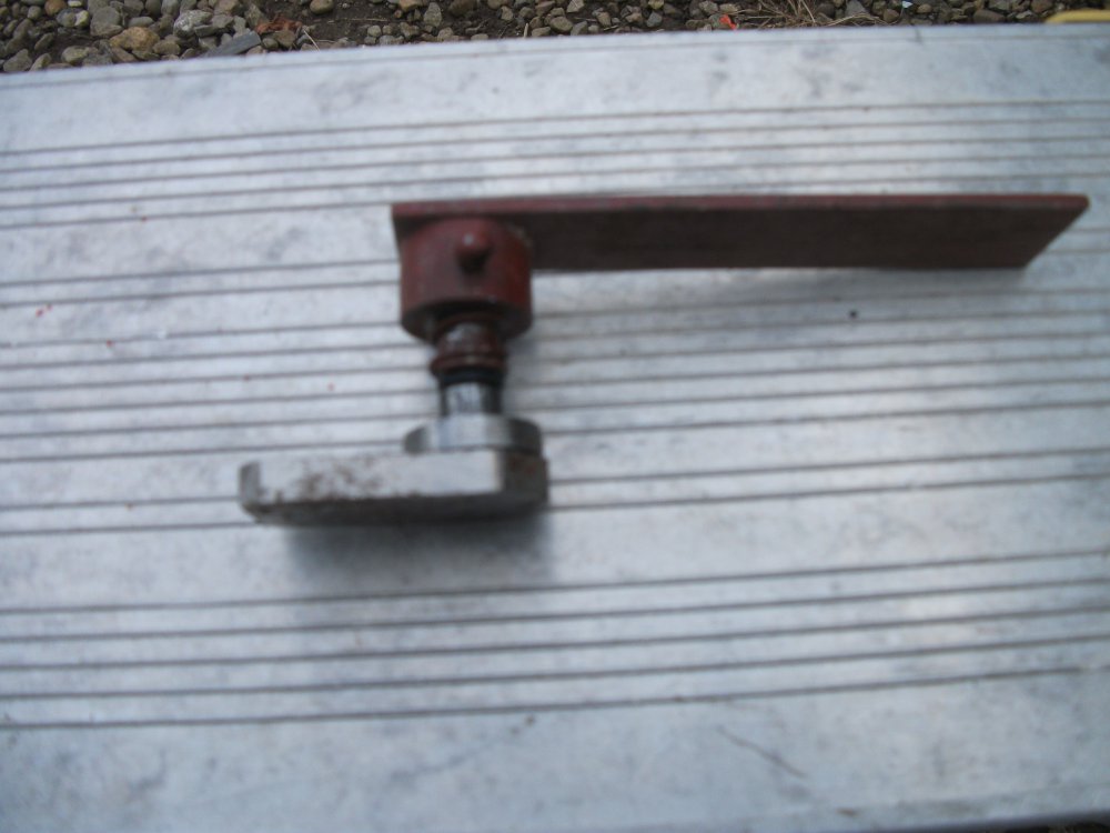

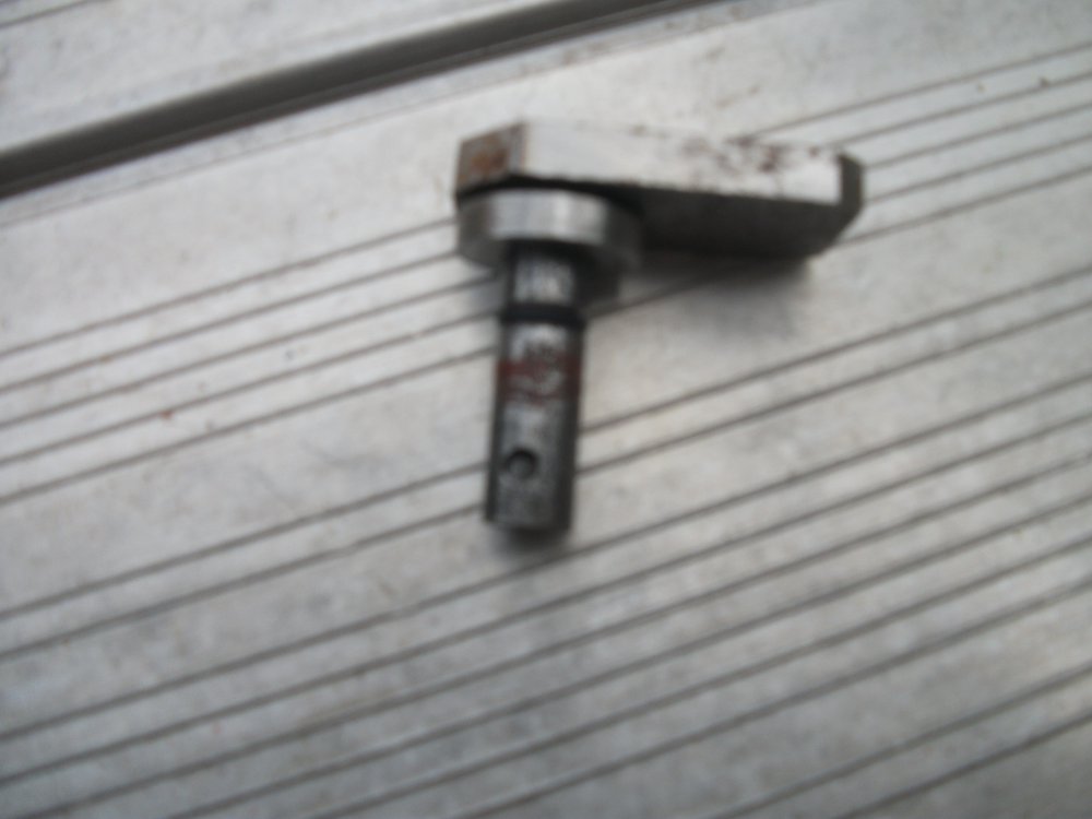

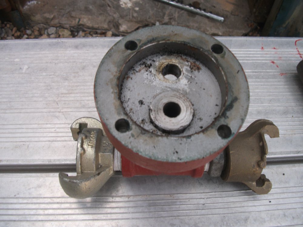

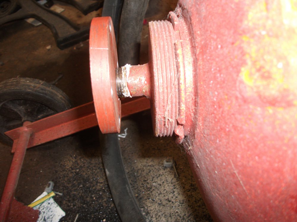

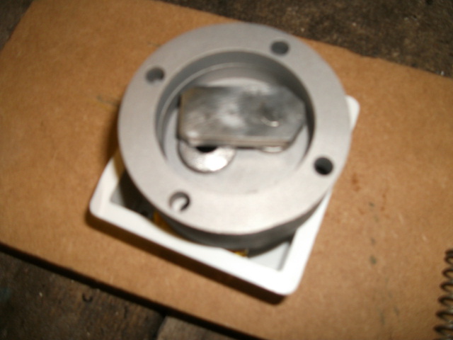

pretty easy to make but takes about 4 hours to make them
they work real well on 1.5mm grit .down to kiln dried sand. with the regulating plate sitting proud of the outlet any iregular media doesnt block the orifice it drops to one side and the flow carries on. they just need cleaning out now and again
