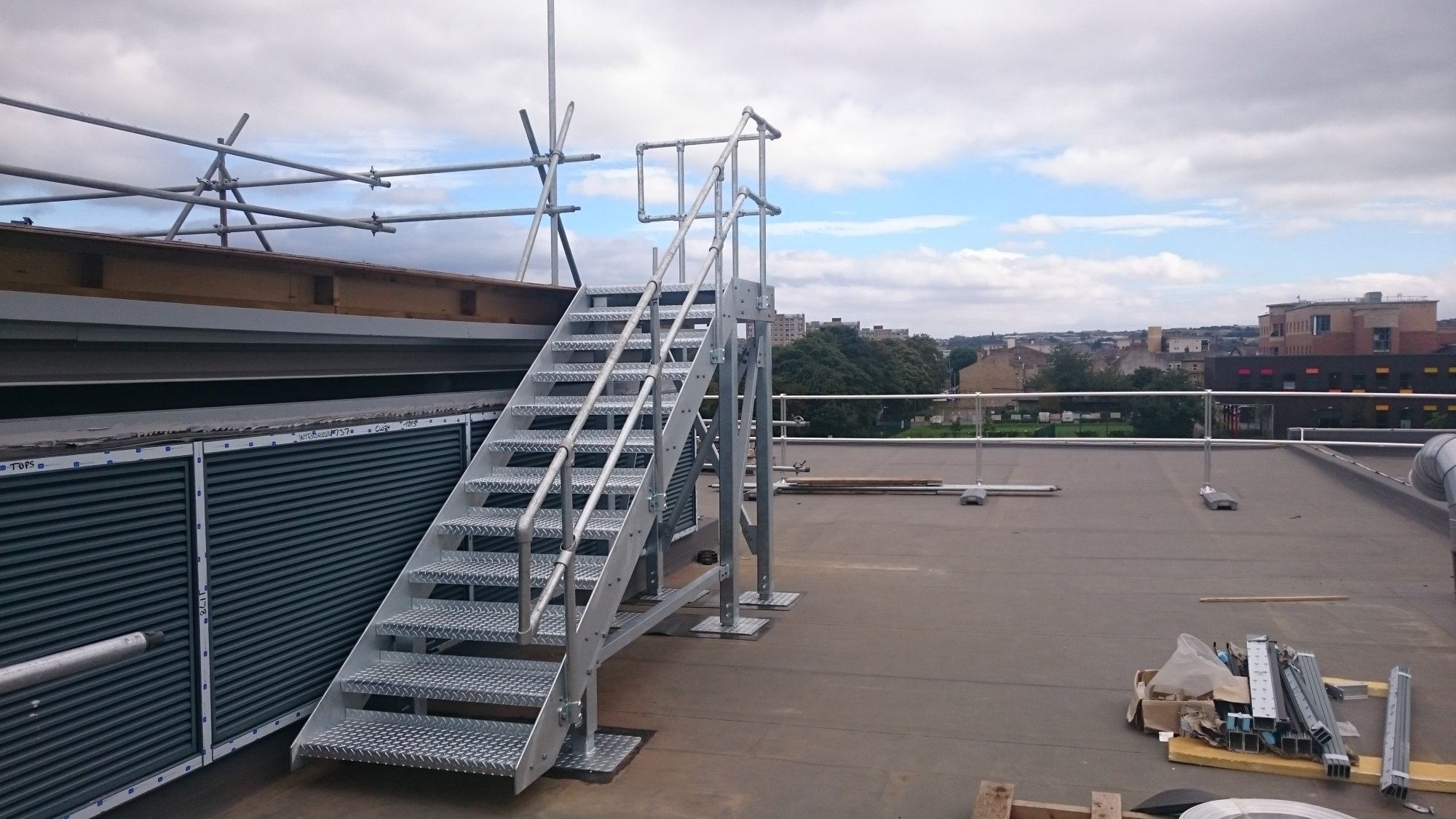

A nice easy galvanised roof stair in here - all free standing as it sits on a membrane roof. Just needed the roofer to finish to put the rails round the upper roof.
Roof that it sits on falls in all sorts of directions so used baseplates with a stub that passes into the base of the SHS posts - set it up right with clamps on, then drill through and bolt.
