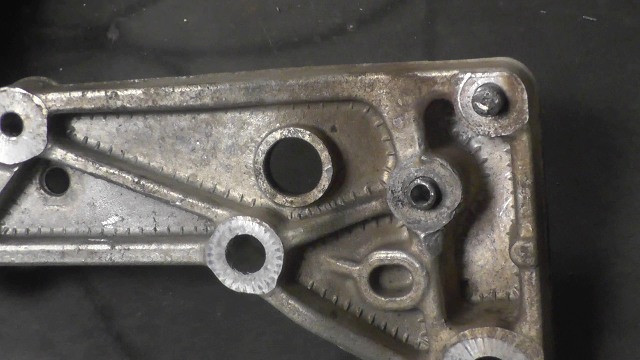

Can you get this out mate
Tig weld a nut on the end of the bolt, grind flush the sheared end, then warm/heat the bracket and spray some type of release oil in the sheared end to contract the bolt/lubricate the thread, while trying to work the bolt loose.
Broken off easy outs!
Your choice lies somewhere between - weld extraction using 312 to spark errosion!
Maybe cheaper to buy a new alloy casting?

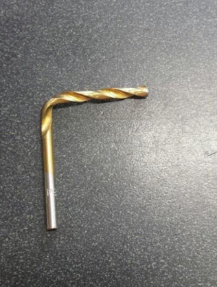

He must have been using one of those fancy drill bits designed to go around corners.
Not worth the time.
they’re the kind of jobs you spend an hour or two doing it, then turn around to customer and say that’s £90 please. They go hang on I can buy one on eBay for £30.
