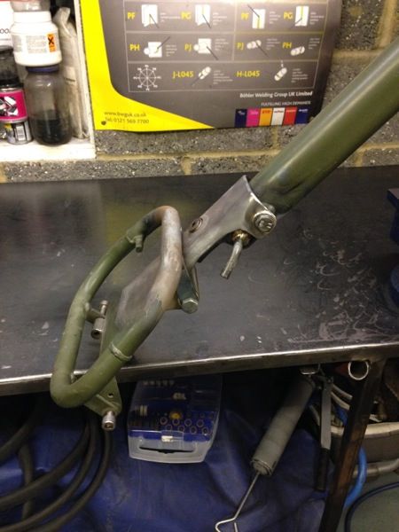

Got this machine a few weeks back but only got round to setting it up today,
Was thinking of getting this from Frost restoration but perfect timing in an Ebay email offering 10% discount with paypal sealed it,
£349 -£34.90 discount
so came in just under £315
Reasons behind getting this one was...
Preferred the power switch, regulator and gauge on the front so i dont have to keep climbing around the back as it'll on the bottom of the welding trolley.
They claim 3/8" max cut on full 40amp output,
as i rarely use more than 1/4" this should be adequate,
Also wanted a long torch lead as most of my work is cars it saves moving the machine,
6m torch & 3m earth lead,
A must have is a pilot arc on the torch which should avoid pre-cleaning of painted or rusty material.
Yeah it's a chinese rebranded machine by Eastwood but comes with a 3 year warranty,
Torch thats used takes Hypertherm consumables should be readily available.
As it's a USA machine Frosts fit a 13amp plug for UK use,
its also dual voltage, 110-240 i think?
Fitted air hose extension so i dont need plug the air at the back.
First cut on 1/8" steel, not sure what settings so tried about 25amps and 50psi air, freehand cut.
Seemed ok so tried a bit thicker,
3/16" steel, 34amps & 60psi air.
Freehand again.
After a few taps with the hammer looks clean enough after what is only the second time i've used this plasma
