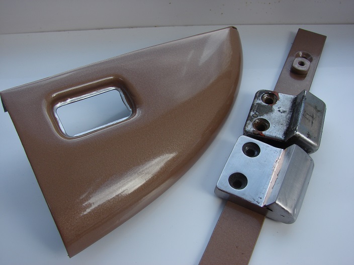

Making a supplementary dashboard for the Morris to fit a water temp gauge to the souped up sidevalve car. Spare glovebox cover from a scrapped car, trimmed down and then an MDF press tool shoved into a vice. It took quite a bit of Dremel work (and filler, but don't tell anyone) to get it looking half right. I also lost the boot catch when the chrome plater went out of business so I borrowed one and carved up some pieces of 8mm plate to make a copy. A bit more TIG filling and it can go off to another plating place or maybe just painted. Can you plate onto Sifbronze8? Original was cast brass of some sort.
