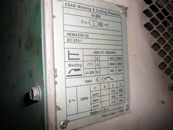

Out of interest are the big industrial Miller machines and Murex machines etc. limited by duty cycles aswell. ie. In a big factory enviroment do the welders have to let the machine rest every few mins.
