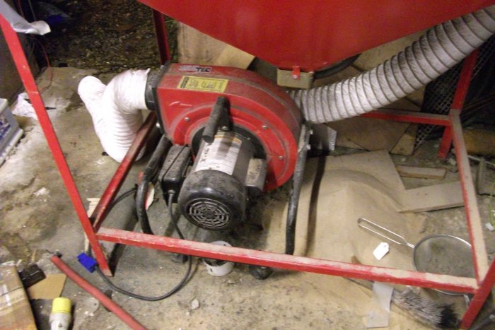

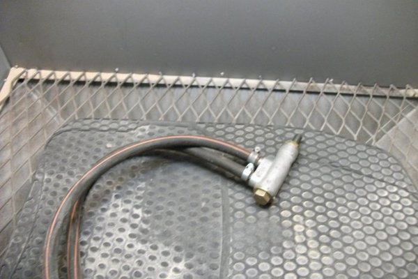

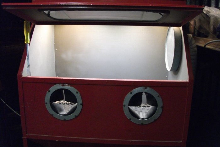

Finally got to try it out in anger at weekend. My concerns about grit pickup were unfounded no problem at all. Consistent blasting and not too much pain on the compressor.
Problem I've got is the dust. Not using brand new aluminium oxide grit may be part of the problem and I intend to remedy this.
I had hoped the cyclone system on the rear of the cabinet would extract the dust or at least keep it down but it doesn't, it merely cycles the grit back to the hopper for feed back to the gun.
What I really need is a decent dust extractor. The is another aperture on the cabinet approx 4" currently blanked off that I intend to use. What are the cheap wood dust extractors like?

Is a 1HP motor going to be enough to suck the dust out of the cabinet? I'm guessing I'll need different bags to suit finer dust.

the outlet just goes outside shed and blows away no diffrent from blasting outside
not that theres a lot mind soon sweeps up .i dont know the size of motor its not stamped on .u will be wanting to filter the dust before release to atmosphere the best bet is ring guyson up and ask what filters they sell and how many micron . they use consetina bags that shuffle the dust to the bottom keepng the filters clear all the time the woodchip ones may clog up quick
