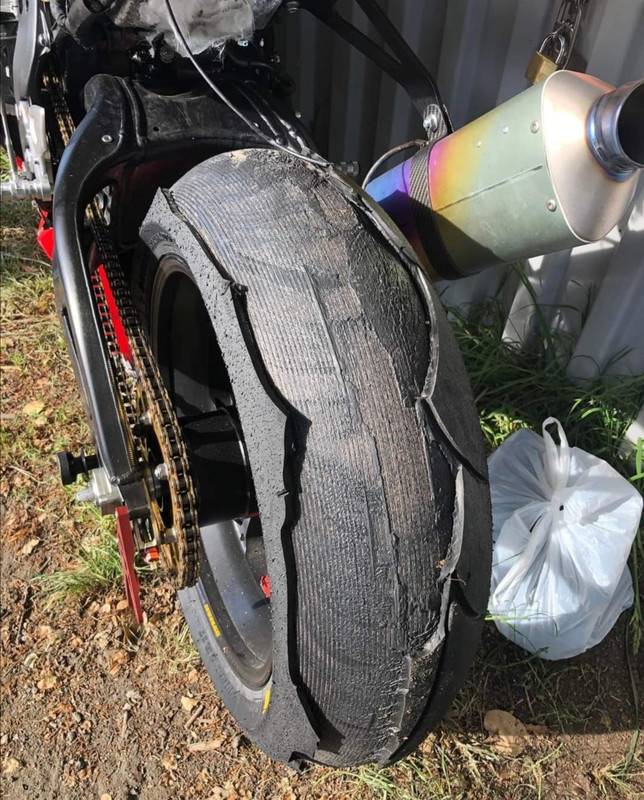

It happens
You can get car and truck tyres to do that too if you run them under inflated…![]()
If you think 22psi is low , read all of this. In fact the recommended factory pressures for my Greeves were 22psi.22psi is still very, very low. Trackday pressures as advised by the manufacturers are in the region of 29 psi, and the universal 'cover your ar$e' recommended road pressures are 36 psi Front and 42 psi Rear from pretty much every manufacturer.
