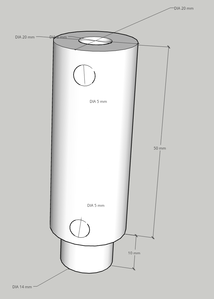

I’m looking to get an adapter made to allow me to set the timing on the wee ones Comer kart engine which will essentially house a DTI (already got a decent one so trying to use it) in the cylinder head with a rod going down to determine where TDC is and go back 4mm ish from there. Does anyone know of an adapter that exists or fancy making one (aluminium would be fine) for some beer tokens? Awful drawing below with some comments:
- Main adapter
- 20mm diameter (approx.) x 60mm long inc shoulder (+-1mm) – could be steel / alu / round / hex as long as approx. dia ok
- Bottom section 10mm long (+-1mm) and threaded M14 x 1.25 (same as spark plug)
- 6mm hole through entire 60mm length
- 6mm hole enlarged to 8mm at top for 15mm depth (approx.) for DTI to sit in
- 5mm hole through one “wall” of tube at bottom to allow engine to vent when turning
- M5 thread tapped at top hole to allow grub screw to be used to hold DTI in place (top 5mm hole)

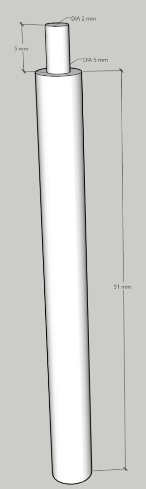

- DTI adapter / pin
- 5mm alu / steel rod
- 56mm overall (51mm main body) ideally with the end rounded for where it will contact the piston but flat would be fine if too complicated
- End reduced in size for length of 5mm and M2.5 thread cut to screw in to DTI
