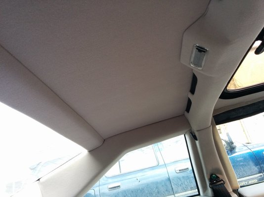

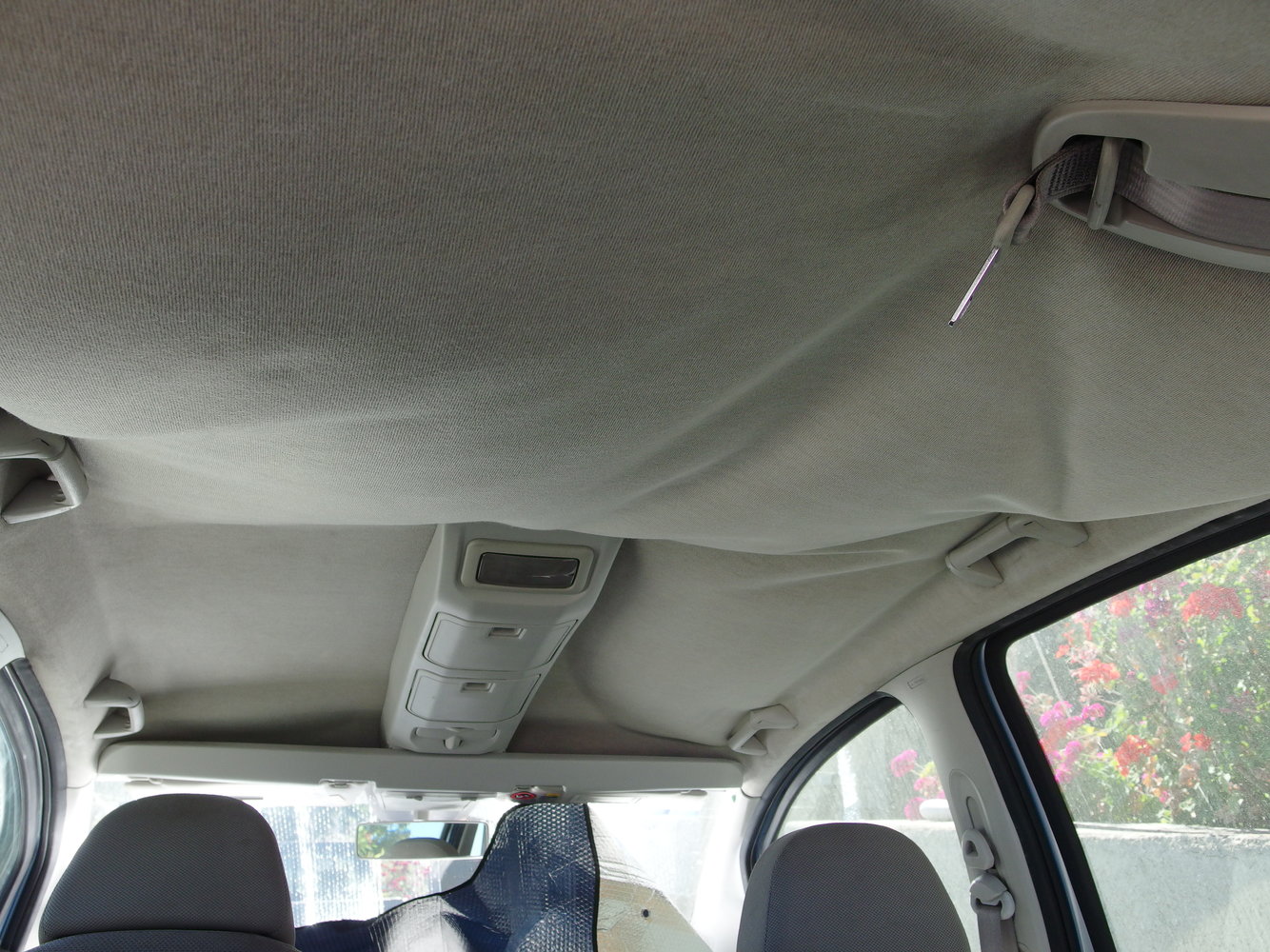

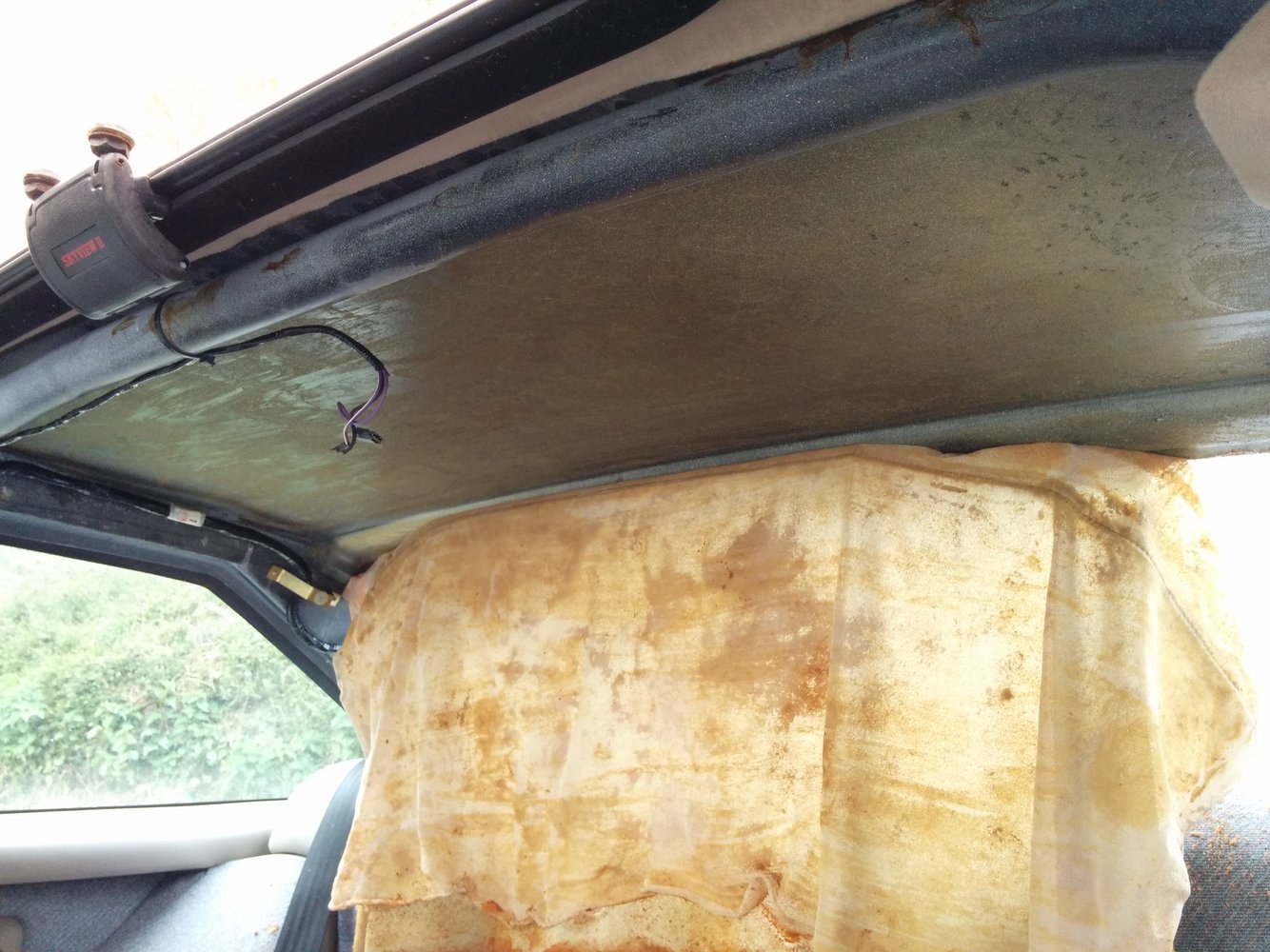

Thanks for your input keithski 122...When you say headliner board what is that like ...in my fiat fabric is or was glued to a curved or dished thing that feels and sounds like it is made from polystyrene or something ,and that is fitted into the ceiling of the car ...the bond of the fabric has failed and if I peel back the fabric from around where the centre seat belt fitting on the ceiling is mounted I reveal a dark orange sticky goo ...
The orange sticky goo is the remains of the foam. The former can be made of whatever can be imagined and I have seen fibreglass, cardboard and some sort of polystyrene. Compressed (papier mashe type) paper is what I think my Scorpio has.
