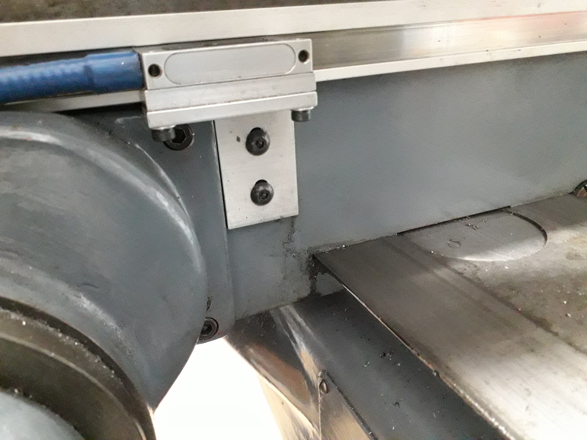

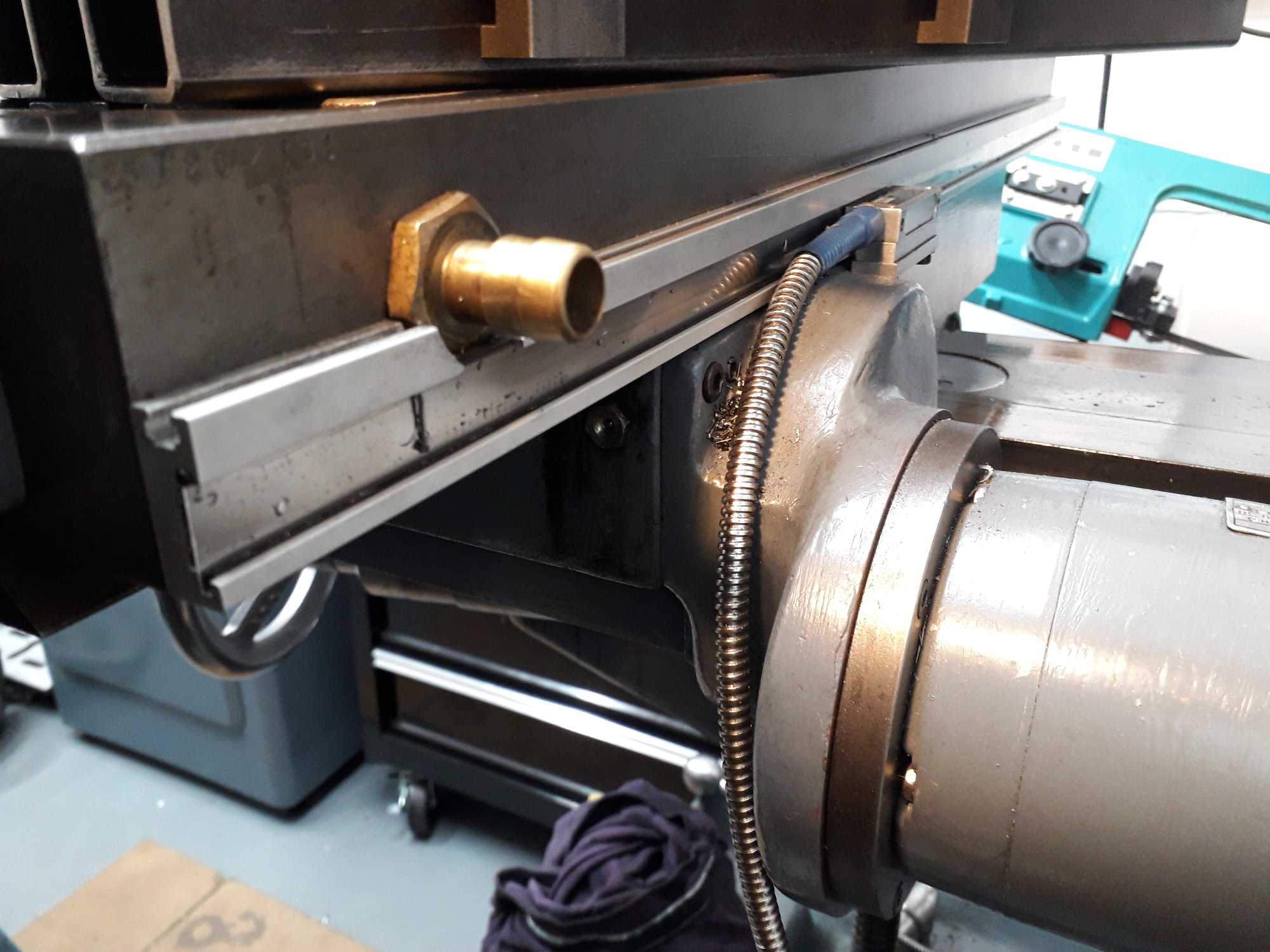

X-axis, bolted into the back of the table. Doesn't really cost any travel, as at higher knee heights the table would crash into the horizontal spindle first:

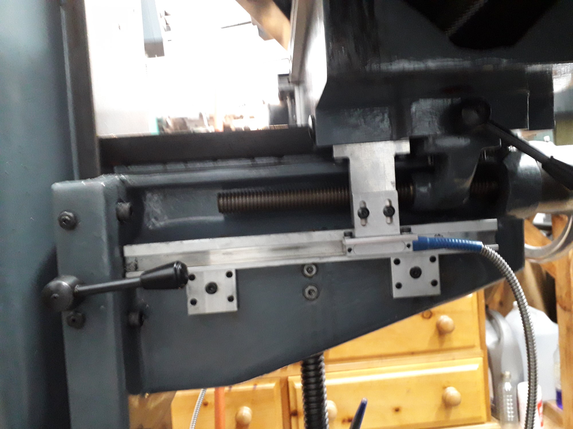

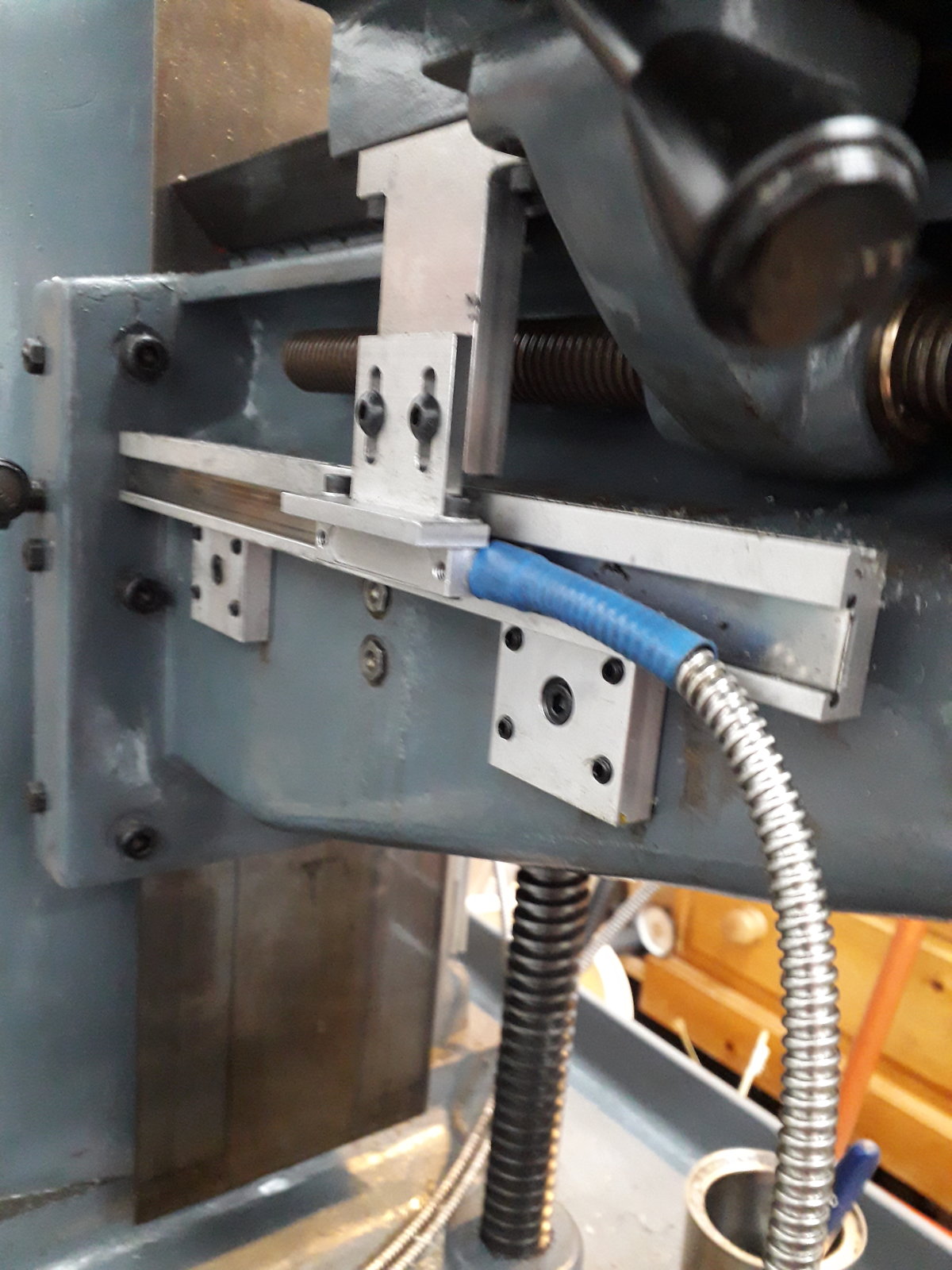

Y axis on the left side of the knee below the leadscrew. The mounting blocks bolted onto the knee casting have four jacking screws to level them. No such thing as a flat surface on these mill castings:

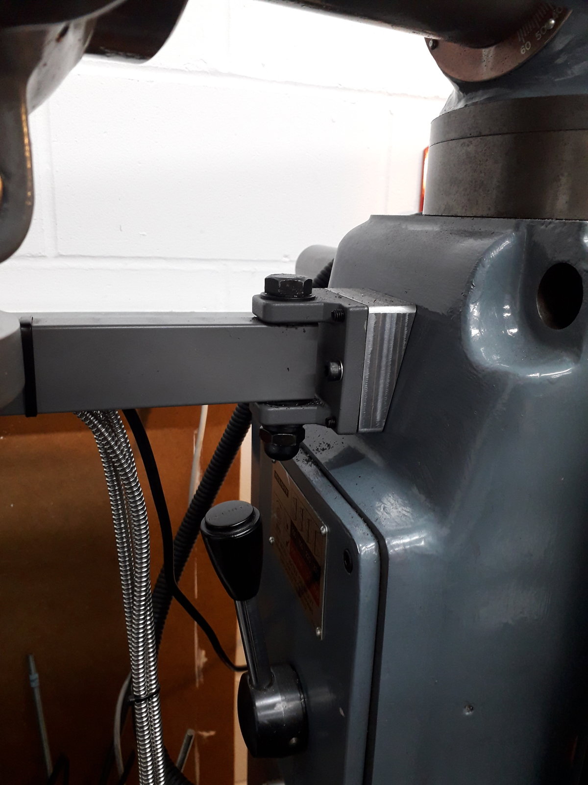

In the same position on the other side of the mill I used a similar arrangement to mount the DRO readout:
Again, these blocks have 4 jacking screws to cope with the curved surfaces.

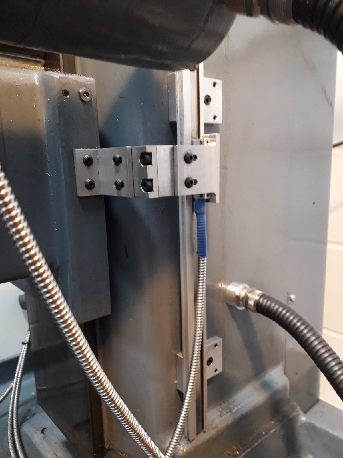

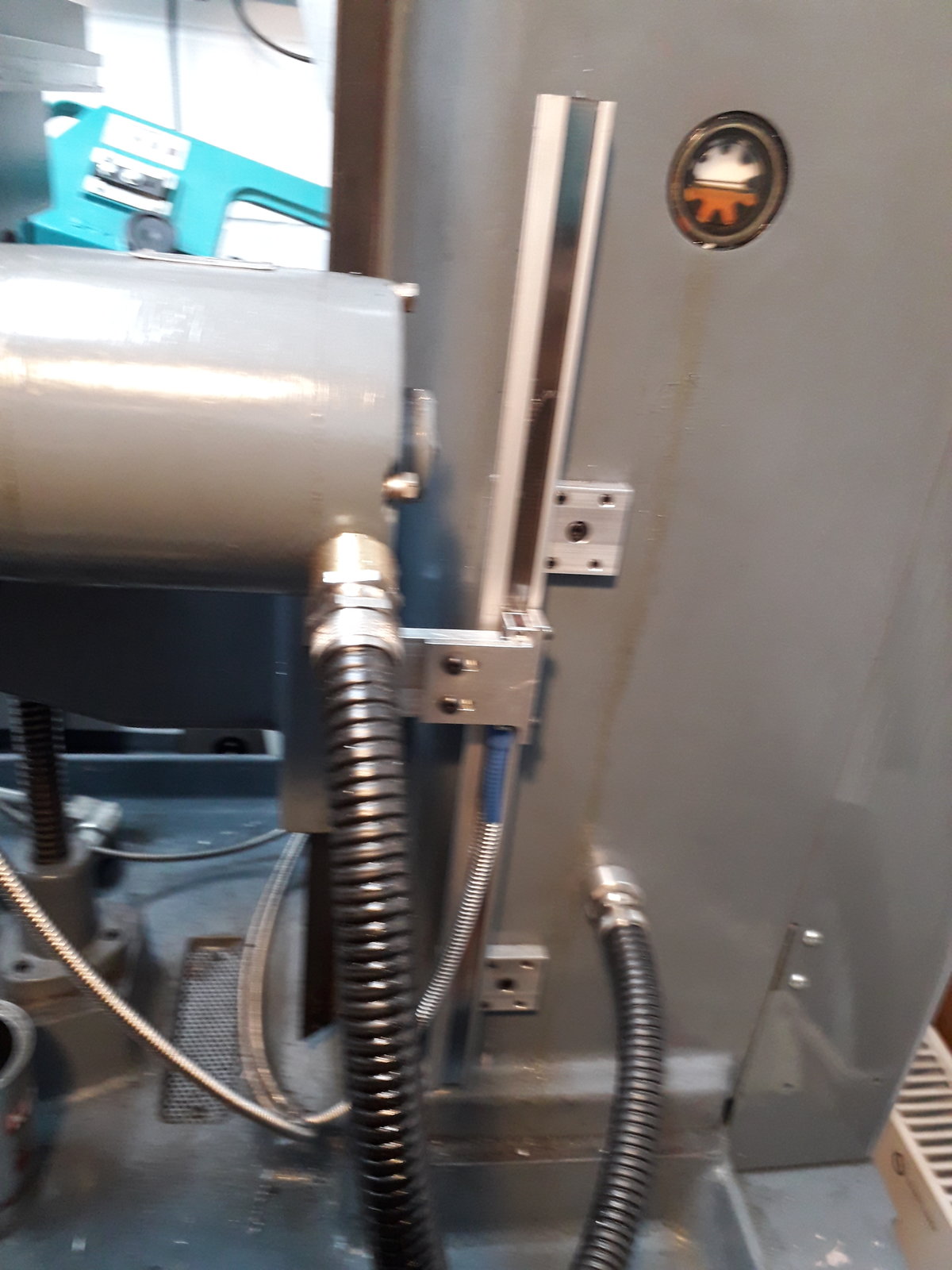

Z-axis (from the vertical spindle perspective!), on the right side of the column:

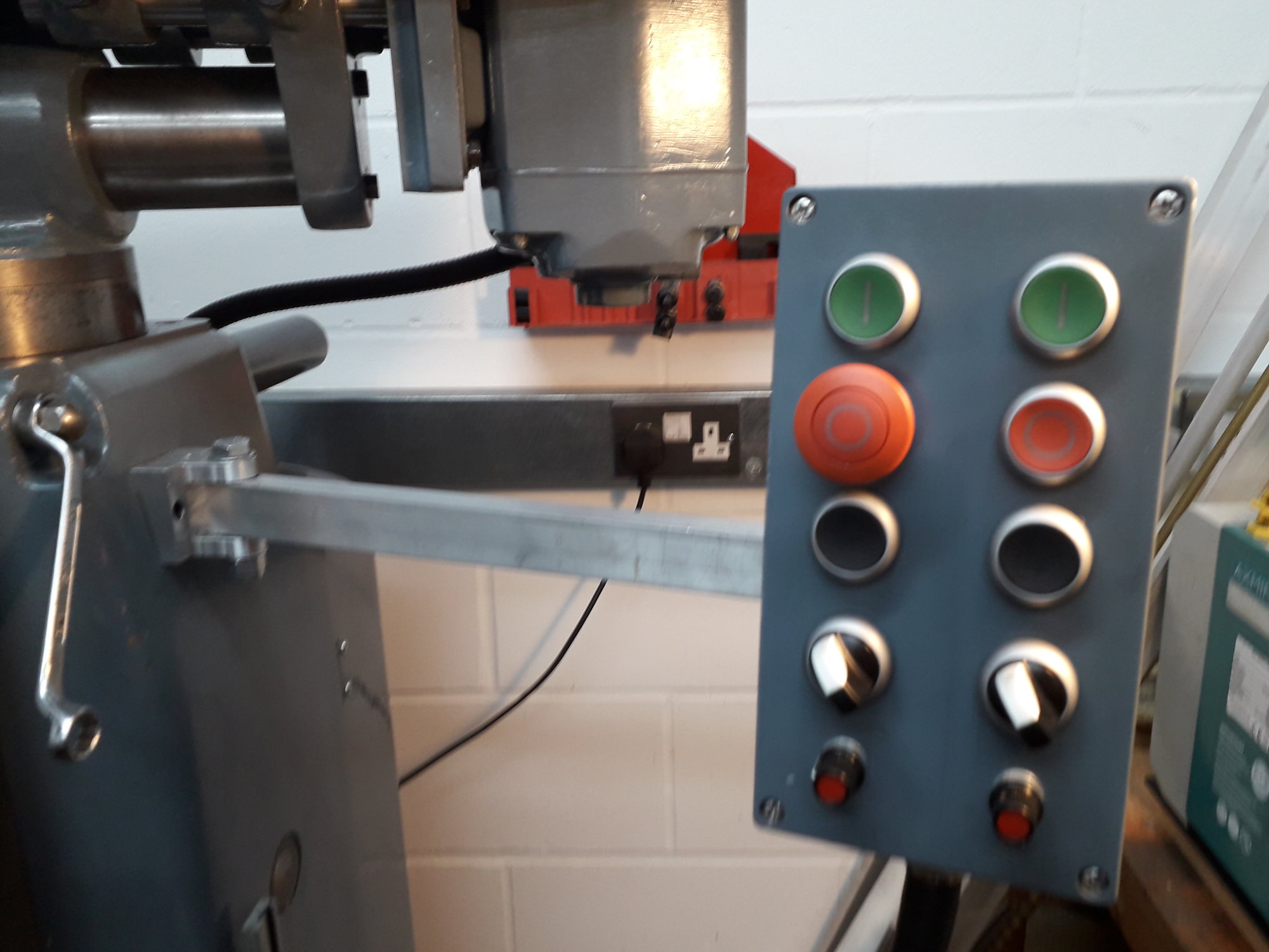

The black PVC covered steel conduit routes the power to the vertical head. I stripped out the entire mill electrics and started from scratch as 1) I needed to use a VFD to run the motors and 2) the wiring looked to me like a death trap. I also didn't like where the controls were, in the front on the base casting, so I built a box for the switches and mounted it on the RHS of the column at a convenient height:
