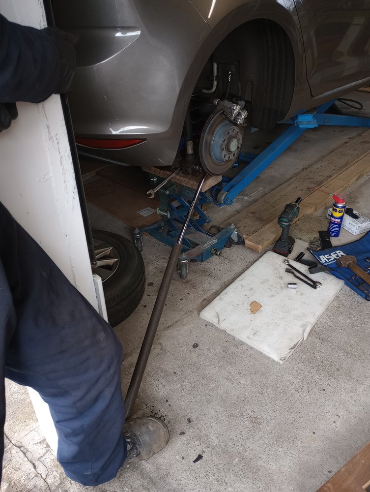

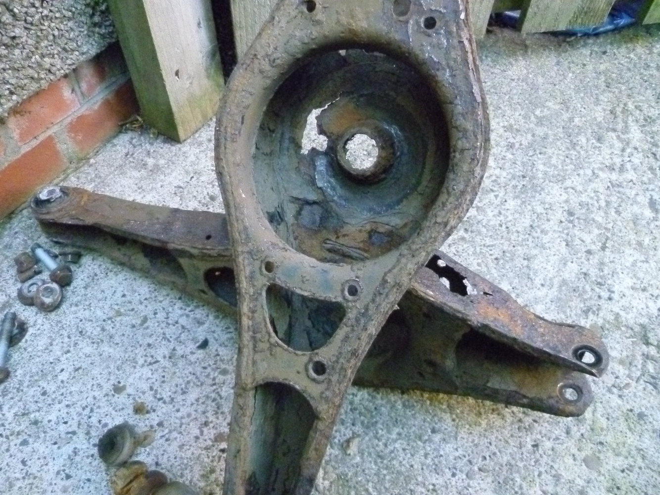

Thought I would do a quick shock change on the Golf this afternoon. Wrong!
First nut, looked a bit rusty so cleaned up the threads and got my breaker bar on it. No good withe me standing and bouncing on the braker bar. Not a budge.
Next the breaker extension.
Nope.
Felt like something was going to let go in a bad way, but still no movement from the nut.

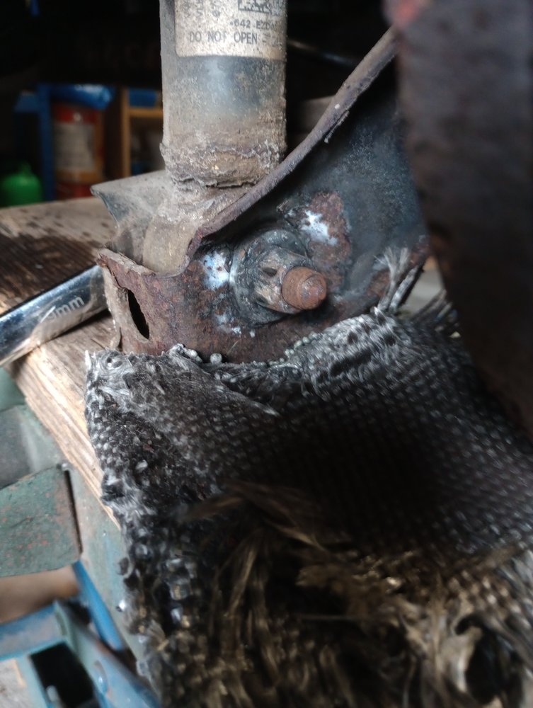

Heat, that'll do it.
Made no difference.

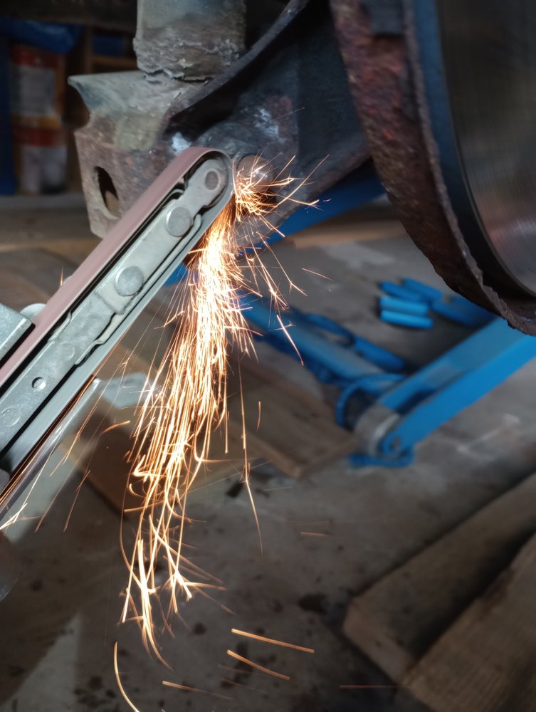

Right where is my nut splitter, couldn't find it so......
Still wouldn't come off, so more heat, no good.

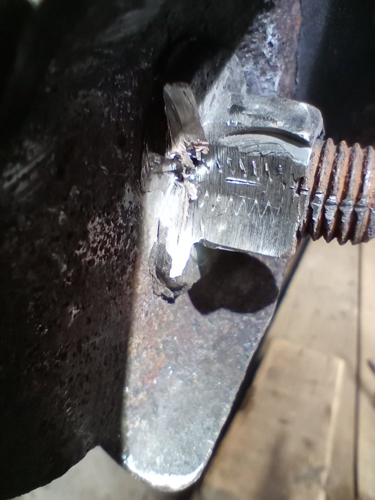

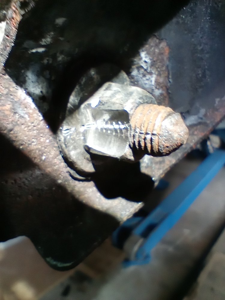

I then realised it was a top hat nut, not a washer, so ground through that too.

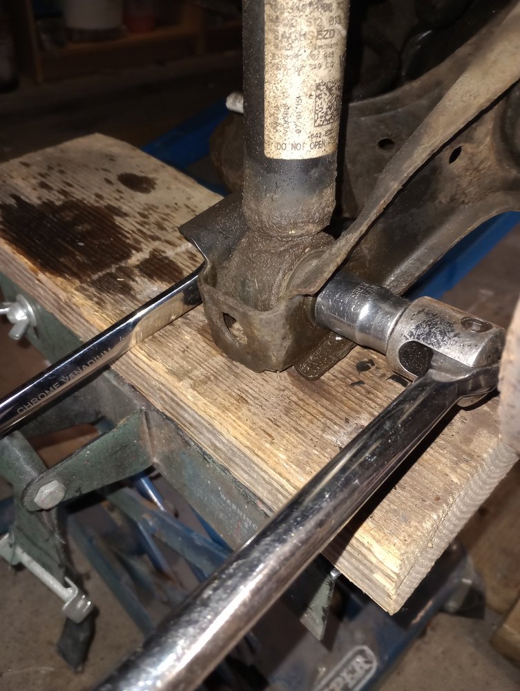

Still won't budge so gave up for the day. Tomorrow I plan to get new blades for the sawsall and cut down through the bolts either side of the shock.
Slightly concerned about the state of the subframe by the time I've got this done.
