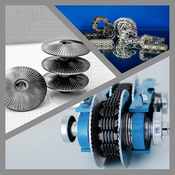

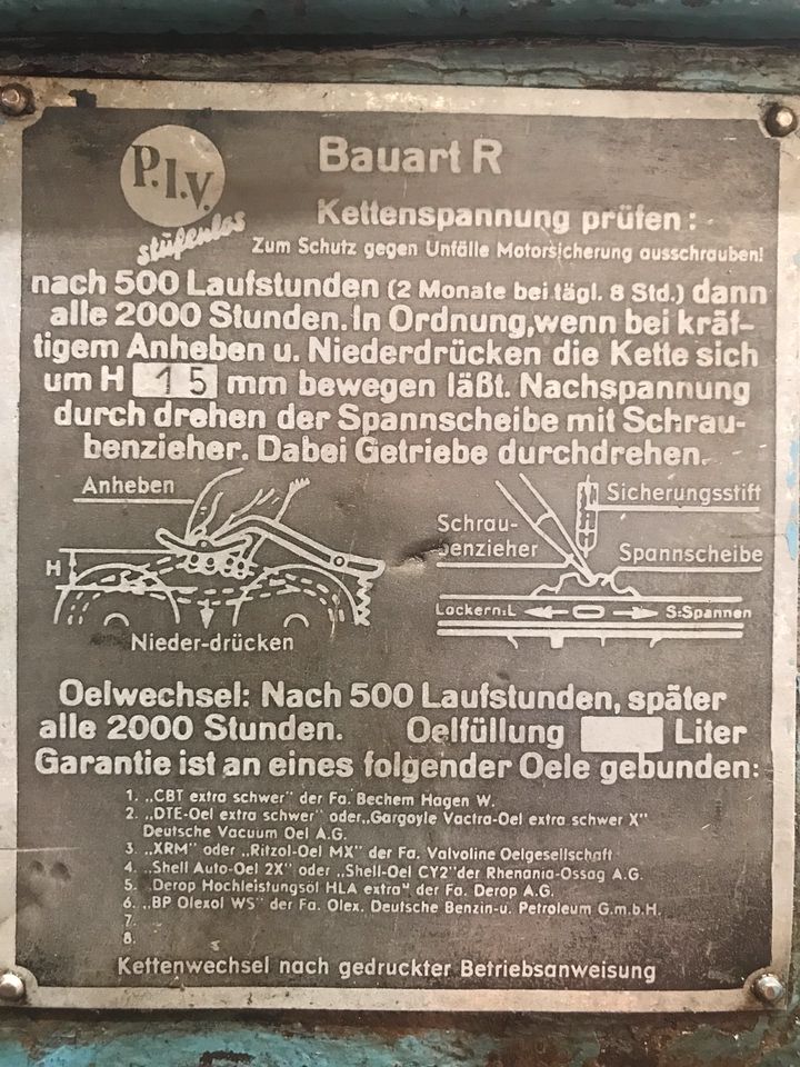

PIV Stepless chain.

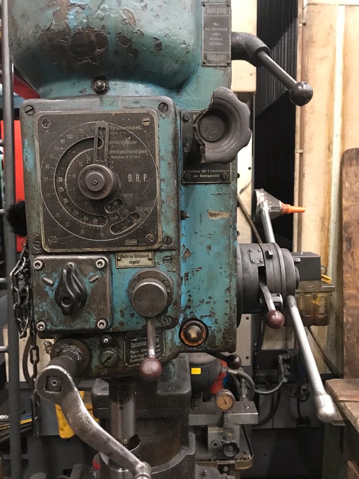

Clue in the top left photo of the maintenance plate![]()

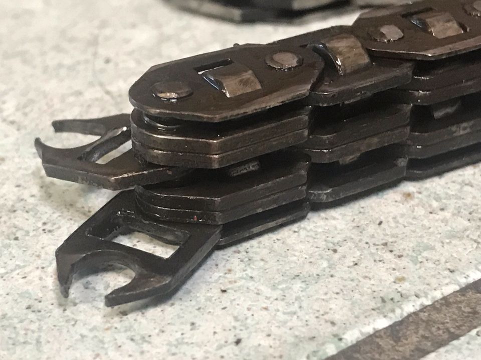

Could be wrong but that reminds me of the old ford cvt, and their many issues.
The chain from my question is for a CVT, where changing the diameter of the slightly spherical (from the side) pulley groove changes the gear ratio. Your version of the chain, for the pulley, with radial notches. I found a company in Poland specializing in such transmissions.I wondered if the ZBJ18003-89 standard was a China special, but it is also mentioned in (and thus manufactured by) SKF:
https://www.skf.com/binaries/pub12/...N---SKF-Transmission-Chains_tcm_12-242150.pdf (Page 77).
So if you can identify which of the five sizes it is, an SKF distributor should be able to get it for you.
