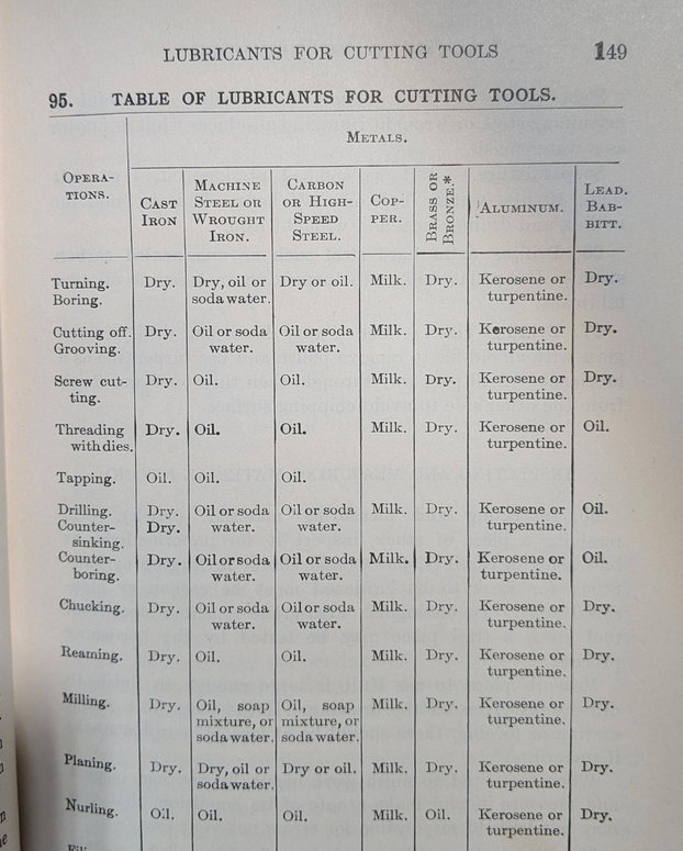

Edit to ask - what's the trick with this copper drilling - less speed?
