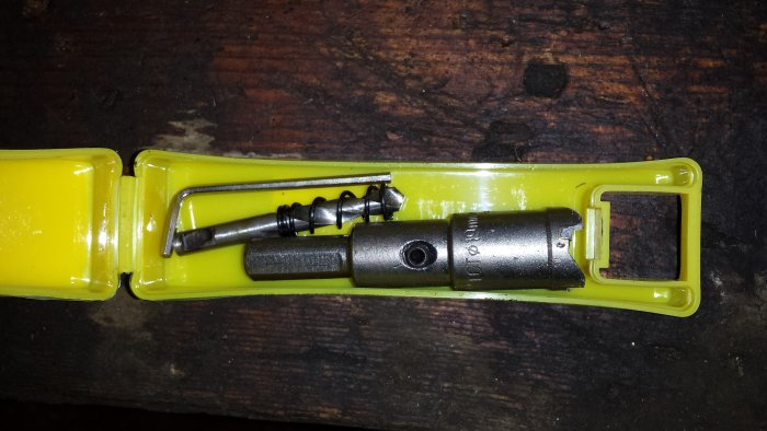

They're really designed for use in a lathe mill or pedestal drill. In thick and hard materials so once they get cutting g they are fine.
the correct wheel for tct drills and carbide tipped lathe tools is a green silicon carbide wheel http://www.axminster.co.uk/silicon-carbide-green-grinding-wheelsDo a search for locksmiths hard plate drills, you should find a good few people selling (TCT) tungsten carbide tip drills for metal. Should do the job.
verry true . depends on how much u have to spend and what use u will get out of itIf you're going to put a cutting edge for drilling then a diamond wheel is what you want. A green wheel will put an edge on it that looks like someone did it with a chainsaw, when viewed under a magnifying glass.
