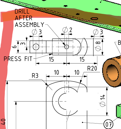

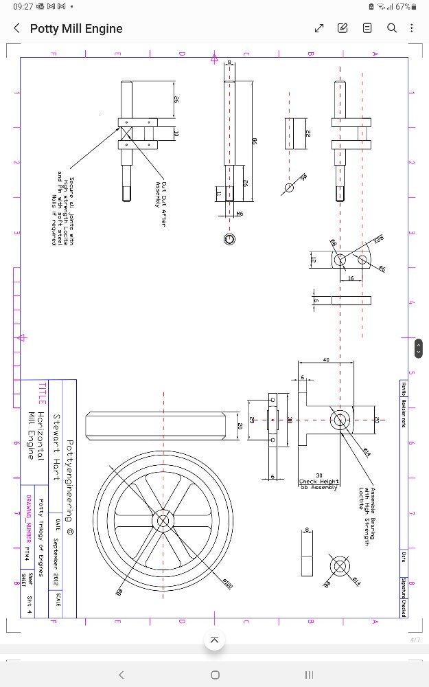

trying to move some drawings from a very hectic PDF into fusion so i have individual drawings for each component and a CAD model to refer back to as well.
problem is, on a few components you get shown a 3d image of what the component is, then a drawing split into various views...but some of these drawings arent too forthcoming with dimensions. most of them ive been able to work out from other hole locations or given dimensions, but this one has me scratching my head.
the dimension i need is the thickness of the bronze bushing, that is pressed into the (green) housing. i have diameter and bore dimensions, but not the thickness. any ideas on how to determine this otherwise its going to have to be a suck it and see type of deal when i get round to assembly and given its likely going to be sub 10mm thick, re-chucking to skim could be interesting
