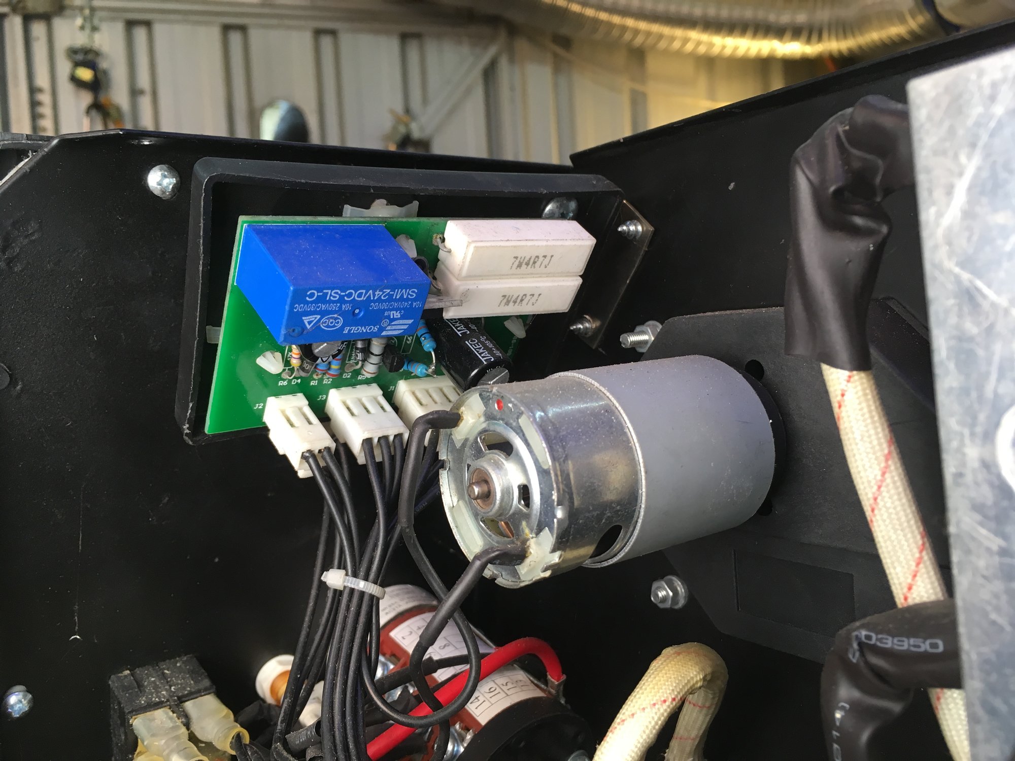

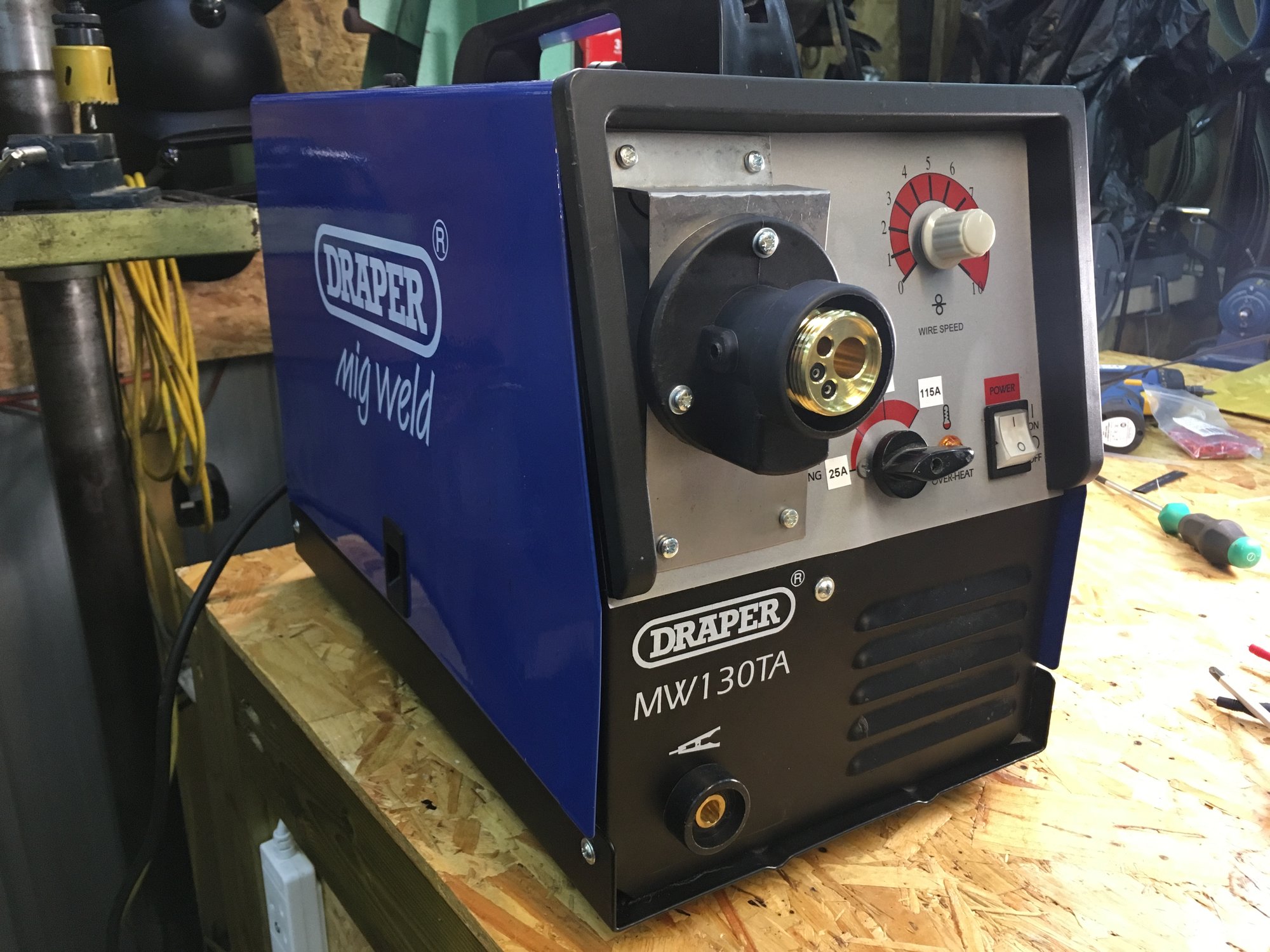

so this is my backup welder now since i just brought a inverter mig.
not a lot wrong with it
1 needs a new liner
2 the gas velve on torch leeks
3 trigger only works when it feels like it

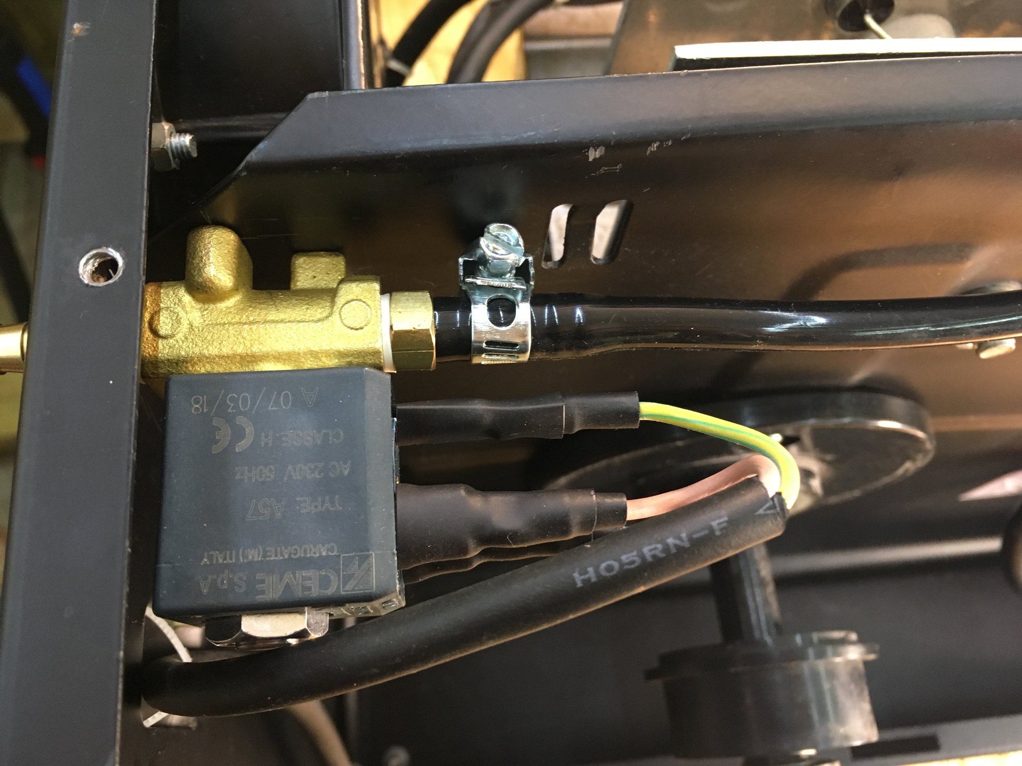

So i would like to add the gas solenoid and euro conversion.

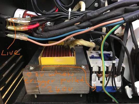

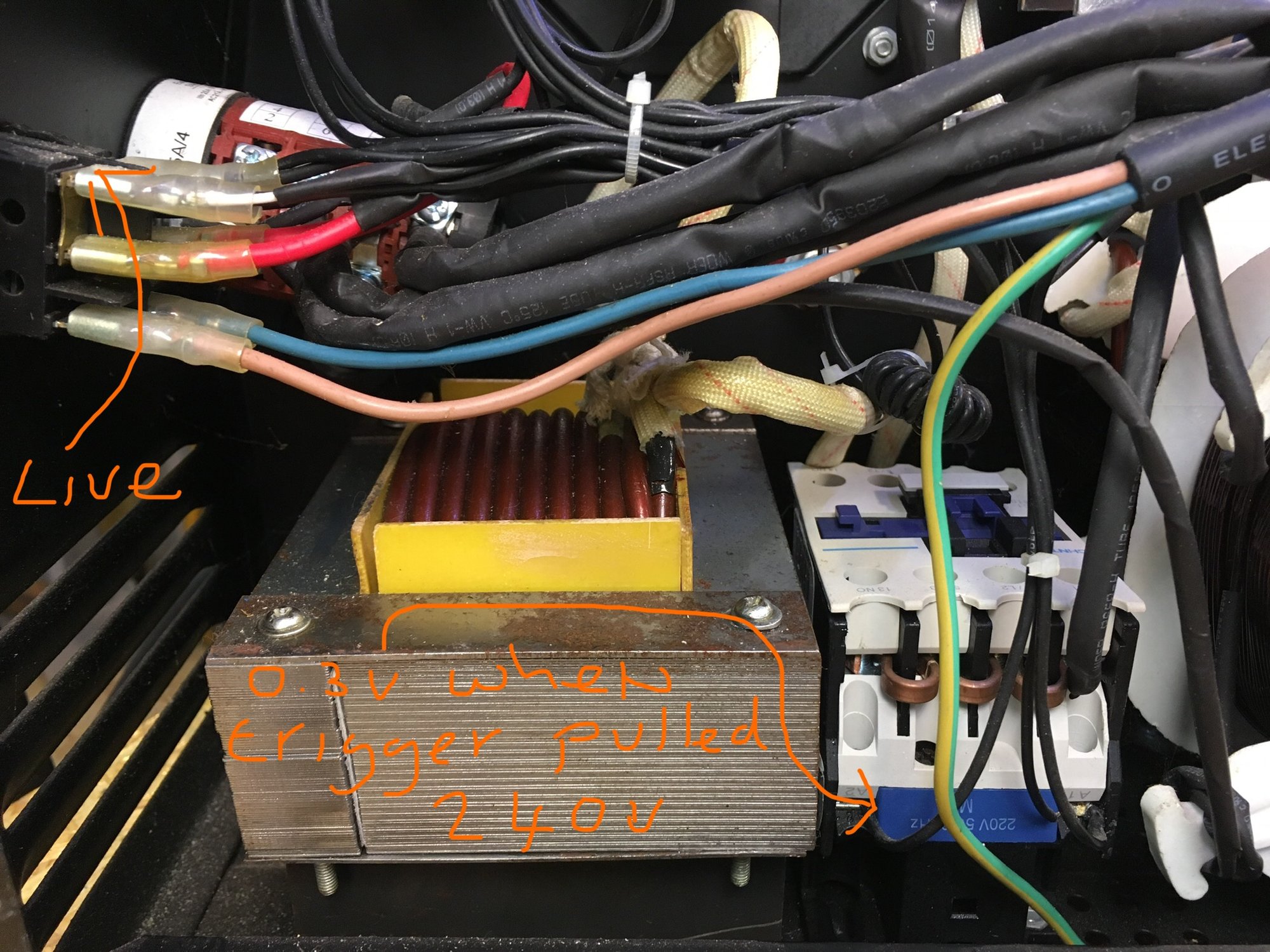

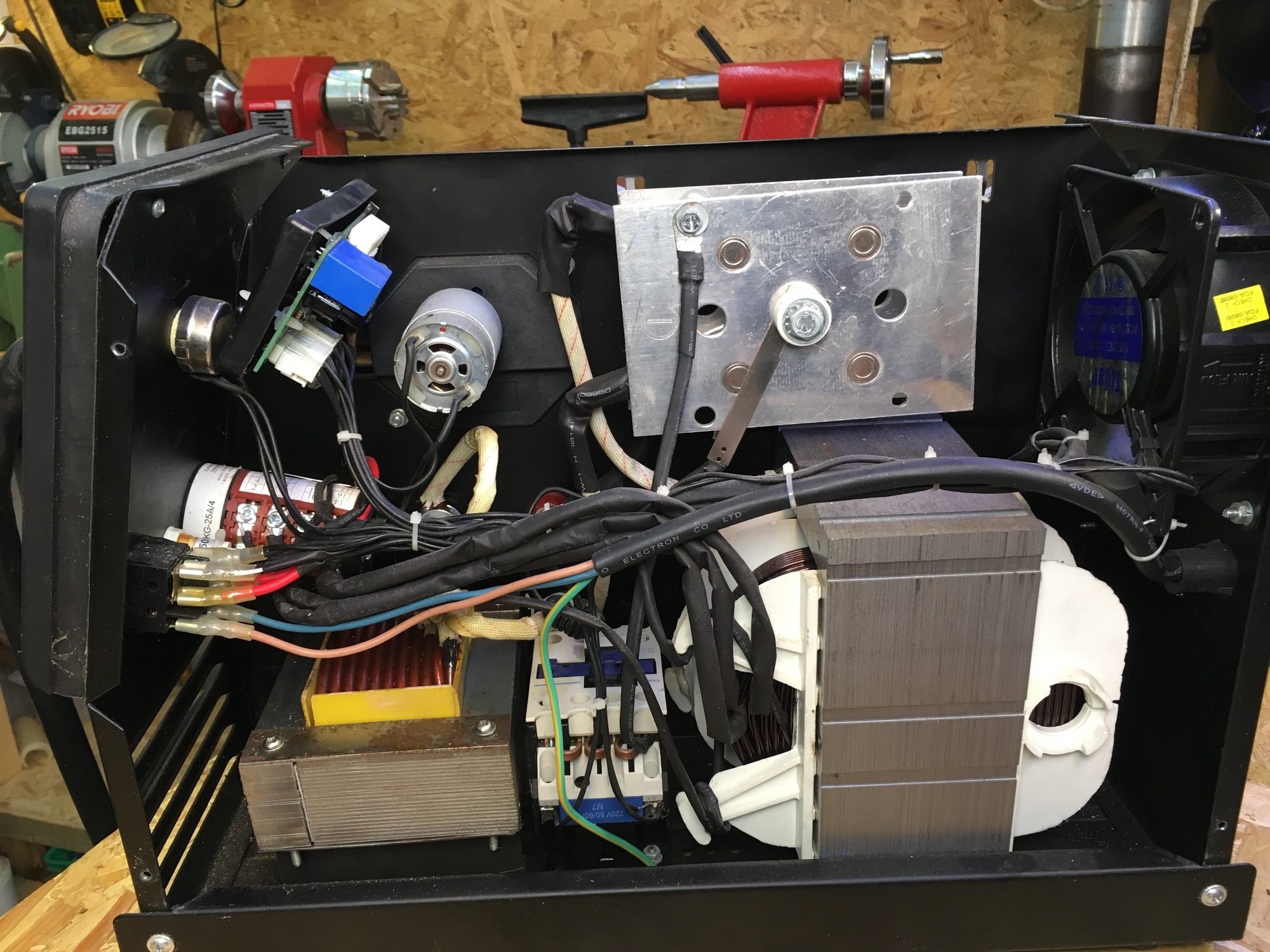

In the bottom pic live comes in to the switch, Then down on the contactor is 0.3volts when trigger pulled i get 240volts would this be the place to connect 240v solenoid
Thanks for any help, much appreciated

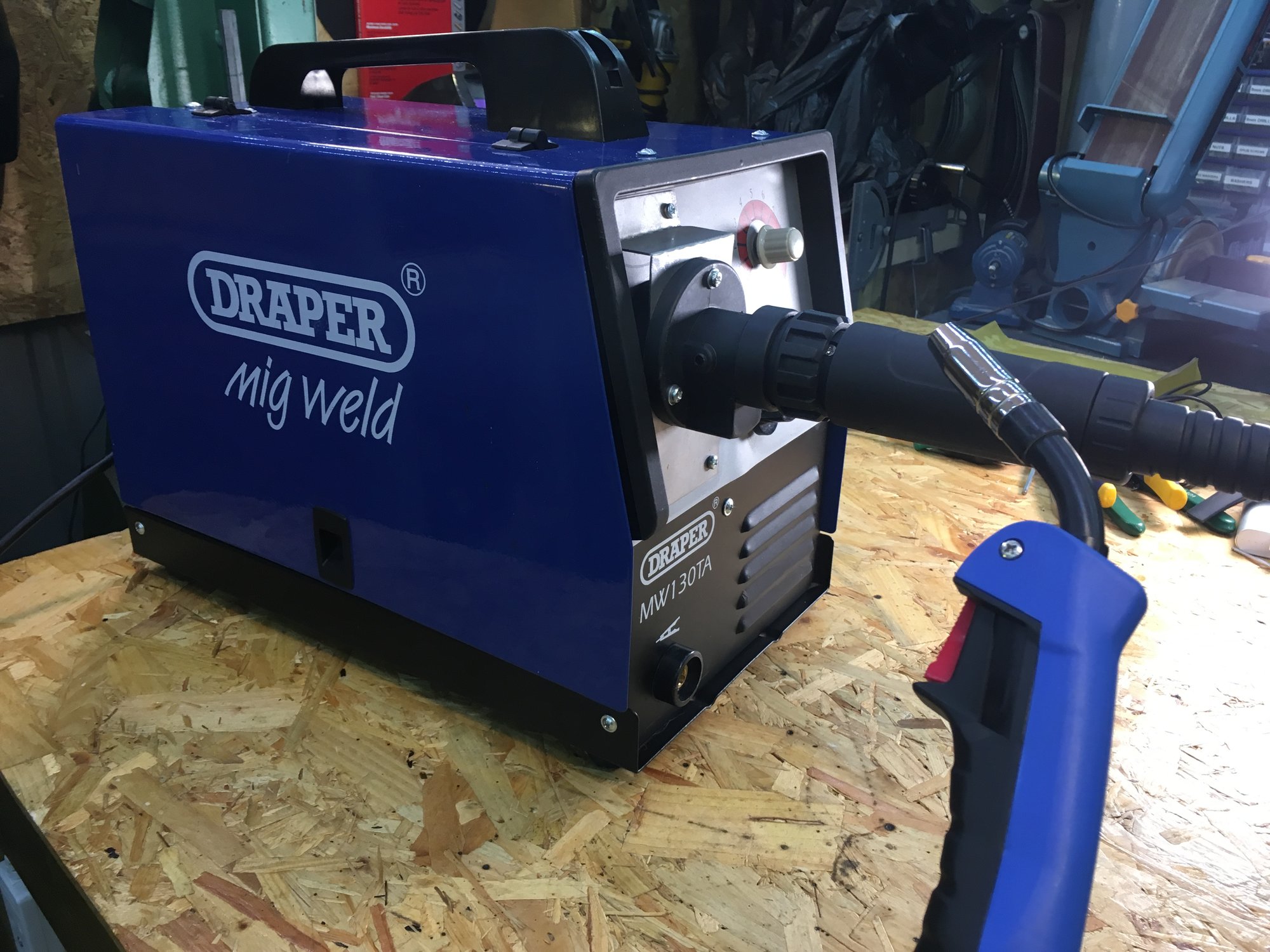

) so don't know if you had indicated if you have a 3 or 4 meter euro torch ? Because you still have the original feed motor it may struggle to feed smoothly down a 4 meter torch. May be better with a 3 meter one and try to keep the hose straight to help the motor out.
