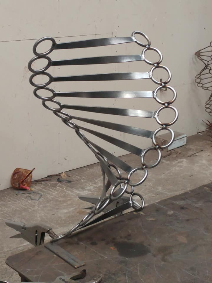

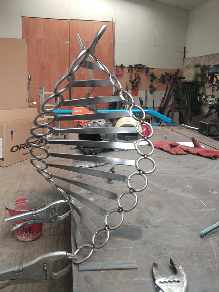

Day 1
Day 2
Pretty good progress, it seems to be staying straight and developing a lovely helix shape.

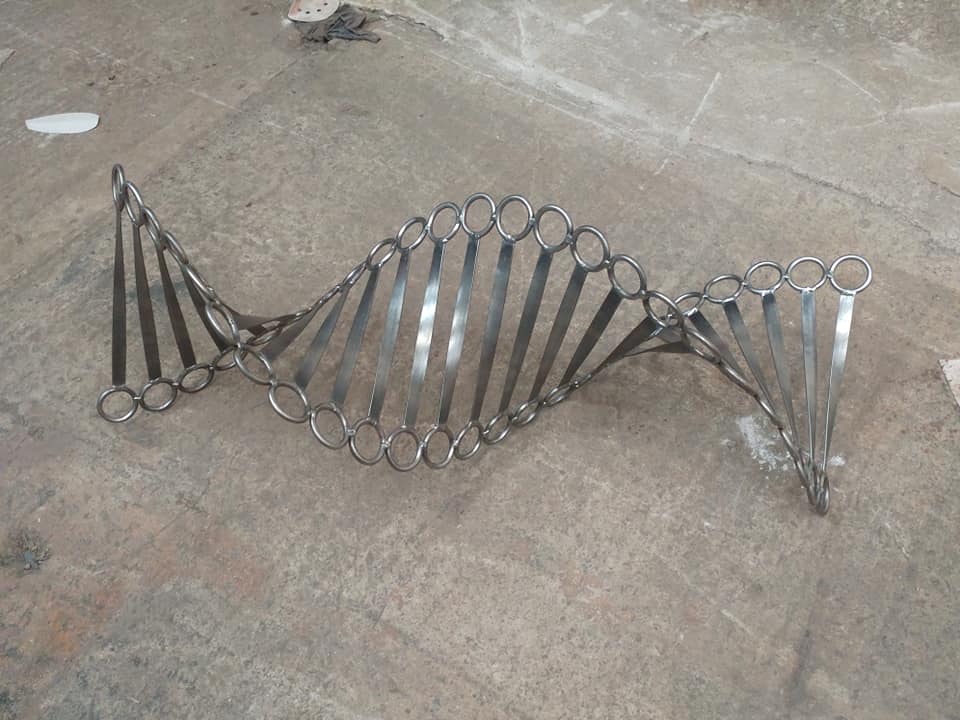

So far so good, a day to make the rings and a day and a half to make the first metre of the sculpture.
Day 1
Day 2
