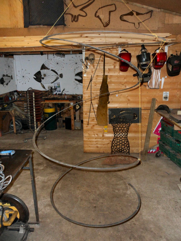

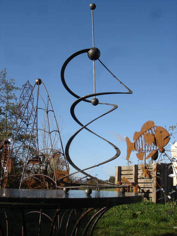

I was recently asked to make a collection of spirals by someone I think is a time waster but I came up with this.
About 1m in diameter, made of 15x3mmm strip rolled up flat on it's edge on my powerbender. It works a treat but would sag horribly if any heavier. Hence the strings.
You could do it in flat strip rolled into a coil, roll it flat them stand on the bottom and lift the top coil and it will open up to it's finished shape like this.
Edit, this was bent up on it's flat edge as well.
Could be scaled up and opened put with a forklift.
I am sure it would work rolled edge up, then opened up vertically as well but not tried it.

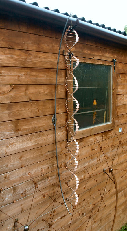

Designed and made by one the customers to my sculpture classes.
The double helix I made is here.
Made of chains of pennies with short bars linking the pairs.
Fabricated as a series of barbell shapes and welded together. Not saying ho i did it, that is the challenge.
