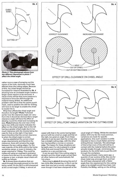

I bought a set of Dormer A002 drill bits after years of buying cheap drill bits.
Having an odd problem when drilling sheet metal only experienced when using these Dormer A002 bits.
Initially it drills fine into the sheet metal, but as it gets to the end of drilling when the drill bit is about to cut fully through the metal to the other side, the drill bit seems to get caught and suddenly pulls the drill with it as it turns through the metal and ends up twisting and ruining the metal.
It doesn't do this if using a wood backing when drilling, but sometimes you can't use a backer.
It's just odd as I've never had this problem before, would it be better to get a good set of step drill bits for sheet metal?
