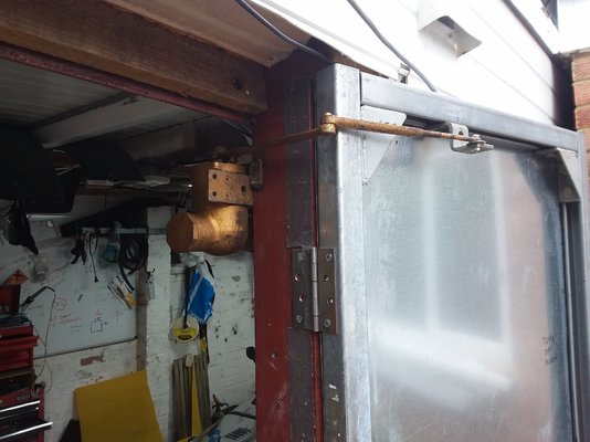

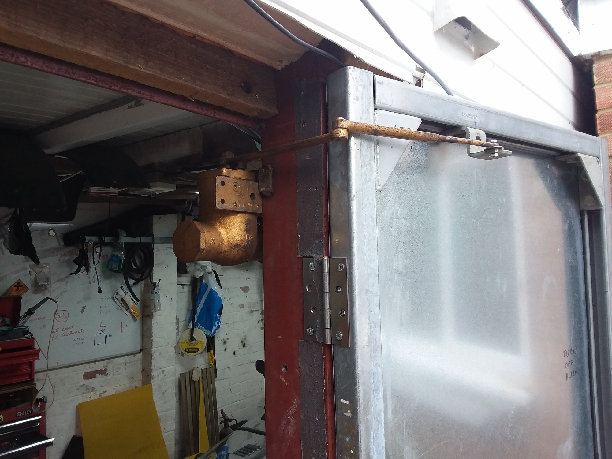

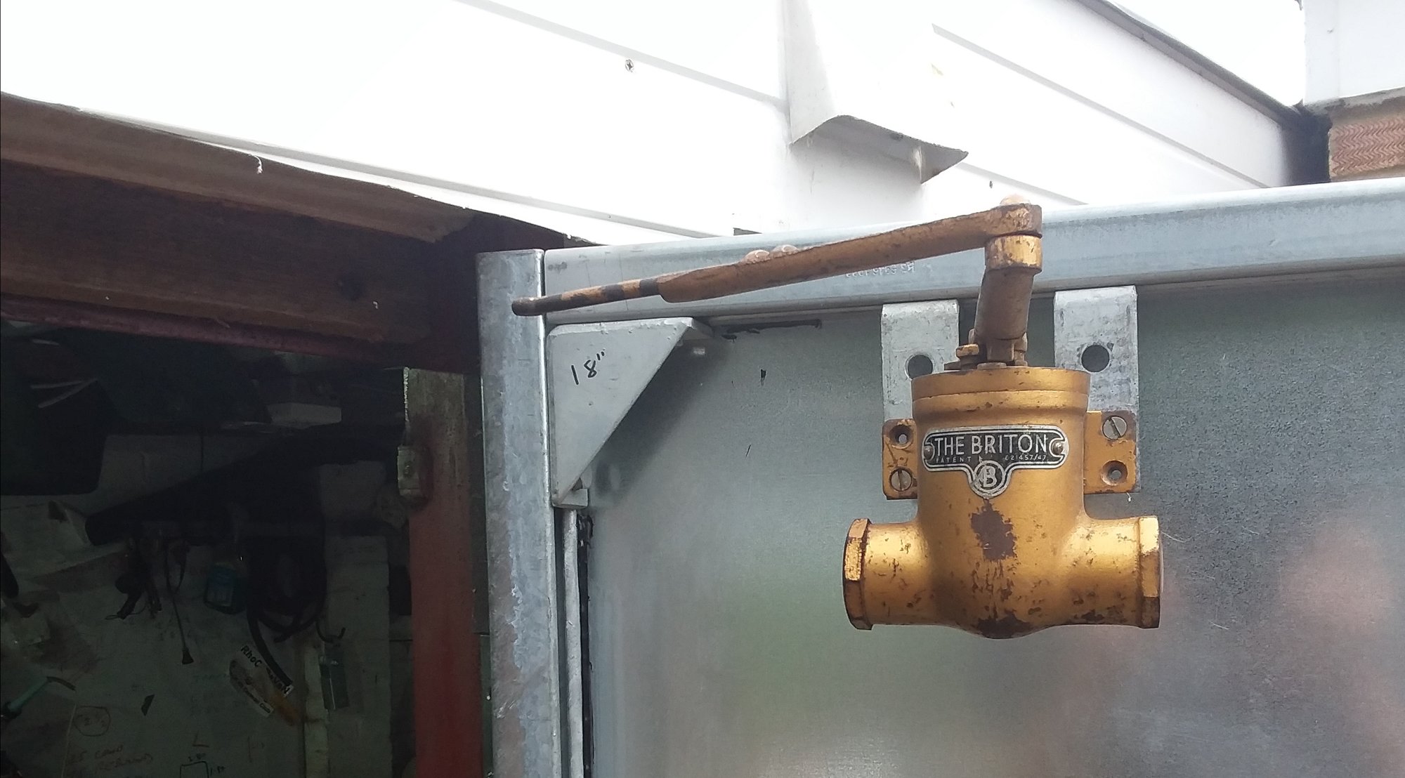

It can be done that way as I had one mounted the same, you'll need a bracket for the frame for the are to screw ontoView attachment 252069

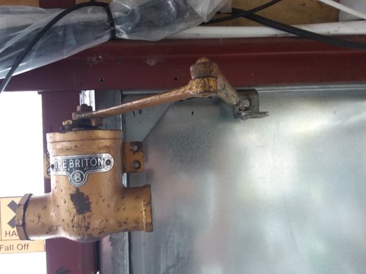

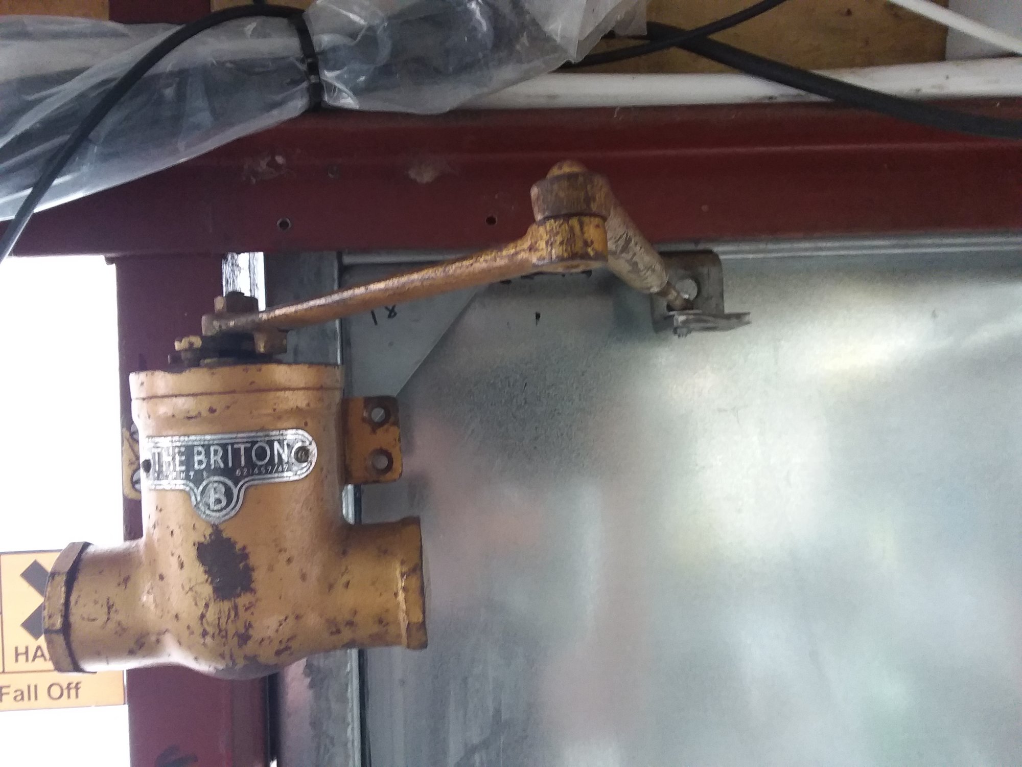

i got a britton door closer....
cant seem to get it to fully close the door
have looked online and seen them close an outward opening door from the inside
are the old brittons the same? anyone know the correct positoning?

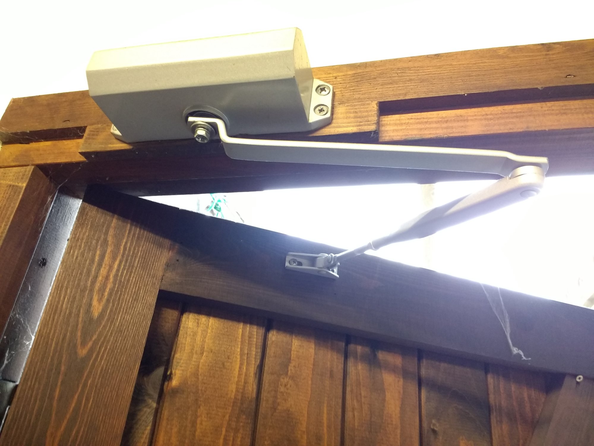

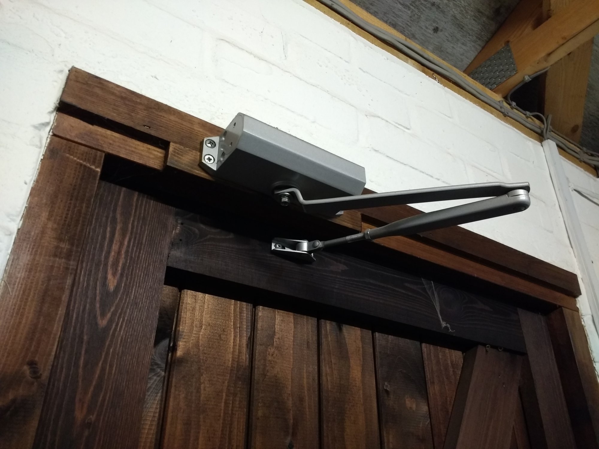

Shouldn't it be mounted the other way, i.e. with the closer at the door jam end?![]()
that would make the name upside down?
]Well done!certainly not as designed, but allows the door to open as far as it needs to
and it shuts
