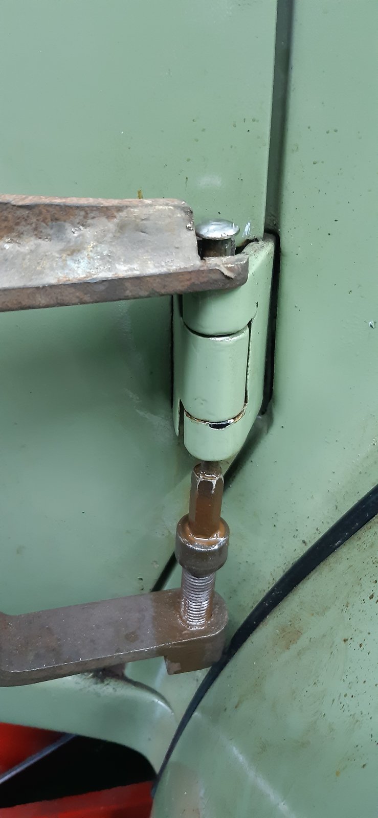

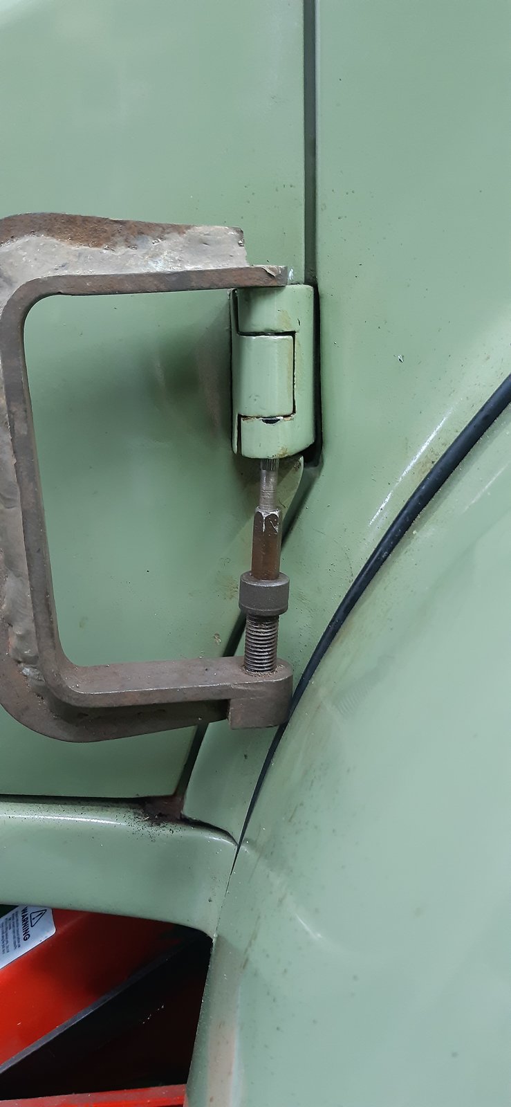

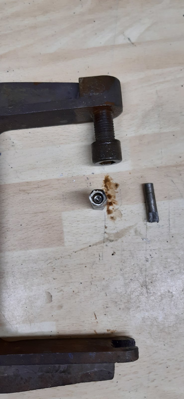

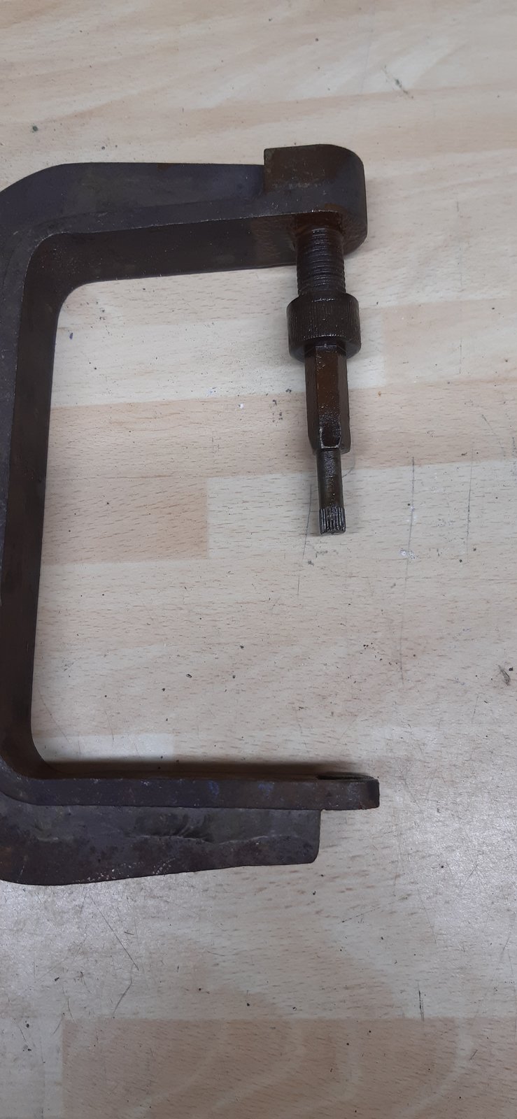

Been clearing out lately, an old clamp i mad as an apprentice went in the scrap bucket. I used it once, modified to remove some valves from an imp cylinder head. There it lay for some 40 years never used, but today it got resurrected ! Hope the pics tell the story as i only had the original BSF socket head screw to work with ! These pins are notorious for being well and truly stuck !
