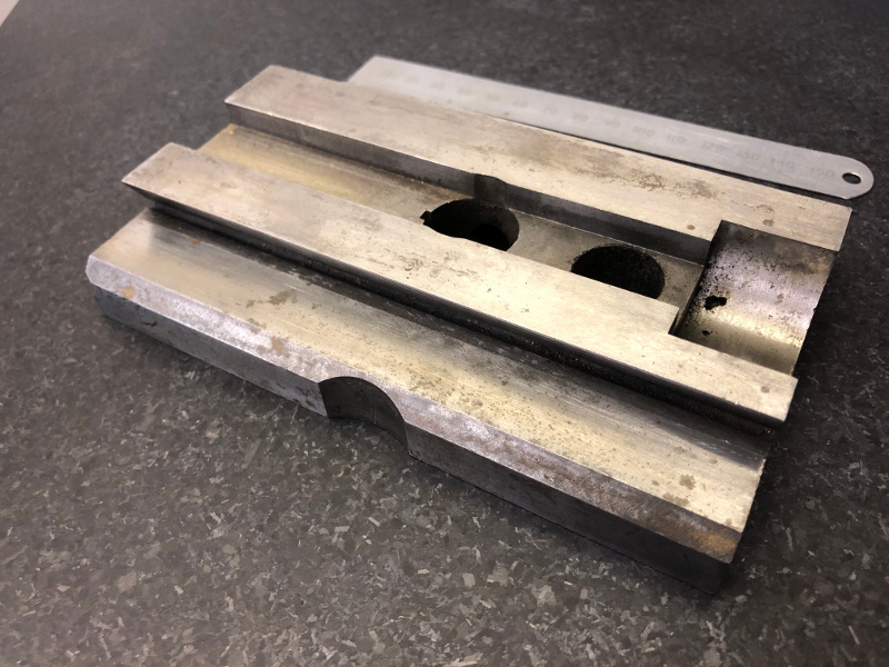

Here's an example of why you can't judge a piece of equipment on looks alone. I'm scraping the sliding parts on my HLV, cross slide and compound slide. As usual I scraped the bottom faces of the cross slide first so that I could use them as a gauge to scrape their complimentary ways on the saddle. After that I did the same to the compound slide. The base of both had the typical small amount of wear on the ends. Easy to scrape and they came out fine.
Then I came to do the base of the compound. Here it is, looks in pretty good nick apart from a little staining. A couple of tiny scores not worth worrying about and if you needed one and saw it for sale you'd probably buy it based on looks alone.

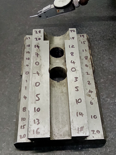

Looks aren't everything though because I went to blue the base and it only touched in the middle. That's not unusual, you get burrs and raised edges which cause that kind of thing so I de-burred it and the result didn't change so I thought I would map it out with a dial gauge and see what's what.
The thing is bent like a banana. I'd already made the base flat so I could do this test which took a good couple of hours scraping in itself. So the flat base is against the plate and the numbers are 'tenths' (ten-thousandths of an inch). The middle is the lowest point and the edges are raised at least two thou each side. The base was the same so anyone trying to use this to take decent cuts or parting off would have been fighting a rocking compound and probably all sorts of chatter, in fact the locking bolt was so tight it sheared when I tried to remove it. Someone had tried hard to stop it moving about.
The lesson is - just because it looks good, doesn't mean it actually IS good.
