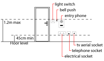

I'm just about to extend the upstairs ring main into the extension. I'm doing the cabling, a spark will be wiring them up.
I forgot to ask a couple of questions and my spark is on holiday.
The extension is a bedroom, I seem to remember that there are now rules about the height from the floor of the socket?
Also, the T&E is going behind 50mm insulation backed plaster board that is fixed directly to the wall. The cable pokes directly up from the floor void to the socket then back down to loop to the next socket. Do I need capping over the cable between floor and socket? If so do the rules state plastic or metal capping?
In both cases it's the regs I'm interested in so I can get the cable in and plasterboard on ready for the spark. I've done this before but that was 17 years ago and things change
