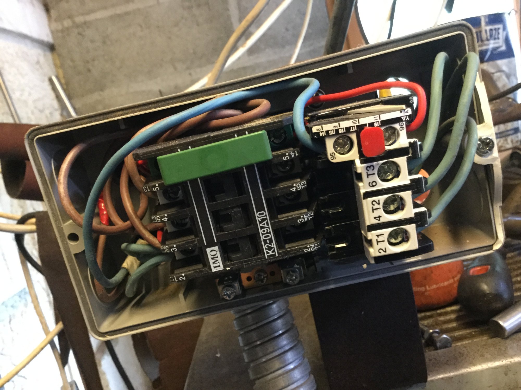

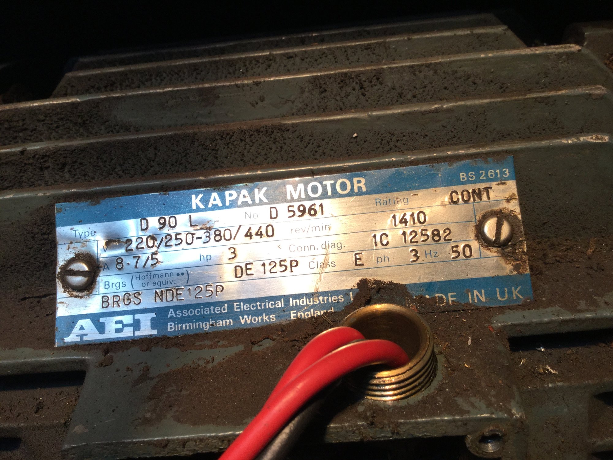

I have a 3hp-8.75KW motor fitted to my lathe and the Dol starter push button switch is just buzzing when pressing the green button for start.......
the starter switch says...IMO (manufacturer) K2-09A10.......no other details......
had the cover of and all connetctions are tight and the overload pointer is on max.....plus nice and clean and dry inside the box....
So, found a starter switch on the bay.co.uk, item no, 331229135855
described as coil voltage 440volt for 3 phase and I've selected 12-18amp as overload voltage.........
is this the correct thing.......
the old switch is prob 10 years old and has had a hard life but now have a clutch fitted to the lathe so the switch gear will work less........
am asking as this item will have to be couriered out of the UK so need to get it right first time.......
is there anyone who can help.....no where here to go for help.......
thanks.
