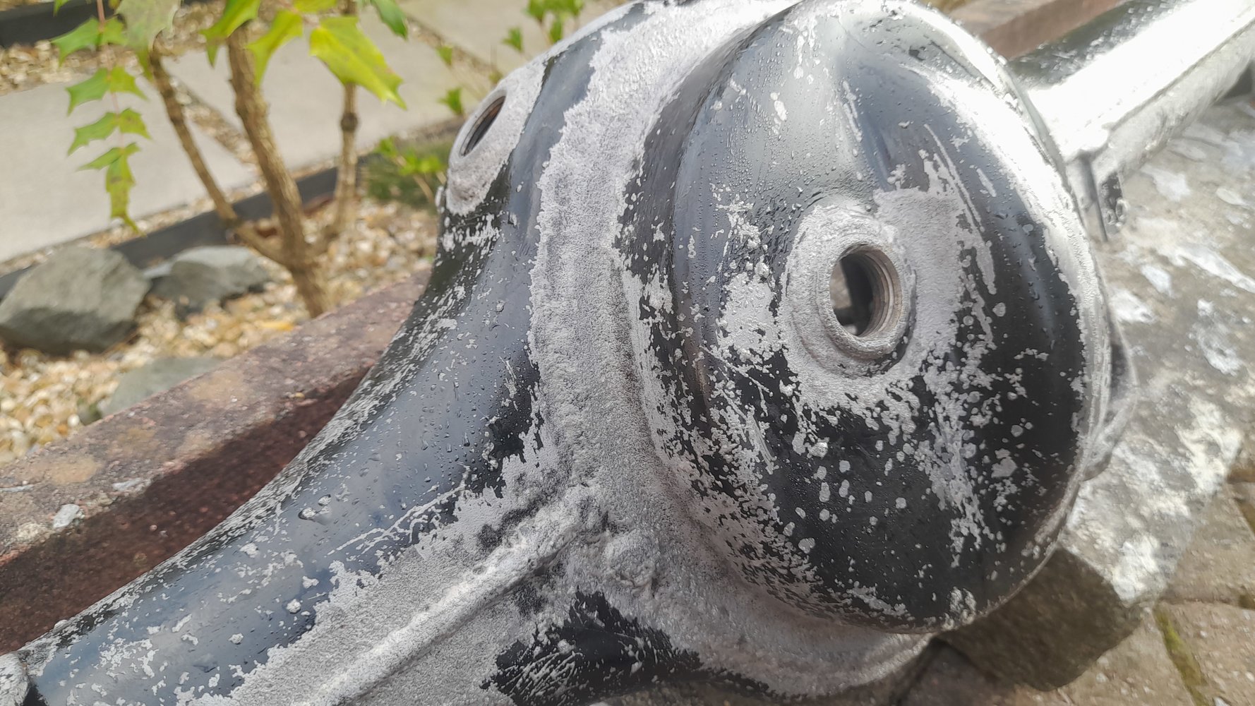

Citric leaves a protective oxide and I find it is best wiped dry rather than rinsed or washed off. Ive got parts left outside over a year since, with no significant rust.Electrolysis leaves a black oxide finish that mostly is removed by pressure washing. Before painting I like to give it a rub with a coarse scotch pad to remove any remaining oxide.
Citric leaves a similar finish plus it goes sticky if you don't wash off the citric before it dries!
Sorry, but I find it hard to believe that citric (generally) leaves a protective oxide. The whole point of citric is that it creates reaction products which are soluble, the very last thing you want for a protective film. Phosphate makes insoluble, protective films.Citric leaves a protective oxide and I find it is best wiped dry rather than rinsed or washed off. Ive got parts left outside over a year since, with no significant rust.
