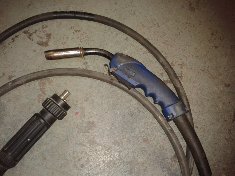

Morning all, i'm giving my mig a service and some tlc. I'm after a new shroud for my gun but I don't know what make it is. It's about 20 years old and says "made in great Britain" . My brother thought it was a Bernard. Any ideas?
I think those on the link are different. The contact tip on mine is not a screw in but rather a cam lock design (bottom of tip is oval) and the shroud is screw on instead of spring loaded push fit.
Thats pretty old school, my local supplier skipped all their cam lock tips when they moved premises, I ended up buying a new torch in the end! There must be some on t'internet somewhere though. I liked that system cos you can adjust the tip length for different jobs. Sorry I dont reconise your torch mate but if you find a supplier can you post it here? Best of luck!
Just been to pennine welding supplies in Leeds and they do all the spares. The man said it's an early parweld pxl 280.
Got some more cam lock tips aswell.
