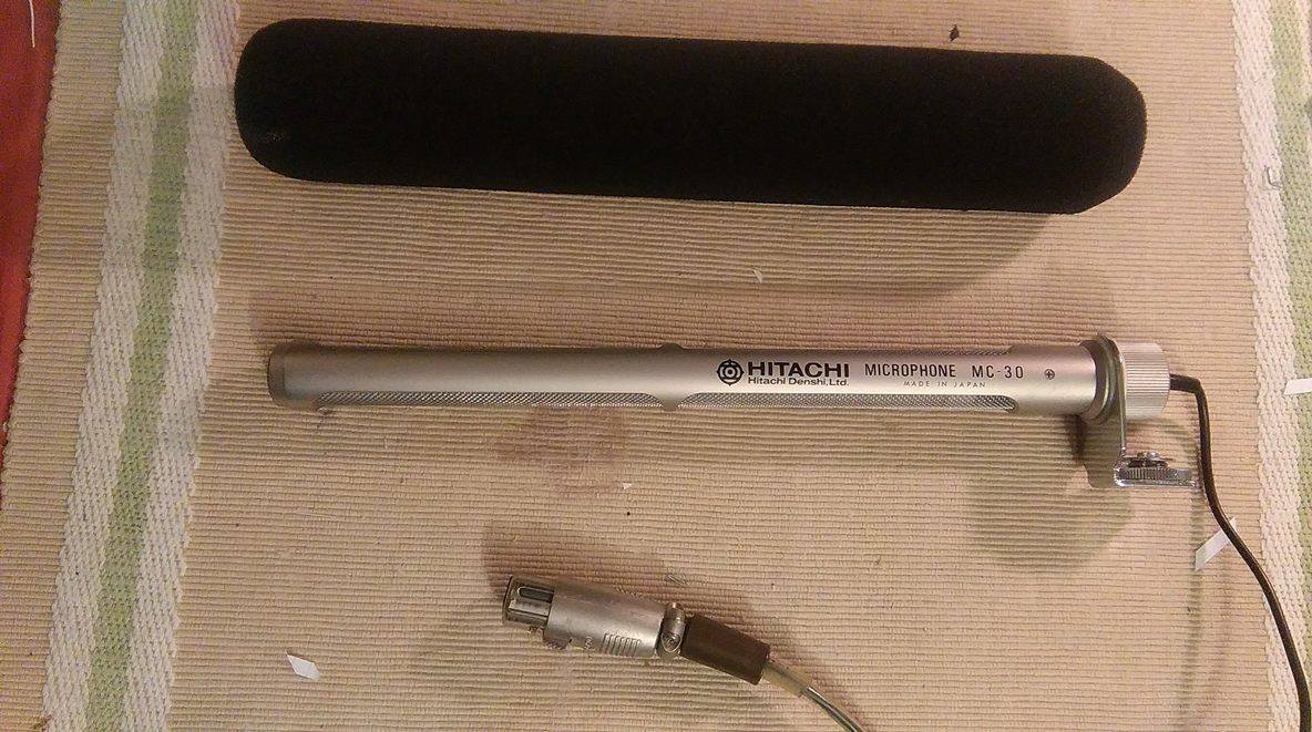

I give up, it's going in the healing box for a few years until I forget it's broken and have another go , the most I can get out of it is a low frequency hum when I touch it.
If it needs phantom power it will have a condenser microphone in it and a PCB with a preamp on it, the fact it had a jack plug suggests its not powered, how many wires, if it has 3 it will be balanced, test the mic with a meter, cable might have had it if it's old, I've had really noisy cable before
